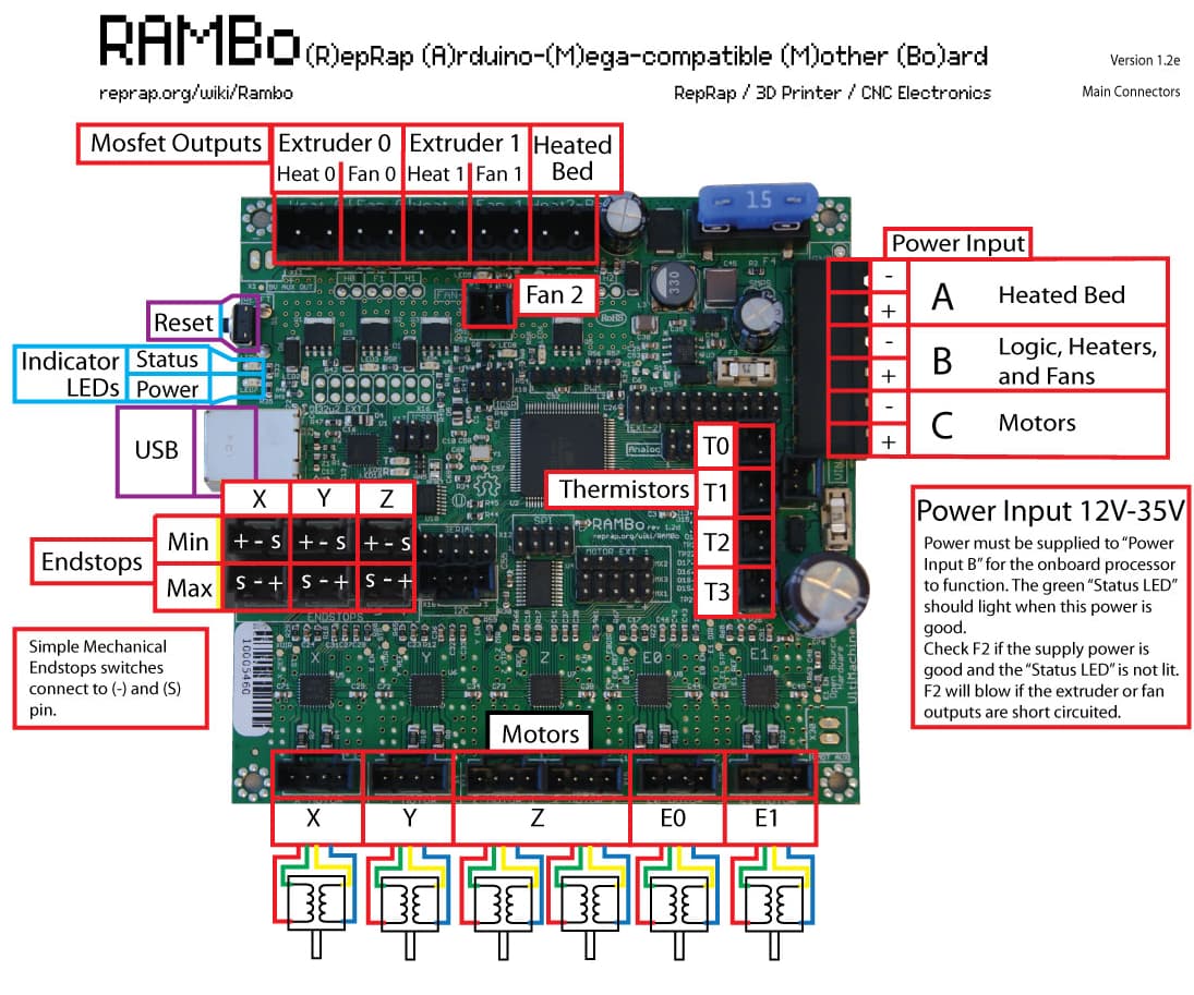

Sorry, I am a noob here. I am back working on the MPCNC Primo and have the Rambo 1.3. I am trying to figure out the correct wiring and polarity for this board. Do I have to put different firmware on the board as well and how do I tell what I have in the first place as I bought this project used?

Sorry, this may be a silly question but I have 4 mechnical endstops hooked up on my MPCNC primo. I have them hooked up correctly to the S and - on my Rambo 1.3 board in a normally closed configuration. Now what are you doing with the Z axis for end stops? First of all do you just use one? do you have a picture of where you mount the limit switch? thanks
Ended up going with just the 4 end stops on both the x and y. Wired normally closed and everything checks out with a multimeter at the end of the wire where it plugs into the board but the end stops do not seem to do anything? what am I missing?
Well, some more progress today. the x and y end stops are working.
