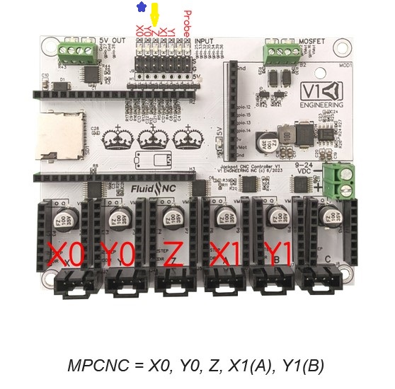

Just want to verify that there is no Z axis end stop (just probe to left) to connect to the Jackpot board. TIA -Steve
No, there isn’t, since Z gets set to the top of the workpiece later on anyway, so it does not make sense to home it.
