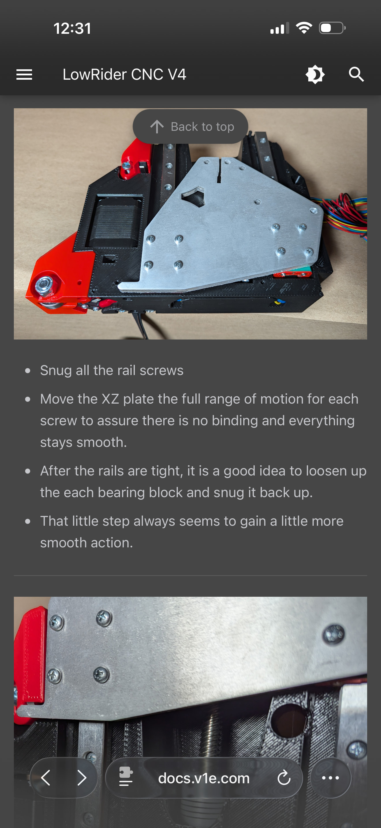

1 -

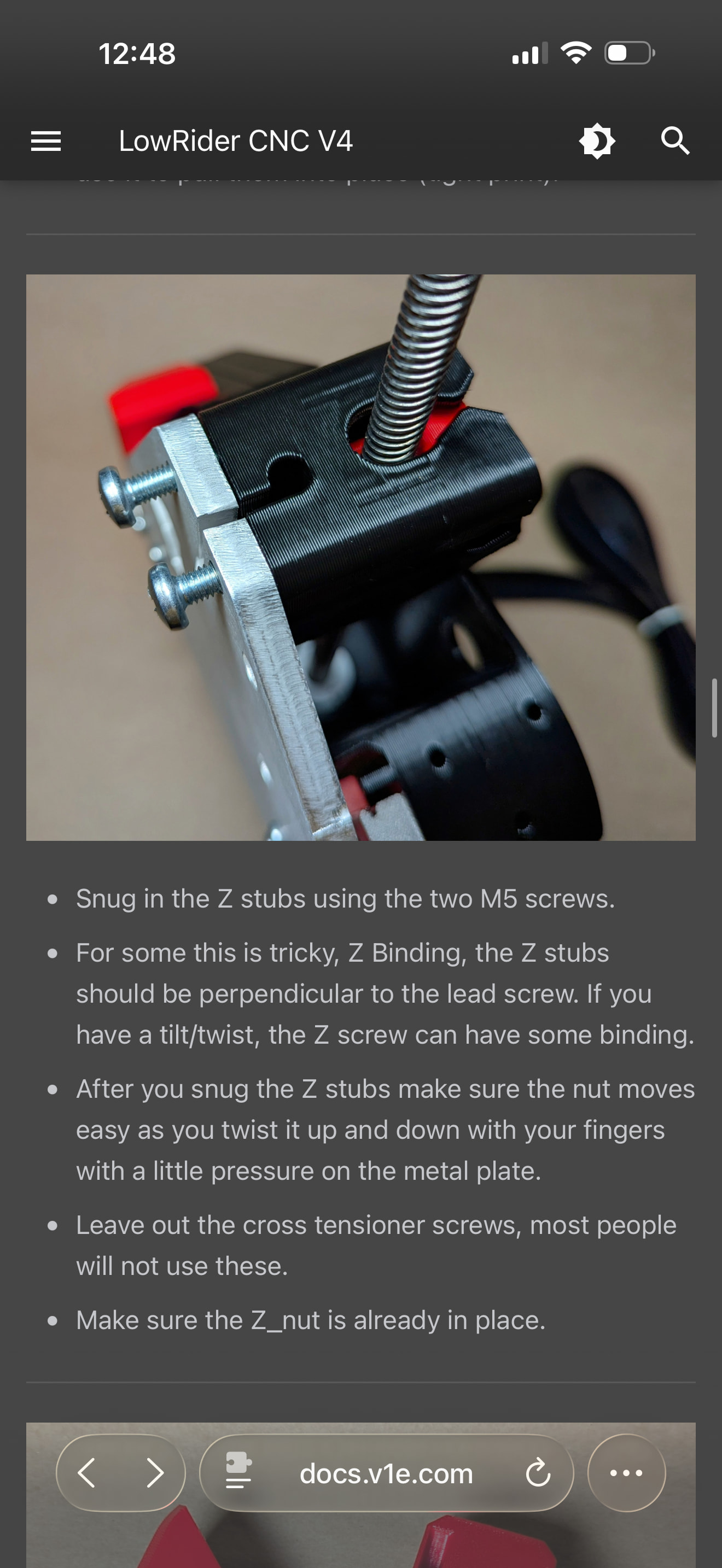

Where this says after the rails are tight, loosen the bearing blocks and snug them back up - does this just mean loosen the aluminum plate from the bearing blocks and tighten the plate back up?
2 -

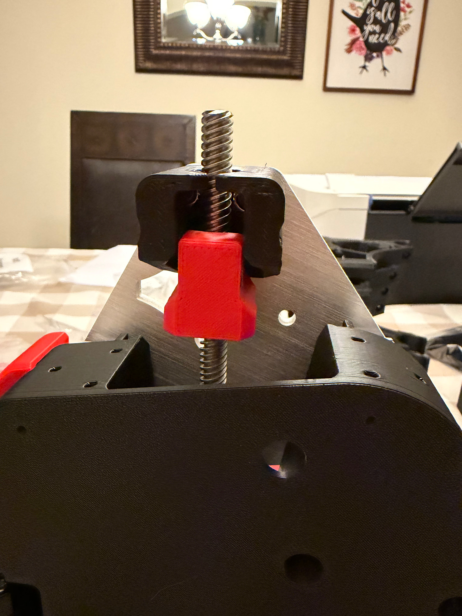

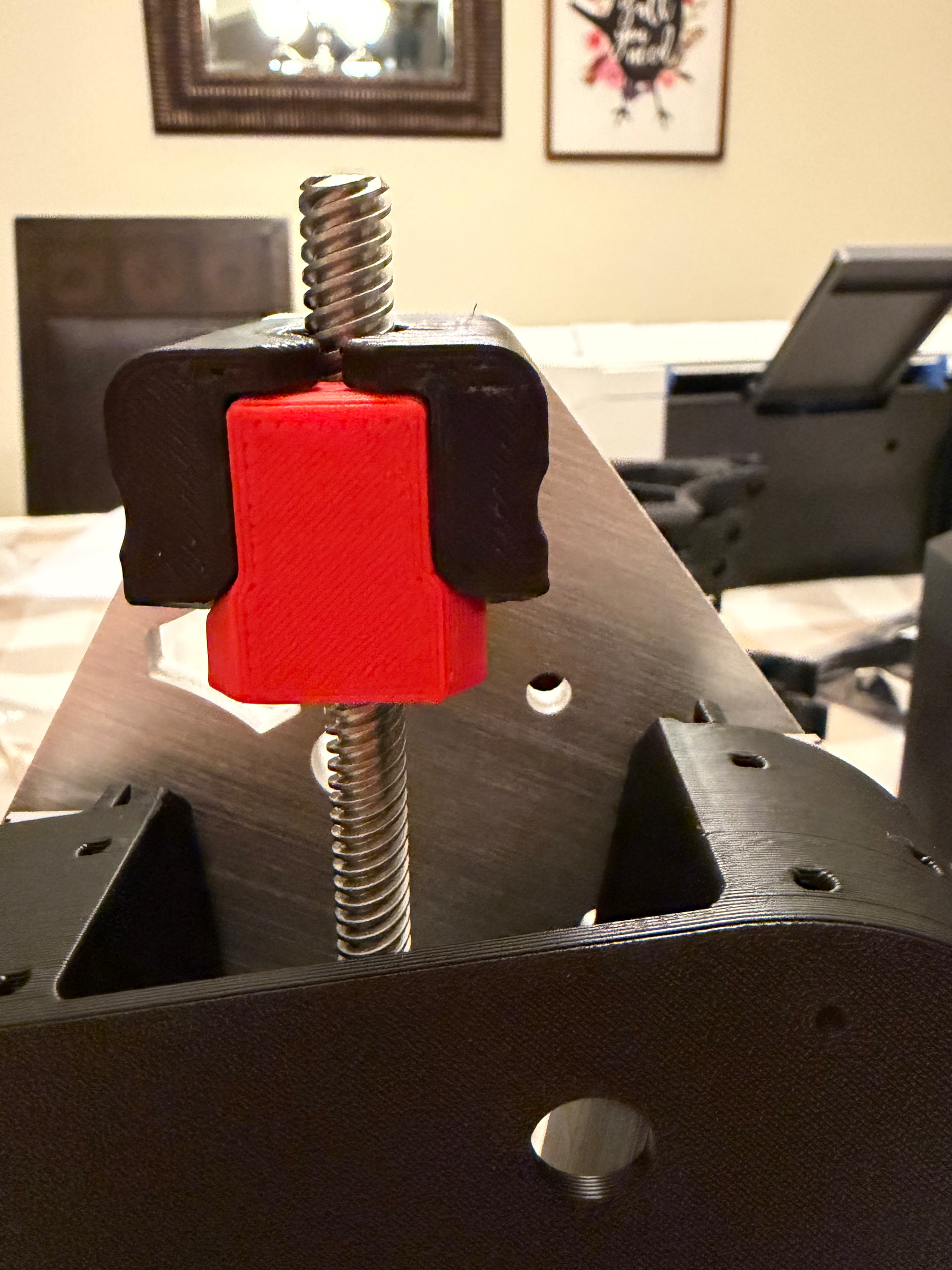

Where this says “after you snug the Z stubs make sure the nut moves easy…” — I can twist the Z screw by hand and get plate movement, but the Z nut doesn’t stay in the “pocket” of the Z stubs. Based on fit, I assume it is supposed to. Is this what the cross tensioner screws mentioned are supposed to prevent? If so, what/how do I do that? I have a couple pics of my current build of this step:
3 - As shown, my Z stubs are black. However, in my order, there seem to be 2 red printed parts that look just like them - did I receive 2 extra Z stubs by mistake or was I supposed to use the red ones and these black ones are for something else?

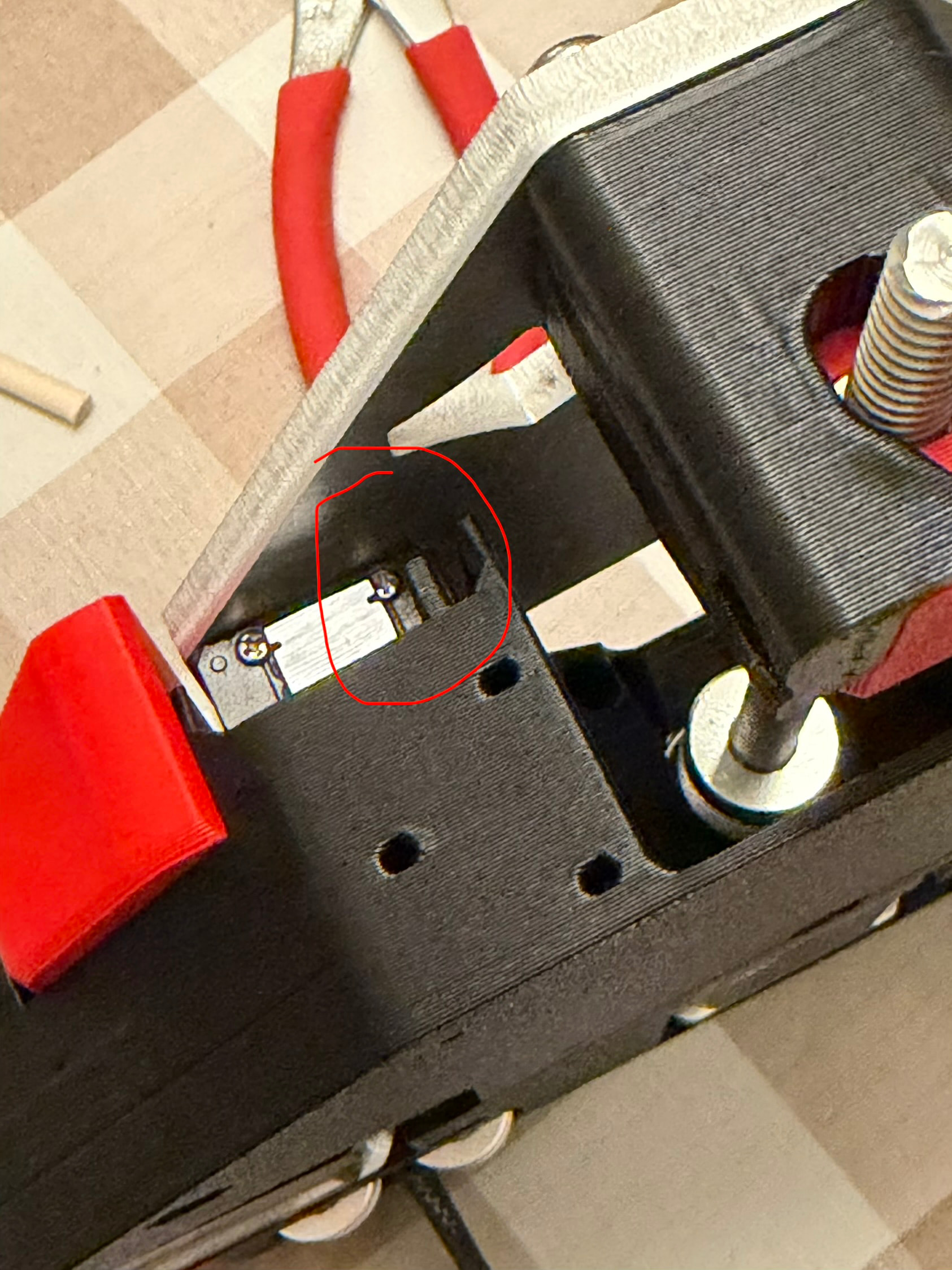

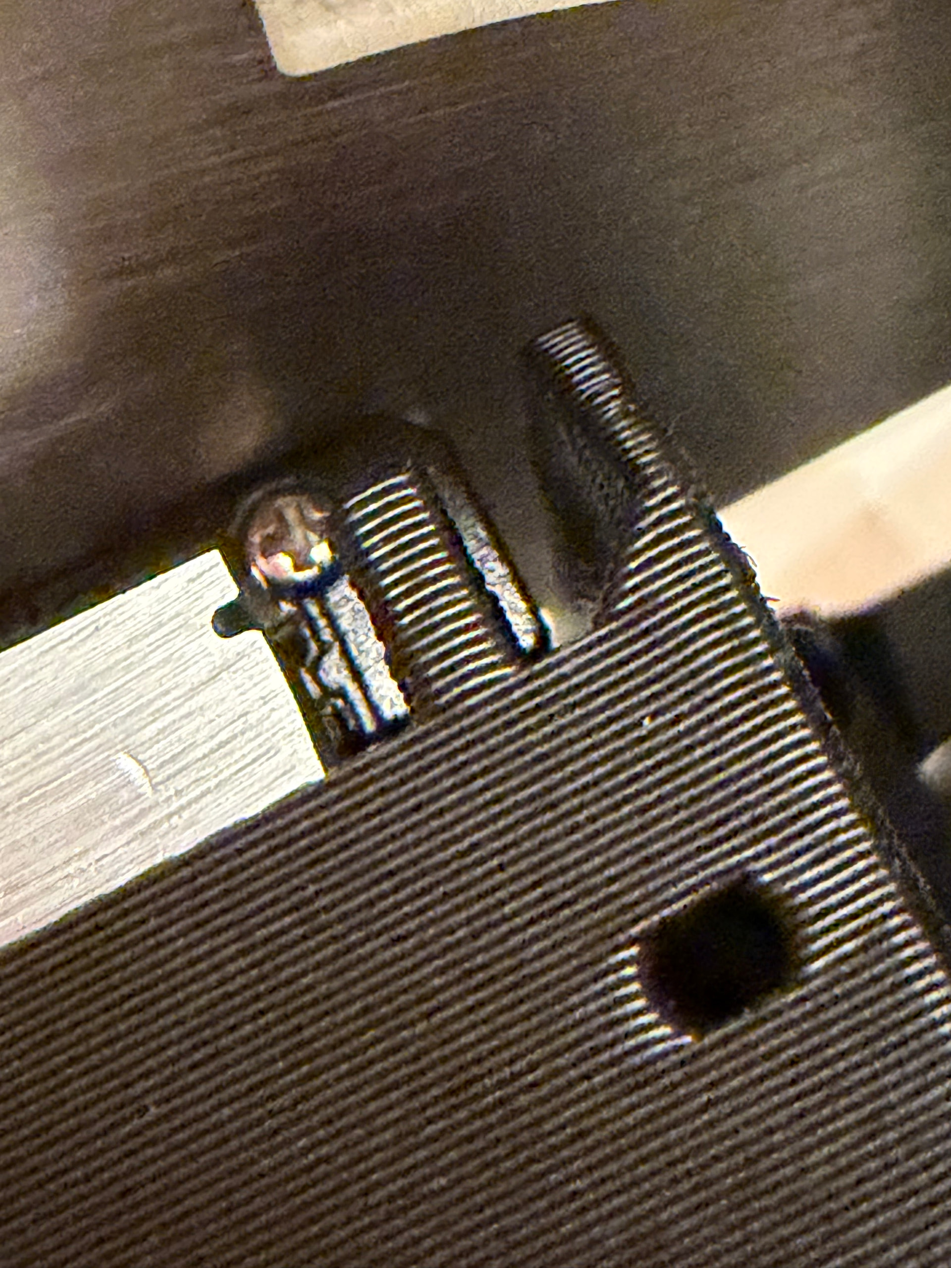

4 -
Both of the printed sides, at the top just above where the rails attach, are these black nubs. Am I correct to assume these are just from the printing of the parts and unimportant? I hope so since one already broke off…

  1. Yes
  2. Yes it should screw up and down very easy. The 2 plastic pieces will mate together once it’s built and rails are on.
  3. I don’t know. I received doubles as well
  4. I don’t know
The bad news is that nub you broke is the physical stopper to keep the blocks from sliding off
The good news, mine have broken for years.
The cross screw, I have mine in place but almost fall out loose. They cause problems when they are too tight and the general guidance is to remove them. Because mine haven’t caused me any issues, I haven’t bothered taking them out. They aren’t need though. If gravity stops working, there are still other contact points that won’t show you too pull the gantry up and off.

3- I am sending out doubles? I need to take a look at that. Sorry for the confusion.
The kit you sent me to take to SMRRF had both red and black copies of those. I think I reported it at the time, but maybe in the rush to prepare I didn’t.
Hmmm, I have to edit one of the sliced batches. I think I will get rid of the black ones to keep a bit of color for those who choose the color sets.

For now, I’ve put screws in the Z stubs to hold them into their pocket - even at this point if I manually turned the Z screws sometimes they’d come out a little. I didn’t even put a nut on them for now - the screws are just there to keep the stub in its pocket. Maybe when everything is done they can’t accidentally come out? I’m still worried I did something wrong on those…

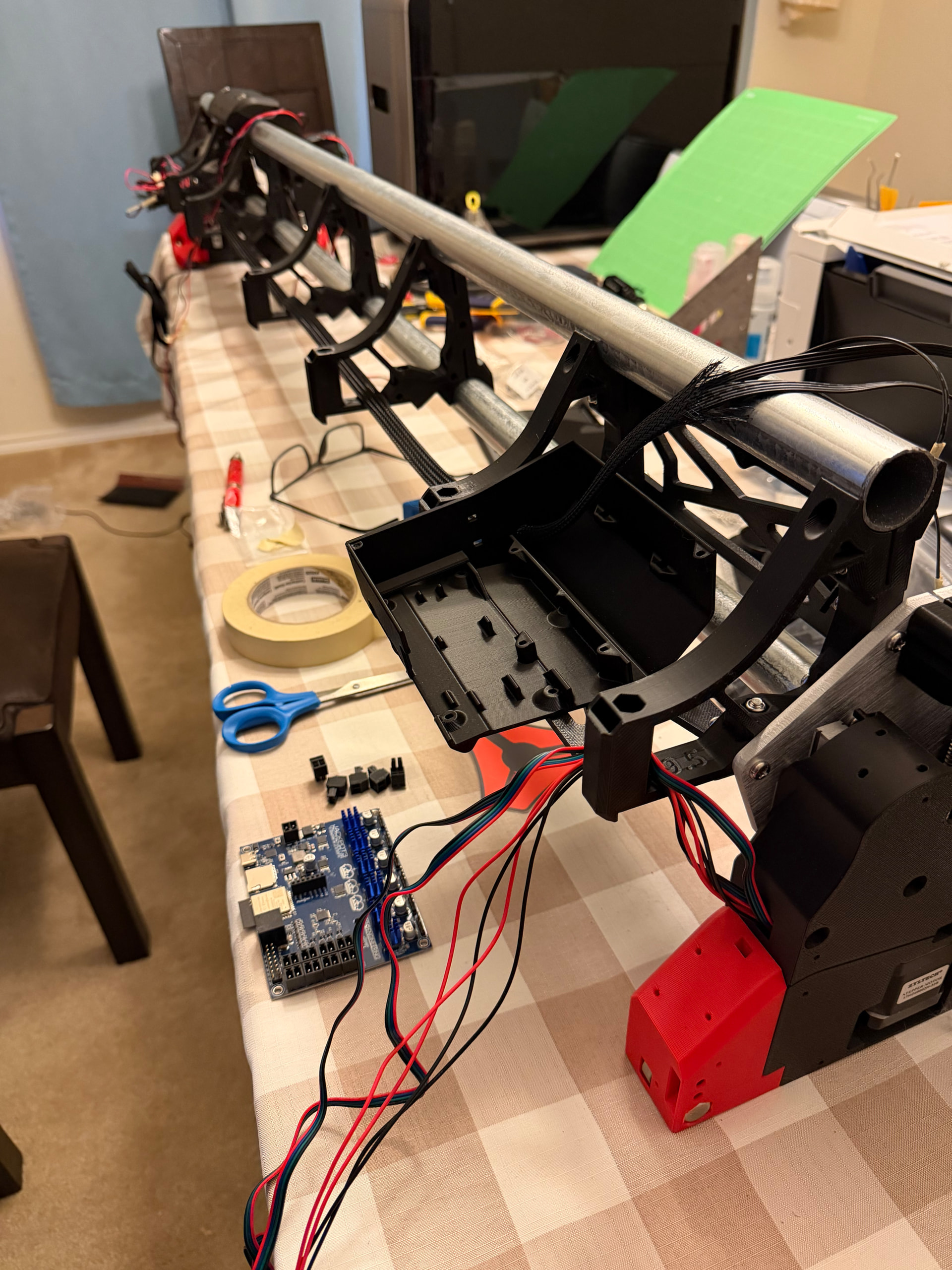

I’m on to wiring. It looks like a mess right now, but I’ll clean it up when I get it connected. My current questions are on the Jackpot3 and I feel dumb.

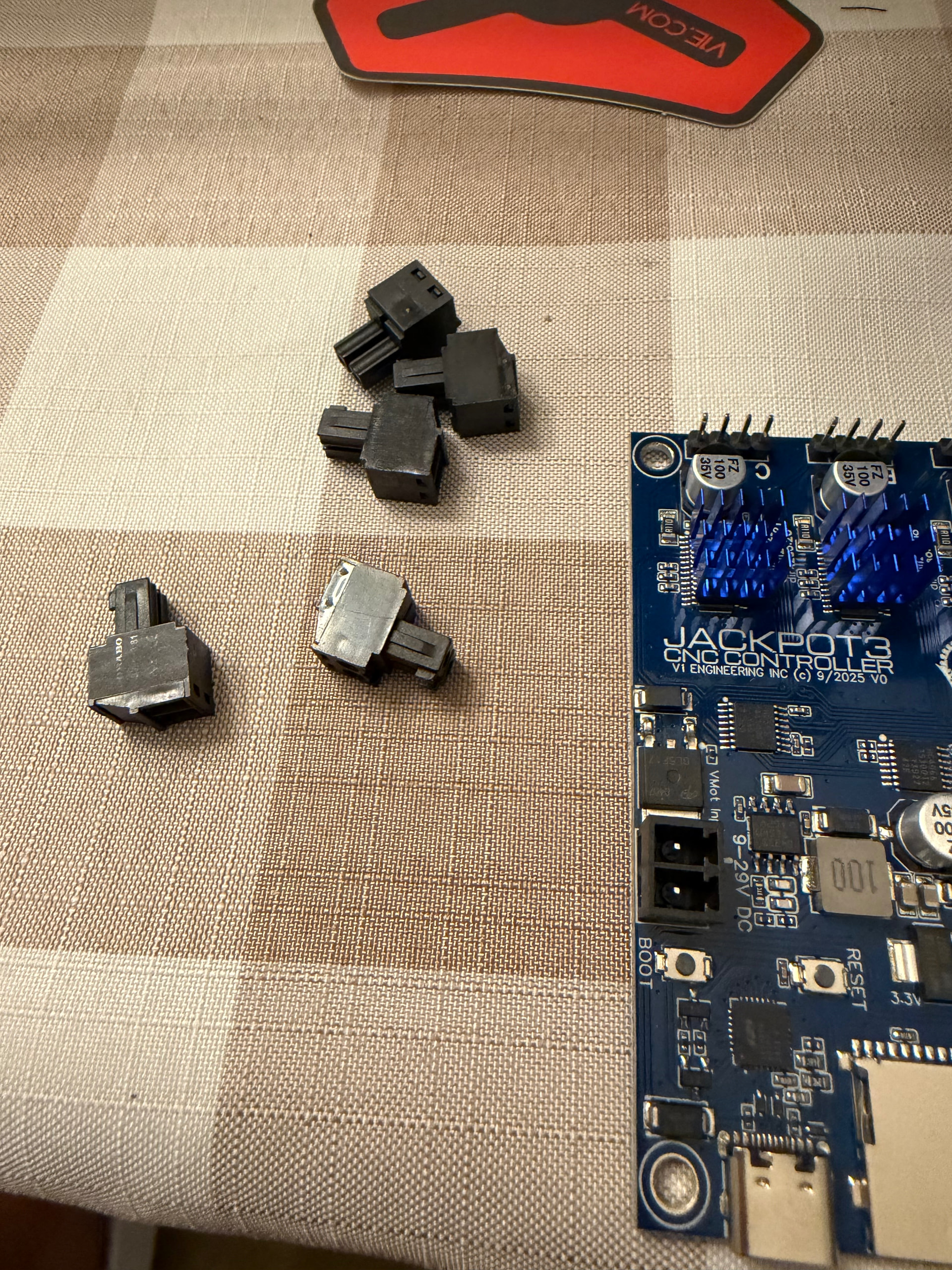

1 -
What are these for? I see where they fit into the outputs on the right side of the board - do I just plug them into the appropriate column (I assume the 24v since I think that’s the power bank that shipped with my order)?

They are for the outputs, as you suspect.
You select the output to used based on what type of signal the accessory needs, not based on what inlet power you have.
Just remember to take them out. Some people make mistakes early on, and using them can stretch your couplers. When you get more familiar and if you feel like you need them for something, you can use them.
1- power input and 4 optional outputs (no need to plug them in if you are not using them).

I actually thought I’d need to cut the barrel connector off, but since it wasn’t mentioned anywhere I knew as soon as I did I’d be wrong. So cut it, wire it to one of those previously mystery connectors, and plug it in. Got it. Don’t use the other 4 unless I need to connect something there.

Other than the power, I have my wiring done. Ordered a vacuum hose from the link on the instructions page, so that’ll go on in a day or two. I ordered 10 ft, but I’m thinking I need more - what is recommended for a full sheet setup?
Disassembled the rest of the LR3 table setup to temporarily use it for the LR4. Hope to get the Y rail and belts done tomorrow.

I got my crimping tool, got the power done. Ordered some more wire sleeves, wiring is done and “ok” looking. Ordered 20 ft vacuum hose from the provided link. Stretched it out, it’s 16 ft at best, but should do the trick. I don’t understand what the instructions mean about grounding it “with the ground port from your power source”. I’m also a little concerned when I manually move the core back and forth on the rails. At the very extremes, I feel a tiny bit of tension caused by the vacuum hose. It’s not because it’s too taught, just a little resistance, particularly at the X maximum. Also, when the core is at the min position, when moving it back towards the max, sometimes the hose ribs rub on each other as it unfurls, causing some tension. Once I get it operating I’ll see how much of a problem these things are.

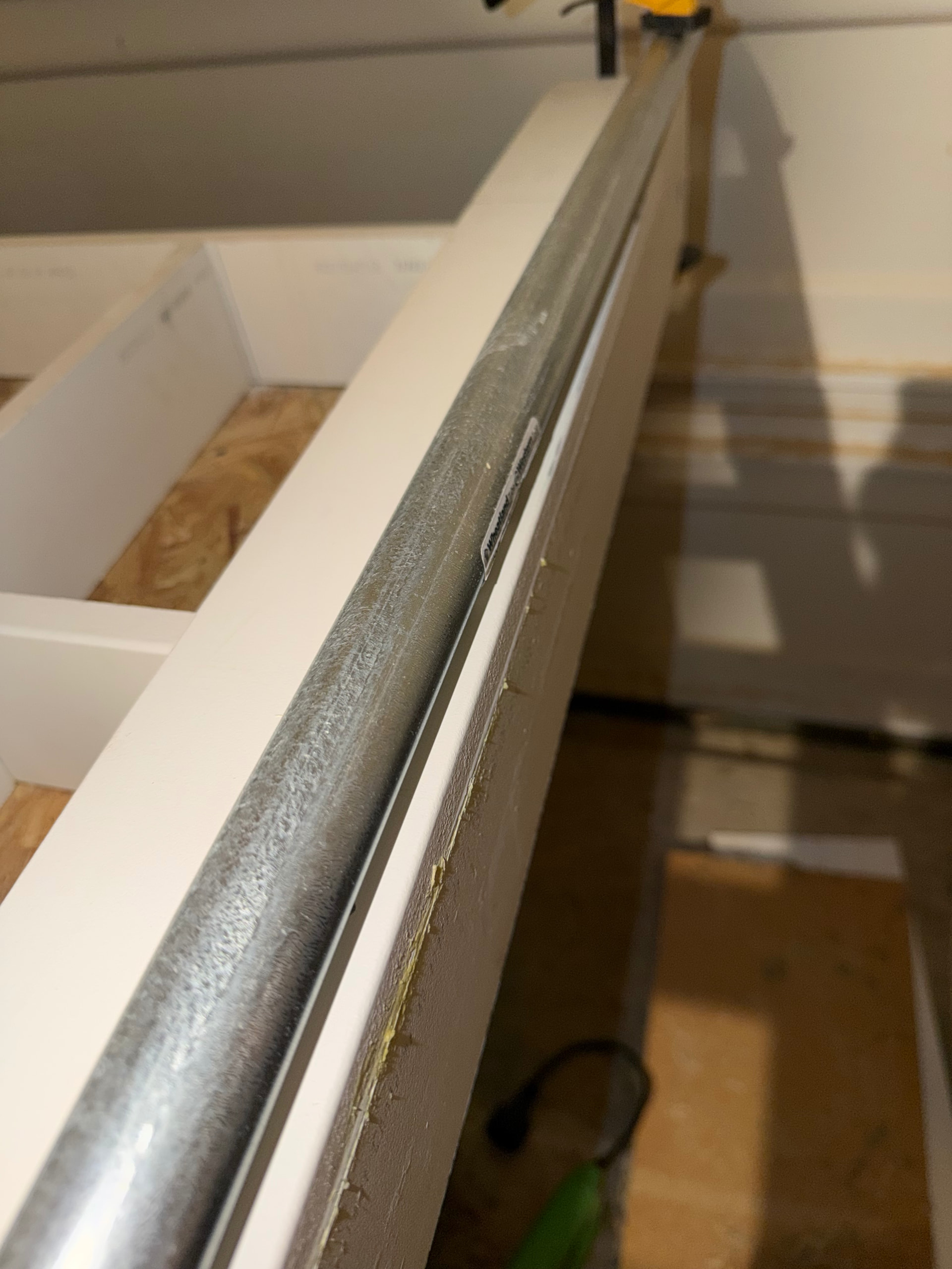

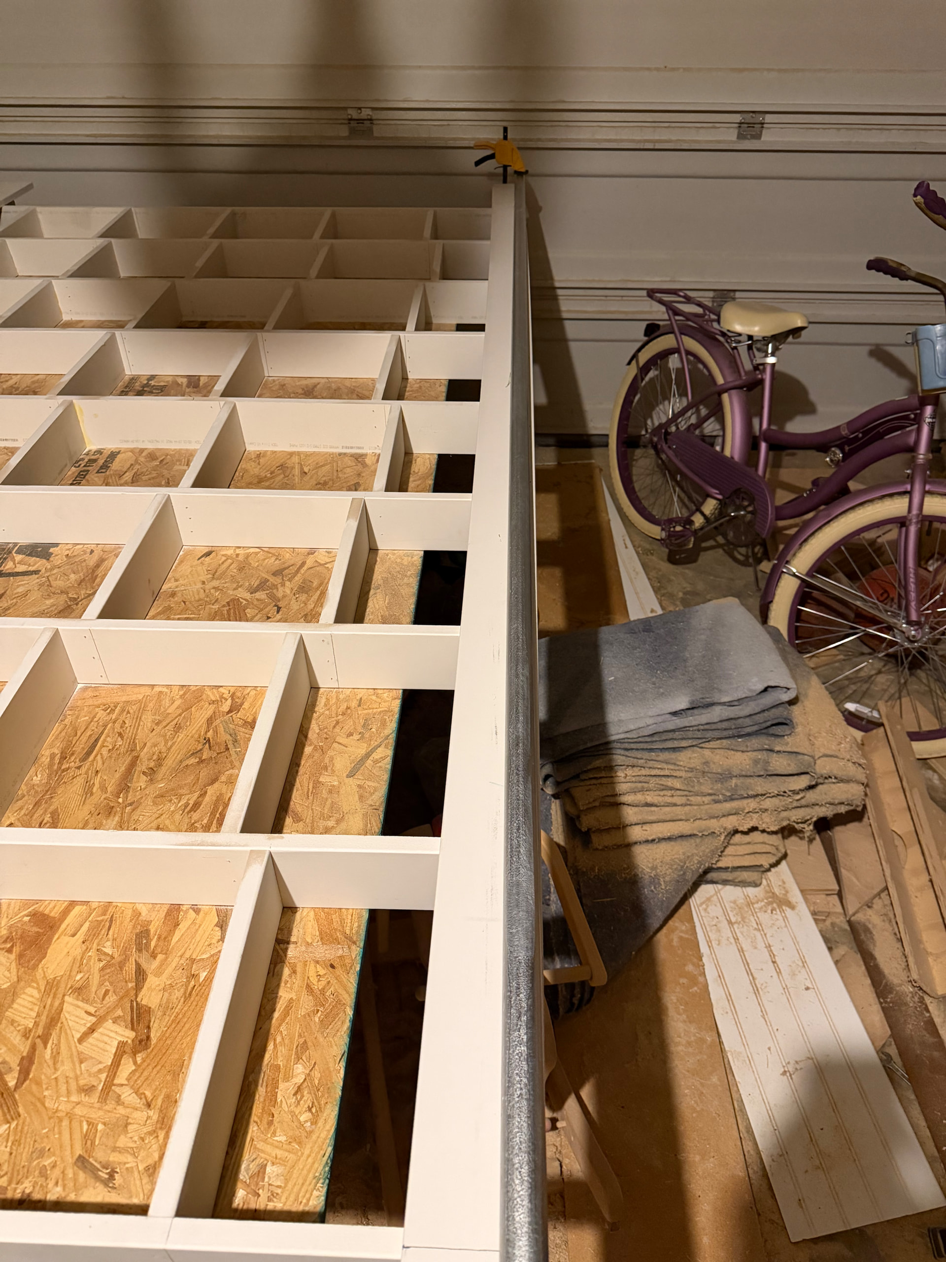

In the meantime, I built the $200 LR4 table to replace something similar I had devised on my own for the previous LR3. Honestly, it didn’t come out that great, but I’m hoping it will be good enough at least in the beginning. It didn’t help that I shot a nail from the brad nailer thru my finger lol. I’ve been a woodworker for 7 years and that’s my first accident.
My new question now - my Y rail seems to not be perfectly straight. I clamped the 1” emt flush with the min and max edge, and you can see about an 1/8” of white showing in the middle portion:
So what’s the best method for mapping out and attaching this rail and its holders to ensure the straightest line possible? I feel if I put the Y min belt holder aligned with the right edge, and follow along the right edge, I won’t end up with a straight parallel-to-table rail, but I’m kind of at a loss for how to approach this. Anyway, I’m sure I have more questions but no one wants to read a novel, and you guys have been awesome so far - hopefully you can help me get over the finish line. Thanks!
edit: I mean my Y rail built for the table is apparently not straight, not the actual emt tubing (although who knows maybe it’s not straight too)
Run a string from one end to the other without any interference. It will be straight, and tell you which is wrong
I agree with spsully. A string and a nice ruler make it simple to check each block without touching the string. It gives you a surprisingly accurate rail.
