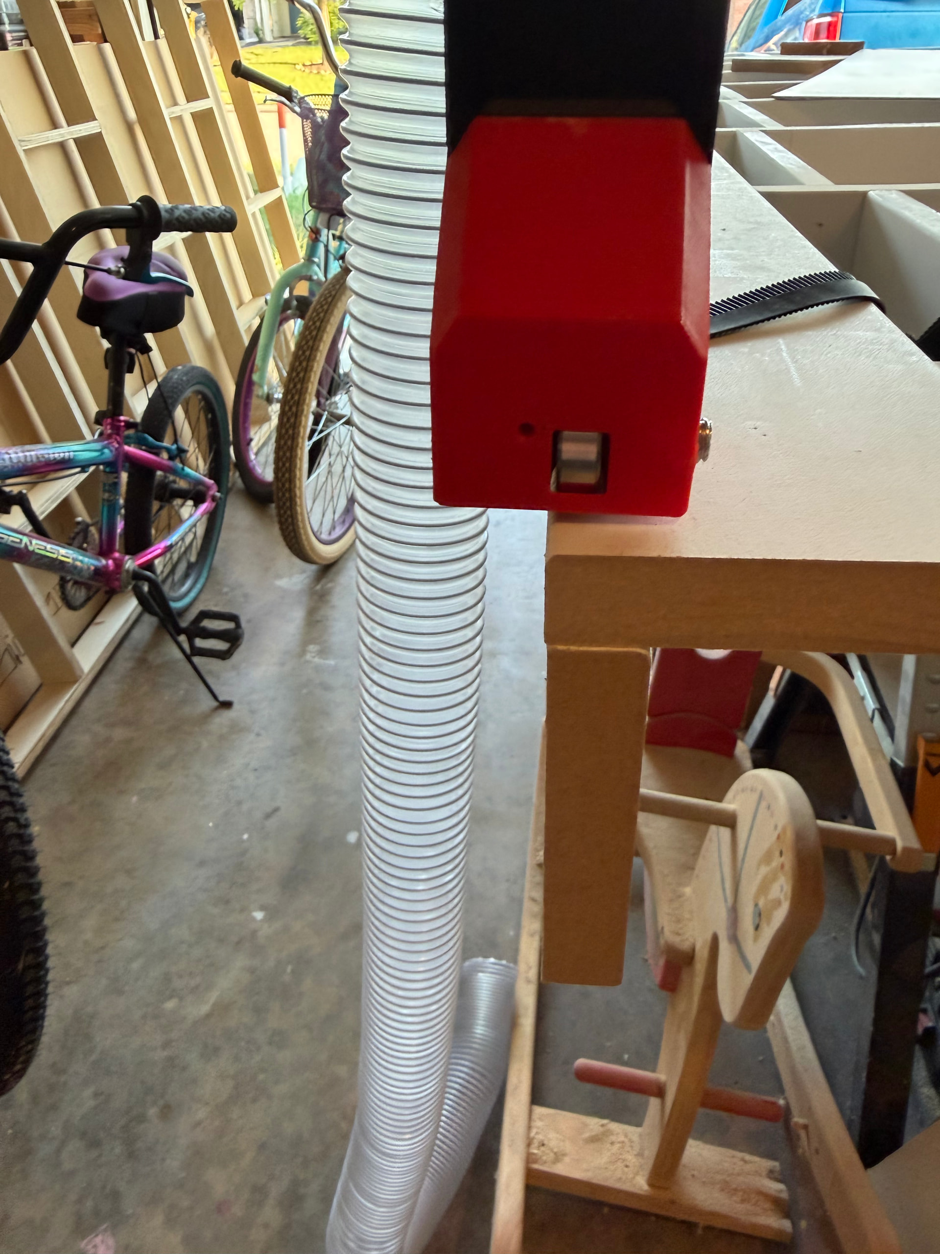

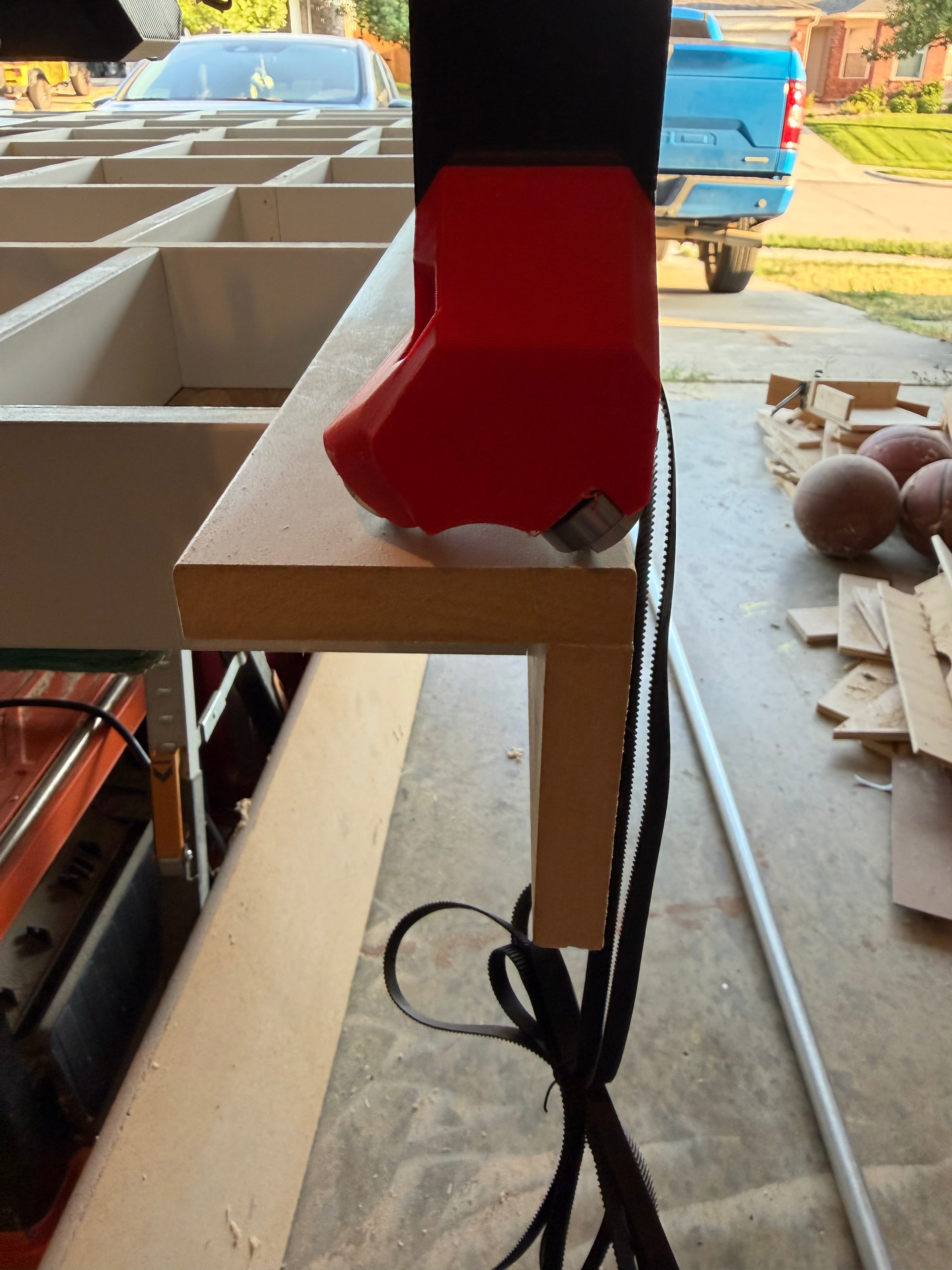

Ok good news, bad news. First, my X spars apparently are not perfectly flush with each other. I haven’t nailed the Y runners into each spar yet, just the min and max ends. By clamping in the middle, I can nail the Y runner into the X spar and reduce the gap down to probably less than 1/16”. I’m still confused on how using a string will help too much - if I pin it at the min and max ends and see that in fact my Y runner is bowed, are you saying just to trace a line along the string and follow that for placing my Y rail?
Anyway, bad news is in my infinite wisdom I guess I cut my X rails (the emt tubing) at usable cutting length of 50” thinking that would give me enough room for a full 48” sheet cut.(actual length is 56 5/8”) When I built the table, I followed the dimensions listed, as I knew it was for a full sheet table. Leaving me with this beauty:
Y max side
Y min side:
So now I either have to do some disassembly so I can cut the X rails down to whatever the calculator says for 48”, or take off the Y min runner and “pad it out” approx an inch or so. I’m a genius :upside_down_face:

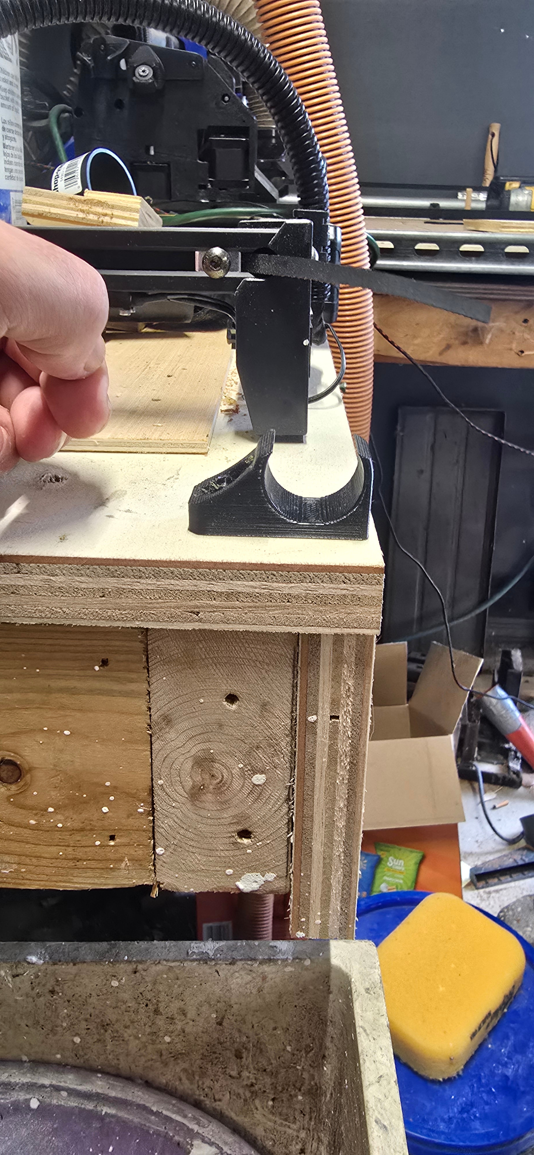

How have you attached your Y rail runners to the table? If they are hard against the side of the table, can you carefully prise them off and re-fix with a 3/4” packer block to effectively making the runners further apart?
@dougb Yeah, they’re only Brad nailed on currently at each end, so that’s what I was thinking - pry them off and put another runner or some blocks to push them out. I’ll get my table stretcher lol. It’s either that or try to take the X rails out without having to undo too much and cut them shorter. Neither solution will be fun, so I’ll figure that out tomorrow
What i meant was that the rail clips can move easier than the table. I don’t have any lr4 brackets but this is one from my lr3 build.
By adding a plywood face to the side of the table, the bracket is now supported and ¾” past the structure of the table. You buy that extra distance in cheap work around.
You COULD do it on both sides, but personally I’d rather do it under the rail so the wheels size still has a uniform surface

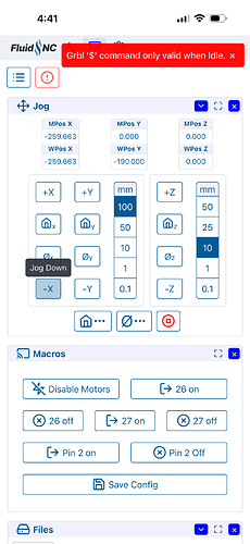

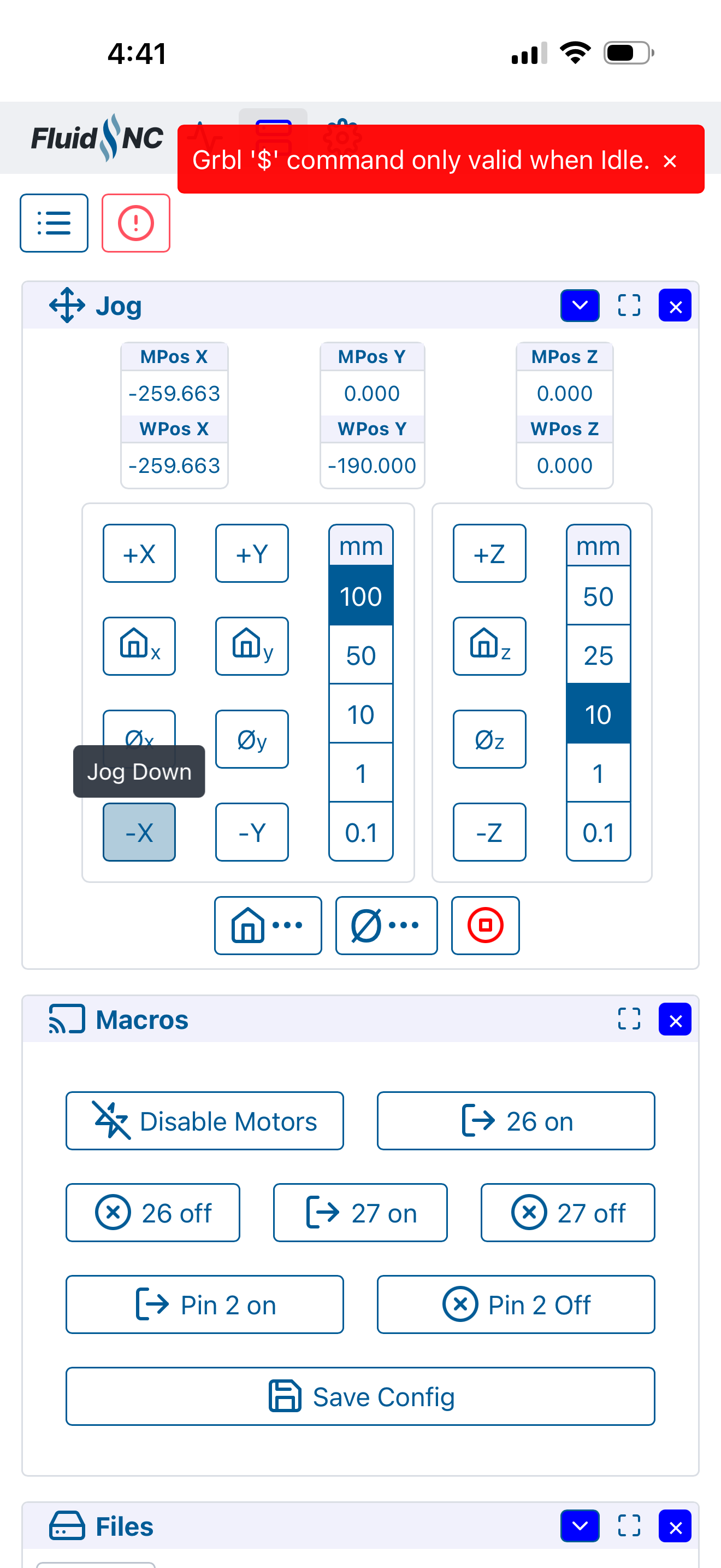

Running thru my calibrations and about to cut strut plates, but after I home, I get this error:
“…command only valid when idle” like it’s still trying to do something even though it seems to be idle. Even if I press the stop button, nothing seems to work other than unplugging the whole thing. I’m sure this is something dumb I’m missing…
I’m also having an issue when trying to save my steps for y and x axis. Default is 50. By my measurements, I need 50.3. When I change the numbers in the config, I click save and the screen insta-refreshes. I reset the board. If I scroll, the numbers reflect my change. However if I refresh the info or turn the board off and back on, the numbers revert to 50. It seems like the save isn’t actually happening.
click the macro button that says “save config”. then power cycle the board.
