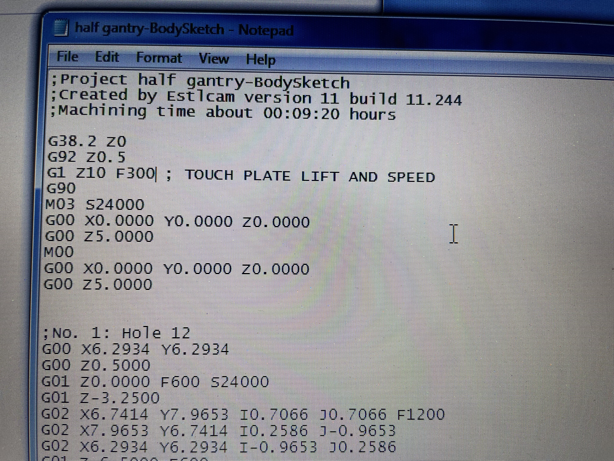

I just learned about the g28 and g38 differences.
Now I was wondering do ppl install two estlcam programs with one dedicated to the mpcnc with its start code preset for z plate.
And then have one for the lr3 with its code preset for z plate ?
Or do ppl just remember and swap the commands ?
I haven’t ever thought of that (amd I only have an lr3 now).
One work around is to put that in a separate file or macro. Then explicitly set up the job with that other file. Then run your generic gcode.

I run the exact same code on my Primo as my LR3.
I only use the probing when I am setting up the workspace, so setting zero is all done before the output from Estlcam starts. My machine is always at X=0, Y=0, Z=5 when I start the program. (Both machines leave the Z at 5mm aftwr using the touch plate.)

I had estlcam setup so it would add the g28 coding on the top. And that seemed to work good for me and my brain.

I gave this a try and it worked very well.
I think I may switch to this method. I recently made a mistake and forgot to configure EstlCam for MPCNC when it had previously been configured for LR3 and it ran the wrong commands. Thankfully it halted instead of crashing. If I can define a common set of commands and move the idiosyncrasies to the startup scripts (OctoPrint in my case) then it should greatly reduce the chance of mistakes.
