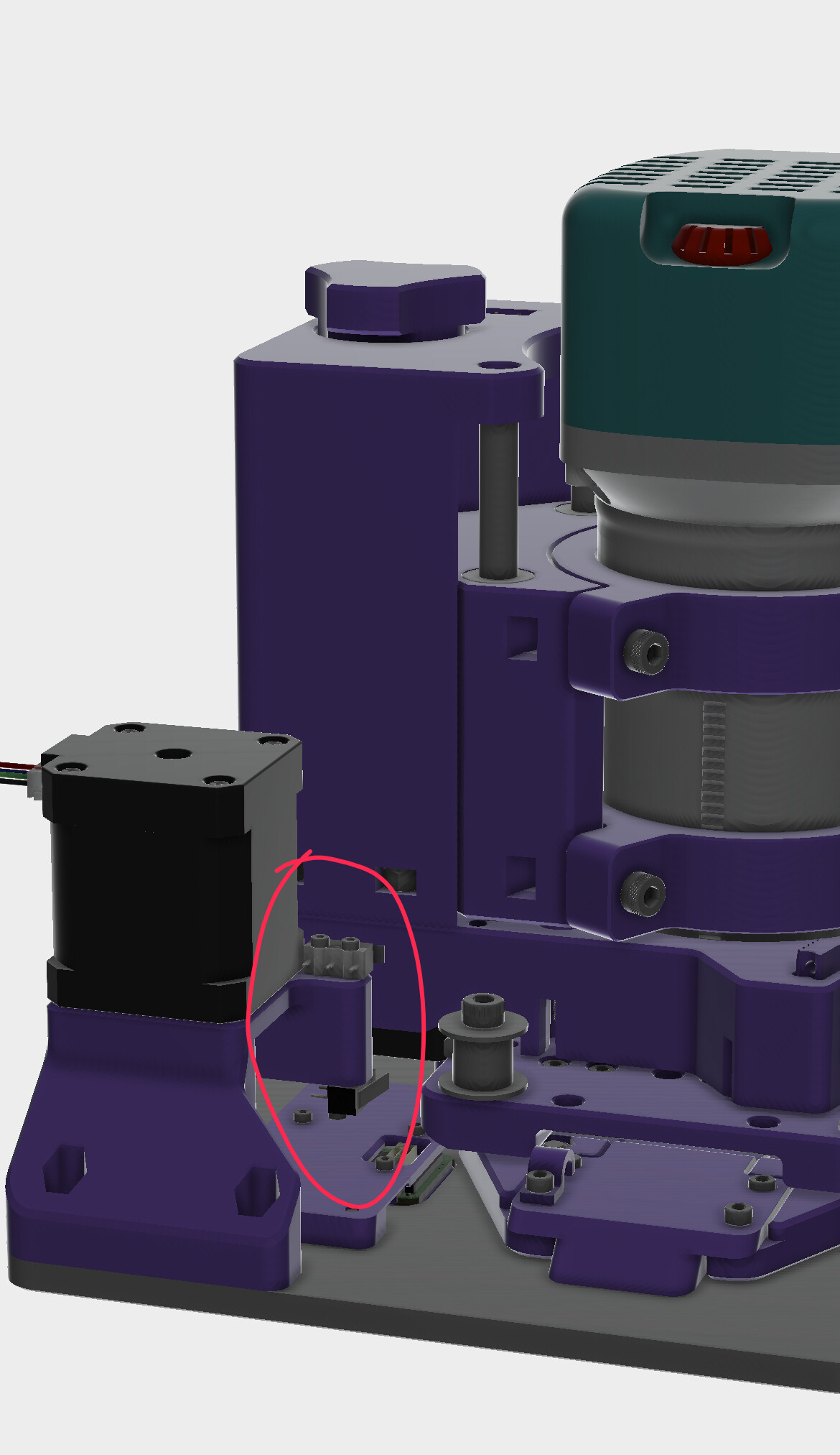

OK, another dumb question - are there X and Y limit sensors? I see them marked on the PCB but don’t see space on the plastic (I see the Z), maybe I’m missing them
The limit switches for X and Y are mounted on the left stepper mount. They can be a bit hard to spot at first glance!
thanks!
I notice the right side is set up for limit switches too, one could add another X-limit there, it wouldn’t need any extra electronics, just wire both X switches in parallel, software would know which one was triggered because it knows which way it is moving.
There’s probably a spot on an idler where we could add a second Y limit
(only asking because I have a bag of a couple of hundred switches in my parts store :slight_smile: )
