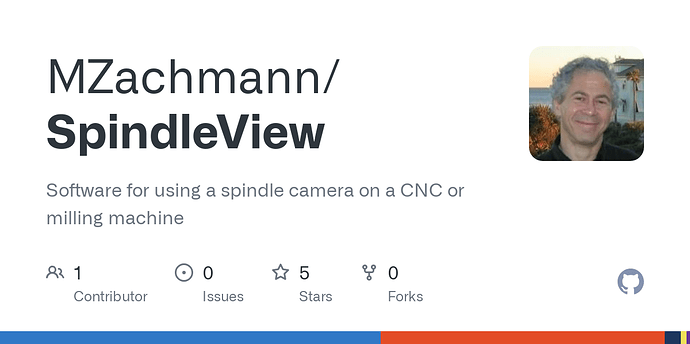

This topic seems like a spindle camera topic. I have a spindle camera… simple and cheap USB cam like this;
https://www.amazon.com/Endoscope-Adjustable-Semi-Rigid-Waterproof-Inspection/dp/B0CZHT2VHS/ref=sr_1_7_sspa?crid=1B52WR4NZKSCO&dib=eyJ2IjoiMSJ9.avyzkgdDXGFDPwinkKoezI_ZaVWxMAO77ffz_eDgPt_OZtXUhzfpaZpMHb_6MxZ2nhtTqfWDcHCKy6LWf_QvGUHbarDyXmJ46QLF1Mq1c12qYJ-vRd4YZziAct6fQAfqwzcEKscU36VTRwH4FtWPdw7c1lS11vc4FNTIEtcClFJR-_JMVIZQtGVU2sHo74_YLMrvfMPIE3ib1dLqMmdEKUMGPOea4NQt8kwbdVORC6U.QlWDPJTSf73eBglhTKdVXULkbnnkEq1xoOkd_FP4F7k&dib_tag=se&keywords=usb%2Bendoscope%2Bcamera&qid=1753925169&sprefix=usb%2Bendoscope%2Bcamera%2Caps%2C253&sr=8-7-spons&sp_csd=d2lkZ2V0TmFtZT1zcF9tdGY&th=1
(endoscope camera, USB)
These cameras are perfectly suited for edge finding, etc., and crosshairs can also be created with software.
The camera is fixed parallel to the spindle(Router) with blacket, so the offset is fixed.
I can operate a USB camera perfectly with a 3rd party plug in on Mach3.
I don’t expect a small PCB board to handle the information and offset values of a camera with sufficient resolution.
For various reasons, spindle cameras require very clean, high-resolution images.
Therefore, it’s better to use a high-spec product like a laptop or smartphone for the spindle camera. Unfortunately, I don’t know how to integrate laptop software with the Compass CNC PCB.

Here are some resources for spindle cameras:

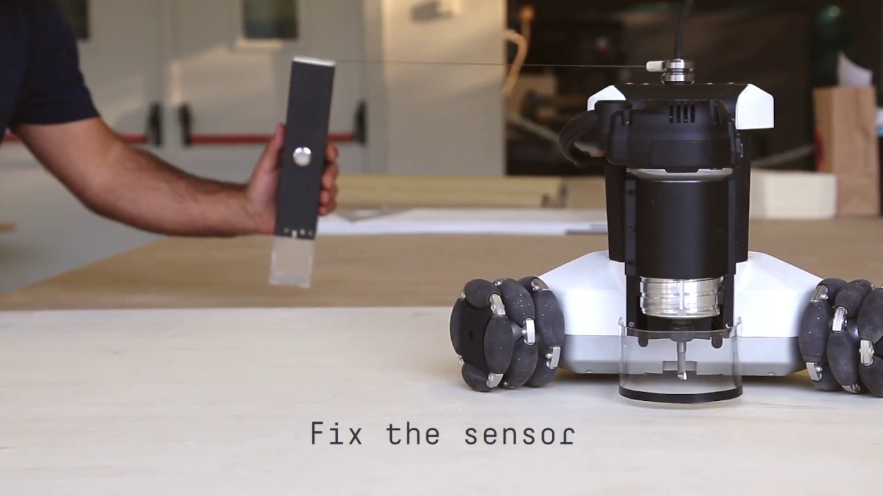

The interesting thing about those strings on the goliath is thay they can give you absolut positioning. That doesn’t have to be great if it could be combined with the very high rate, high resolution optical flow sensors.
This is pretty common in autonomous cars. The inertial sensors and encoders are used for high precision, rapid updates. The GPS is used for absolute positioning despite how slow and low res it is comparatively.
I think the operational requirement for adding string probably makes it more trouble than it’s worth. But it is definitely interesting.
Like those endpoint-towers that have to be positioned at the correct height and so on.
But do you really need the full absolute positioning? I’d guess that the sensor drift of the mouse sensors over bigger areas is the issue. You wouldn’t need full absolute positioning to fight that, just relative without that drift.
So you could take two or three spools of wire mounted to the compass. When you set up you pull out the wire and fix it somewhere convenient, height or exact position doesn’t matter. You then have a rectangular reference jig you move the compass along on once. The firmware knows how big the reference jig is and how the spool lengths changed during the reference movement. It can then calculate distances and angles to the wire endpoints.
I would say so for a lot of use cases, especially with bigger jobs that you want to have a closed path or where you want to be able to cut in multiple passes, or where you’ve got tool changes and features that need to be relatively referenced to one another.
It’s not an absolute requirement for those things, but will make certain workflows much easier, I’d imagine.

I explored the idea of using string potentiometers for positioning when I first started the project, but eventually went with optical flow to make setup easier and cut cost. String potentiometers are kinda crazy expensive (or at least from what I was able to find 2 years ago). I tried making my own with a badge reel and a rotary potentiometer, but it wasn’t amazing. I also couldn’t think of a good way to mount it, but the magnetic mounting to a bearing (?) is pretty clean. Could be a cool thing to explore.
Absolute positioning definitely is a plus, especially for bigger projects. The main hurdle is finding a way to do it simply, without exploding the cost of the machine.
