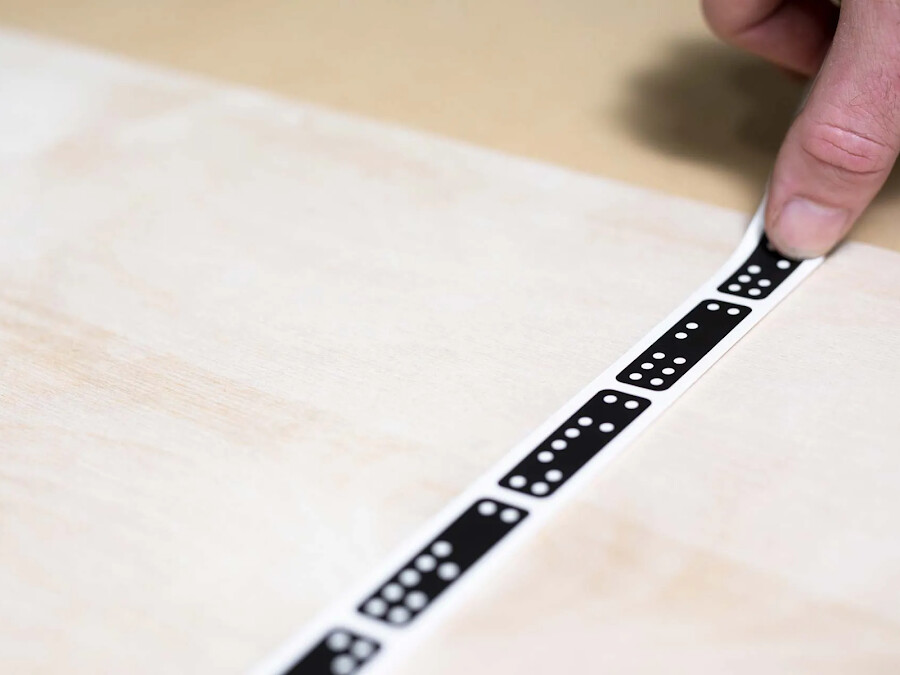

This way we can just use traditional woodworking’s technique with just a ruler; no need for fancy pattern tape. Only problematic on darker woods; but then you can flip the algo to only look a t lighter surfaces and use thin white tape or something.

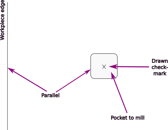

Is one crosshair point enough? I’d say you’d either need two points or one point and a straight line / edge to create a full 2d plane. If you just got one point it might be harder to get the thing you are milling properly oriented to an existing workpiece.
Let’s say you want to mill a pocket into an existing workpiece like this:
You draw a checkmark where you want the center of your pocket, but then you also want to move Compass to the edge of your workpiece and scan the edge, so that your pocket can be properly parallel to the edge.
Is this workpiece edge scanning something that is possible with Compass?

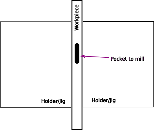

When thinking about this some more I came up with more uses for edge scanning:
You are maybe familiar with biscuit joints (Lamello brand) or domino joints (Festool brand). They both require a dedicated and expensive routing tool to place. It would be nice to be able to use Compass for this.
You would clamp the face side of your plank between two parts of a jig / holder, so that Compass has a flat plane to operate on. Then you would want to scan along the two edges of the workpiece and then set the reference point to the center, with the 2d plane oriented perpendicular to the edges… Then you could mill out the required pocket for the biscuit or domino joint.
Like this:
That’s basically what Cam has shown already, that he clamps it in between to boards on his workbench. :slight_smile:
I don’t think edge finding is needed here, good suggestion though!
In the process of finding the center you actually have two points, making it possible to derive a 2d plane. (Or by doing multiple passes you even have more bounding of the two lines which all aid to finding the center of a thicker line drawn with a ruler)
Ideally the parralism to the edge comes from how straight and perpendicular you draw your crosshair on the material at the desired place and how real world dimensions you make your CAD.
That way you can choose what you want, create the CAD with edges in mind (and making the path for example start off-center) or starting at 0,0 and have the design router at exactly in the middle.
This is the way I currently do it when I make jigs for domino like holes: Just 3D print, align it to the crosshair I drew (dead center of both edges), clamp it down and router using a follower bit or a bushing. Sometimes you want center holes and sometimes you want holes offset from the center for visual purposes.
Yes, this is of course often possible. For example when you use a marking gauge tool like this to mark the line parallel to your edge:
But regardless how big you buy your tools, it is always going to be one size too small for your current project :slightly_smiling_face:
So you end up having to measure multiple points with a ruler and introduce inaccuracies this way.
I think the ability to measure edges would be a nice capability.
Yes, this should be assumed to be known. The tool location in the machine frame is found using limit switches on the machine. There are three limit switches, for X,Y, and Z.
I haven’t though about this before, but yes that should be possible! You could theoretically use the sensors to align with an edge or corner of the workpiece. They are able to detect lift-off (or when they stop getting readings), so they would be able to tell when they move off the workpiece (or when they move back on). There could be a shnazzy little interface to show the sensors’ status so that you could line it up as close to the edge as possible. To go even further, you could theoretically get the camera feed from the sensors so that you can actually see where on the edge you are. That would require a lot of processing power, though.
But yes, I agree that being able to reference edges is a pretty huge feature.

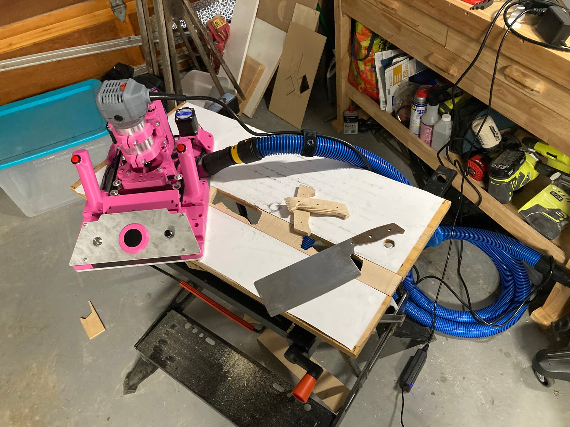

Yuppp, as @Tokoloshe mentioned, I have been using a B&D workmate for this. It’s not perfect (it’s got a bit of slop that sometimes makes the top planes bow if clamped too hard), but it does the trick.

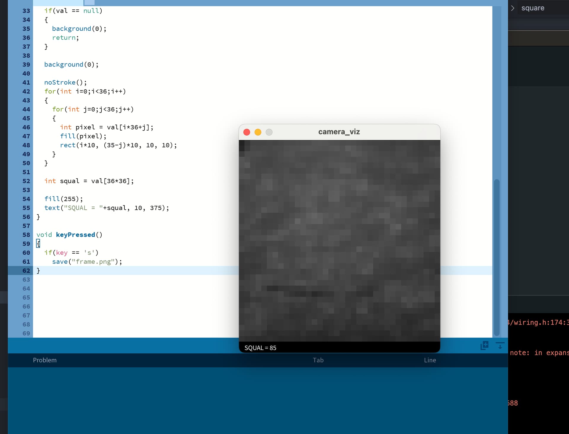

The edge detection would be a feature that you explicitly enable, not something that constantly runs in the background. So the processing power to analyze the camera feed from the sensors would only be required in this moment, and there wouldn’t be any cutting action going on in this moment for example.
Also you wouldn’t have to analyze the camera feed of all sensors at once, but just one or two. You’d move Compass across the edge, so one or two sensors would go from regular motion to lift-off state. You’d then activate the camera feed from exactly these sensors. You then slowly move the Compass back onto the workpiece and this is when you’d grab the edge position from the camera feed.
I haven’t investigated the camera mode in the sensors datasheet in detail. Is it possible to grab one image at the frequency you want or is it a streaming mode where you either get a stream of n images per second or nothing at all? If you have a command to get one image, you’d be able to grab just as many images as the remaining cpu time allows.
That’s a good point.
Yes, totally. Seems like it shouldn’t be an issue. I actually just found a script to run a little camera visualization with Processing. Pretty cool stuff:
This is polling every 50ms, but it could probably go a lot faster.

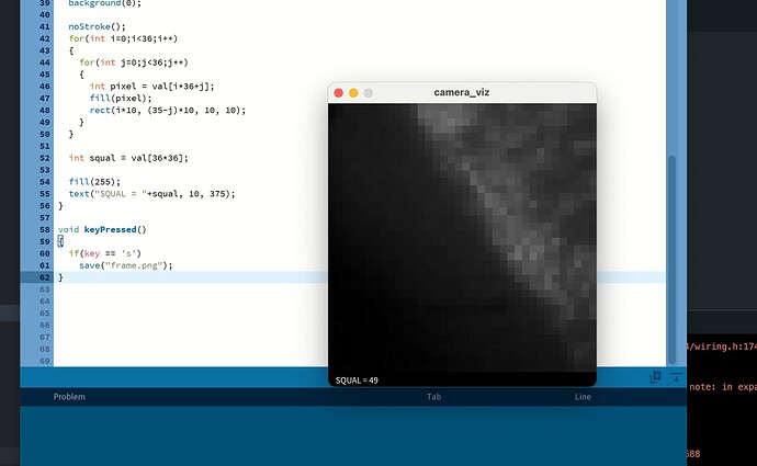

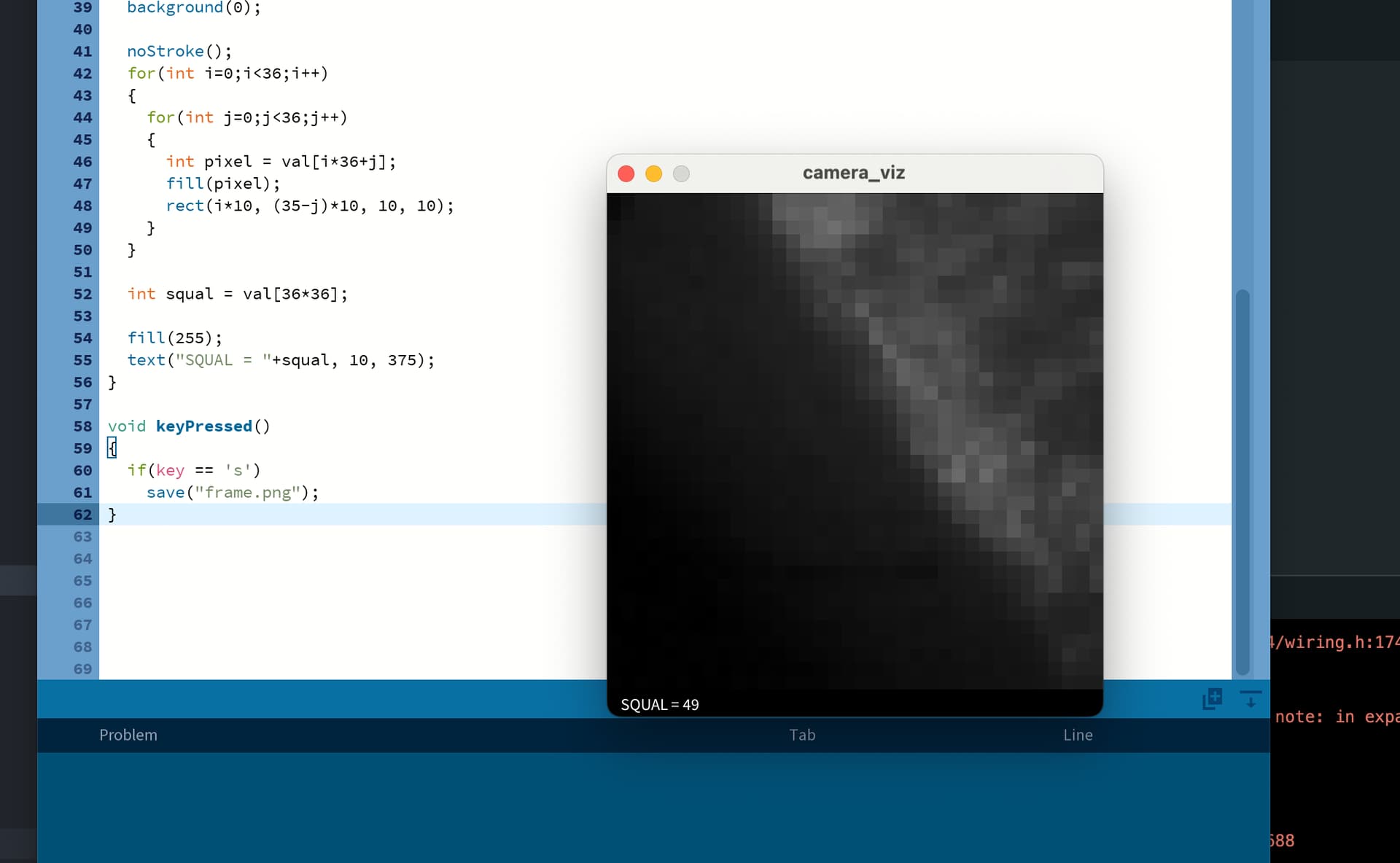

When placed on the edge of my table:
