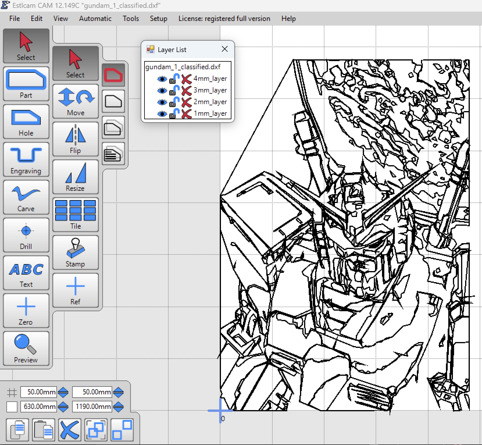

This really helped me with a project I’m working on: doing a carving from an image! Inspired by Trace Bitmap in VCarve, I’ve got a python script that’ll read a jpeg/png and do an unsupervised classification on it. It then converts each class of pixels into polygons, and cleans up all the lil tiny disconnected ones.
Each class is saved as a layer in the DXF (thanks to you guys), and the layers are named after the depth they should be cut…which the script organizes for you based on the number of classes you choose and orders them from darkest/deepest to brightest/shallowest in 1mm increments. Still testing it out, but now that I know how to use the outputs, that should go much better now lol knock on wood. Once I get it going I’ll put it on my GitHub and share it in the right place :slight_smile:
Pics or it didn’t happen:
^they aren’t aligning properly, and I need to play with the number of classes, but not too shabby for first run!
