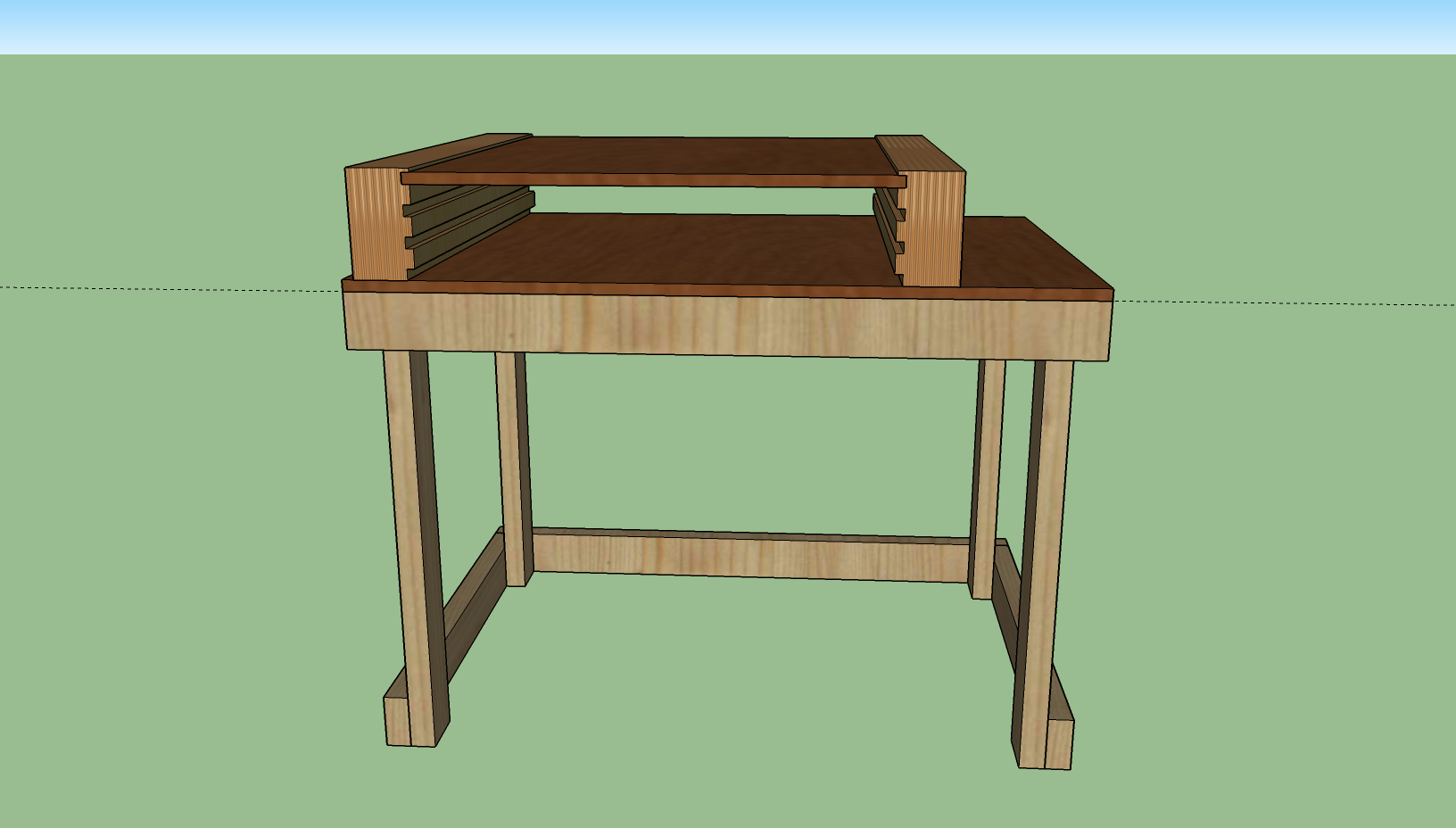

In that topic about minimum Z axis, the poster said his conduit was so short, and the leg pieces were flat against each other. You said it would give a cutting area of 2.75". So, I am thinking I can make the shallowest table depth be 3", and have "shelves" where I can slide it in for different depths. Any thoughts on whether or not I should go with 3" steps for 3", 6", and 9", or use 2" steps for 3", 5", 7", and 9"?
I am thinking a table like shown in the attached picture. I already built my base table, so I would just need to glue up plywood and do some cutting and routing to make the uprights. I figure if the MDF shelf/table bows, I can cut some block supports to put under it, or run something threaded up through the table that I can adjust up under it as feet.
I’m not certain that top 1/4" bit of wood above the 3" position in the photo would last long, so I might have to make the top level flush to the top, and find a way to hold it in place, since the friction of the shelf in the dado would do it on other levels.
