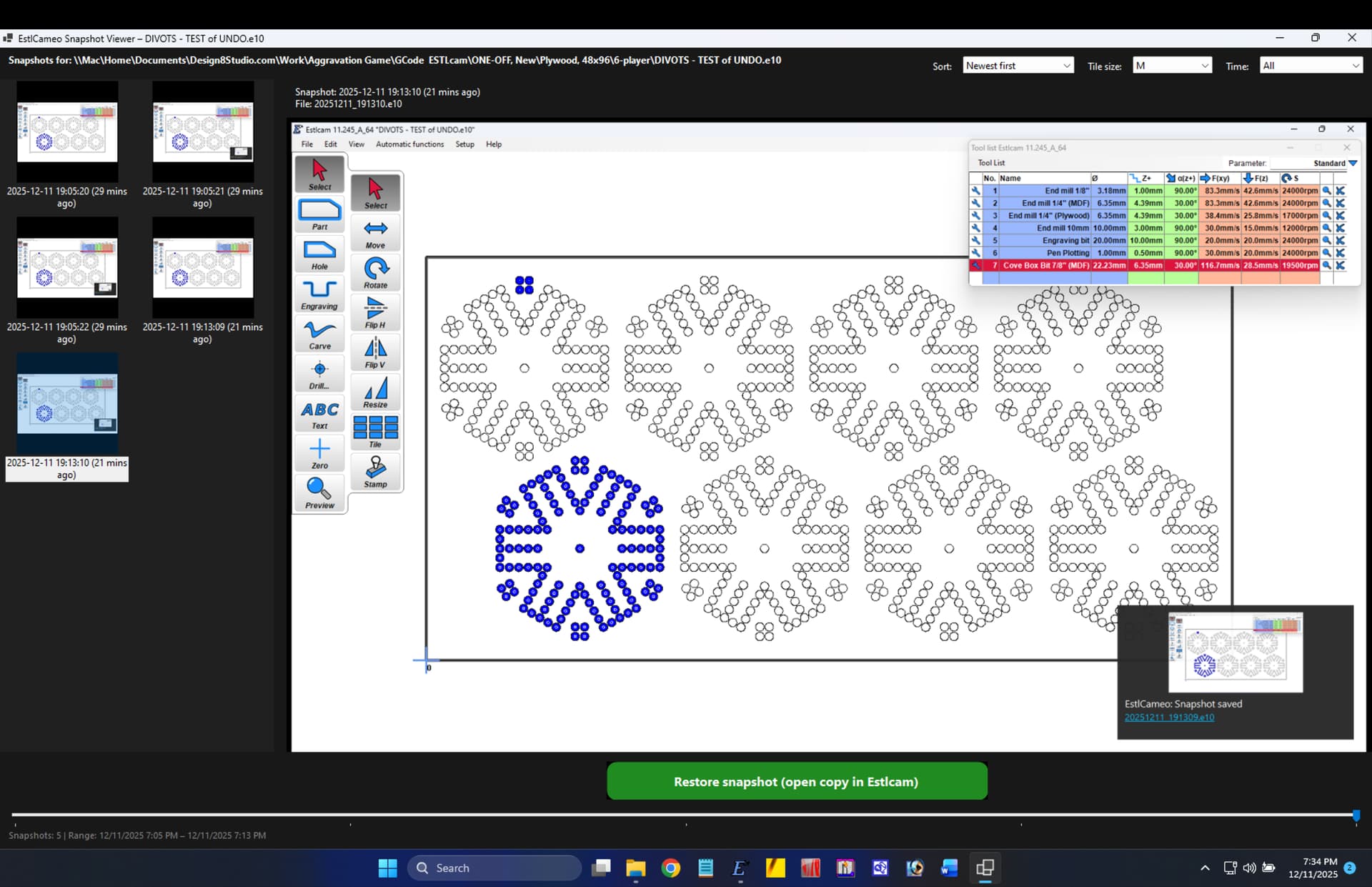

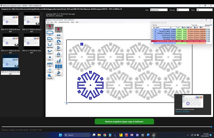

It’s working! You are amazing!

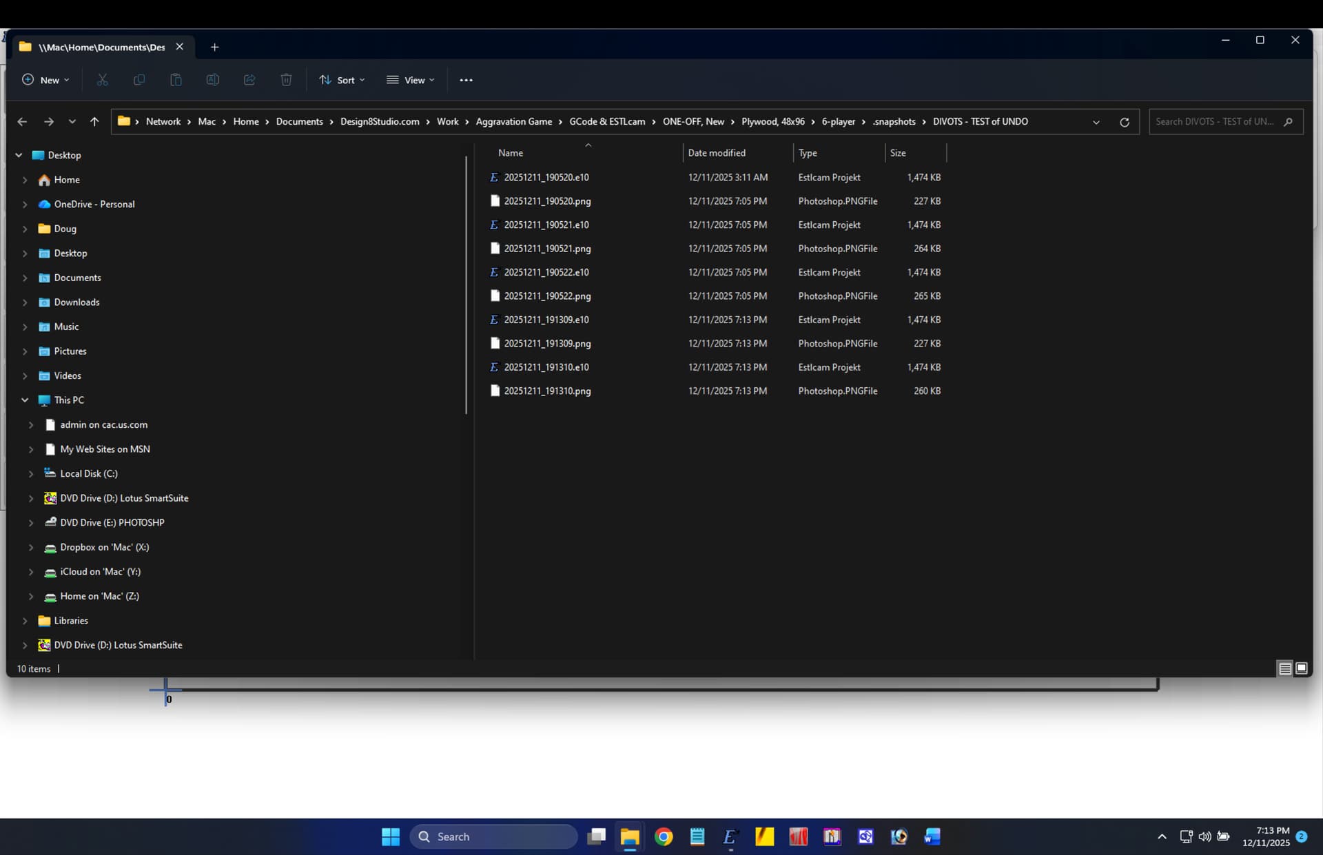

Note: It’s working for me even though I’m running Windows 11 ARM edition inside a virtual machine in a Mac, with my “Windows” Documents folder actually being my Mac documents folder, which is not inside my virtual machine!
ADDED NOTE: On a Mac, any folder starting with “.” (dot) is invisible/hidden unless some step is taken to unhide it, but that’s no problem at all. I can see the snapshots when I look at the project folder from the Windows file explorer.
Thank you! This is so neat.
Also, I used the shell:startup deal to make sure both AutoHokey and ESTLcameo each auto-load at startup of the Windows VM.
Also, just to confirm, I not only verified that it saves the snapshots and to the correct project folder location, but also verified that the Ctrl+R hotkey works, right of the gate. I did not need to do anything in AutoHotkey to get Ctrl+R working.

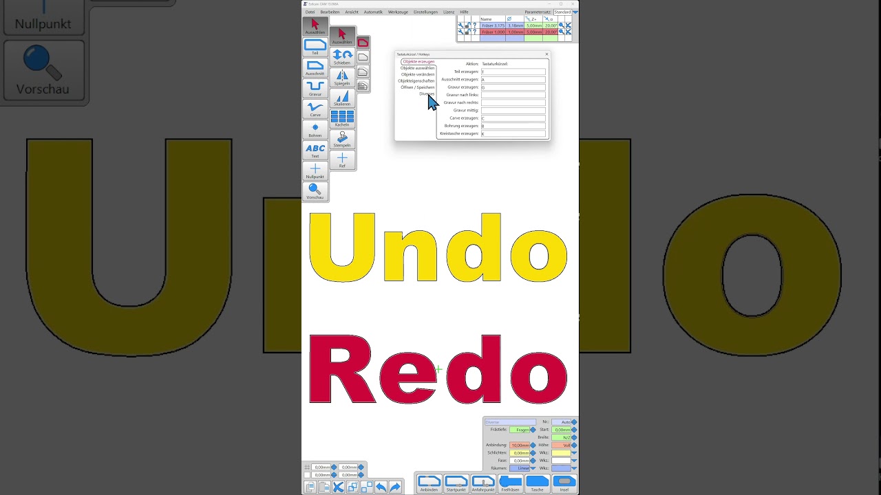

Estlcam now has an undo and redo function:
