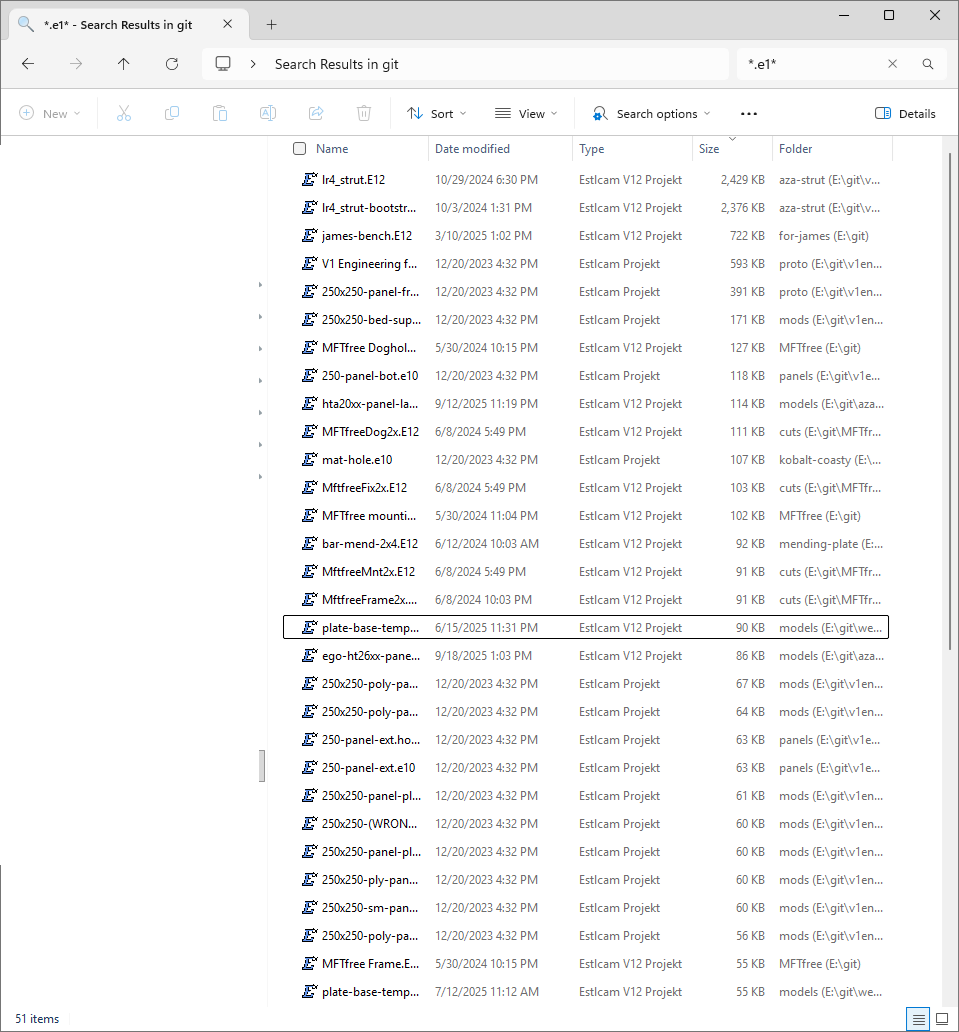

I’ve written a Powershell script before that monitors a specific directory. Any time a file changes (such as when you save it) it makes a copy with a timestamp in the filename.
