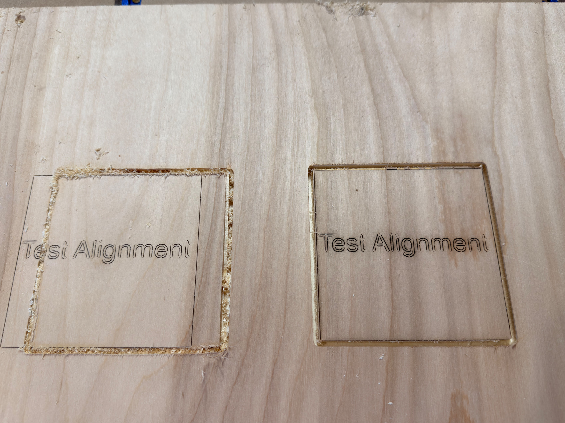

Built a little gcode spliced from Lightburn and MillMage, then run from the SD Card. On the 4th attempt got them pretty lined up. There is a bit of a drifting going on the top of the router cut, maybe I pushed a little hard on the spindle bit?
Overall super happy with the Hydra setup! Now todo one more table squaring and start designing my first true project!

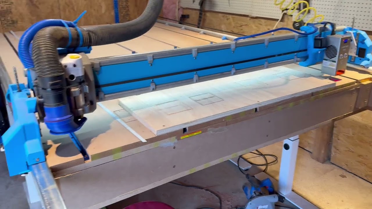

@waimea, I’m not sure if there is a minimum measurement - I mean it needs to fit both cores and be able to move. I effectively lost .5 of the core in the home direction and 1.5 of the core in the opposite direction. I made my gantry by cutting the 10ft conduit in half so I have 5ft total, 1338mm total steps from X Min to A Max. I have about 1170mm of travel in each direction, or 46”. Twice that loss for the work area they share, still around 40”. Acceptable trade offs for me.

Here is my laser mounting and configuration thread. I think we went on very similar paths, assigning tool #’s in FluidNC and then controlling the laser on the A axis. Then figuring out how to have lightburn output to A axis which it doesn’t do natively.
If I were to do it again, I might use a post processor to insert the gcode fragments to do the tool change and replace X with A. Then the CAM doesnt have to know about the A mapping.
I would also watch out for G02 and G03 (arc movements) which will almost certainly not do what you want. The postprocessor should check for that and raise a fault and force me to go back and fix my settings to avoid arcs and use segments instead.
An alternative would be to add IDEX support to fluidnc, but that is maybe more trouble than it’s worth.

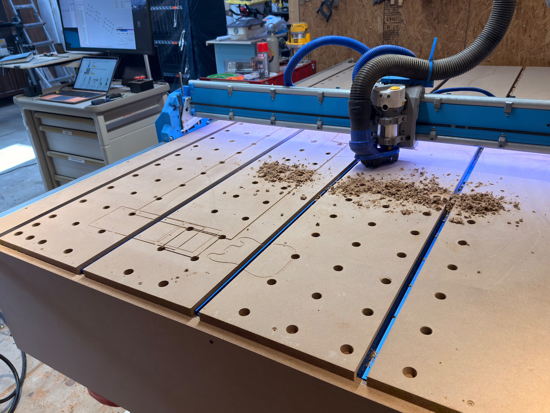

Speed holes, should make this thing at least 10% faster
Where’s the symmetry? The pattern doesn’t match the channels… :scream:
Ha, I was wondering who’s OCD I would pop!

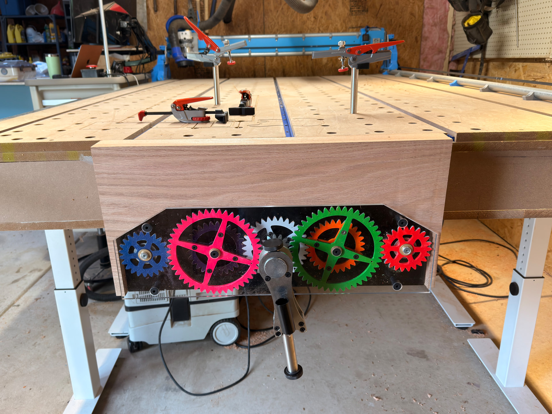

100x100mm pattern, nothing gets in the way of progress. Also I am one of the converted, T track sucks on CNC beds. My next spoil board will not have them.
I am still not sure on that. :smiley: I did like those holes and pegs quite a lot though. :slight_smile:
