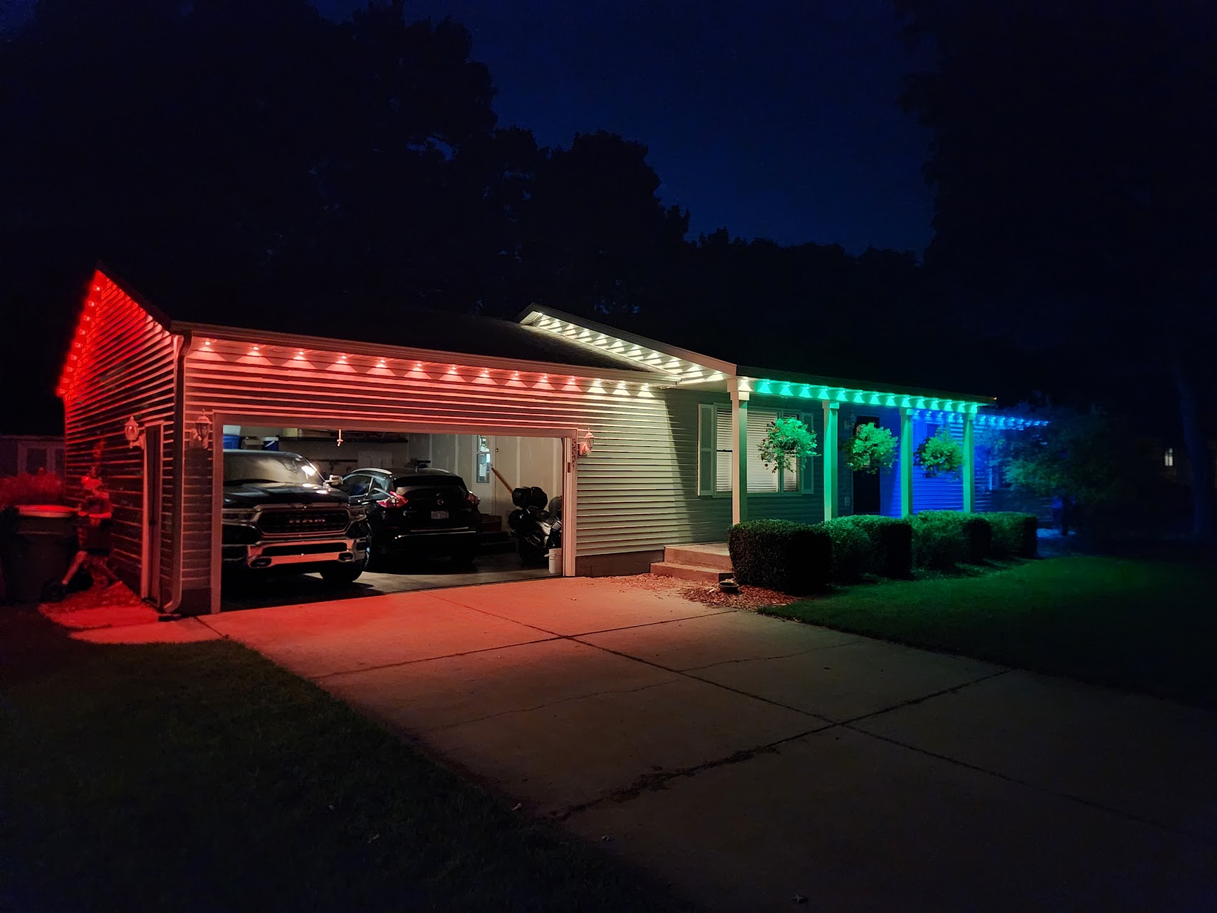

The LEDs I currently have on my house end up looking like the above because of the diffuser.
Here’s the post with the picture of the house

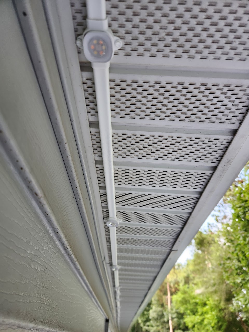

This is the U-channel I used with the diffuser
https://a.co/d/b3GL0uK
And this is the LED strip I used.
https://a.co/d/3exzvYu
They have some I think that have the LEDs even closer together and would make even more of the ‘light bar’ look.

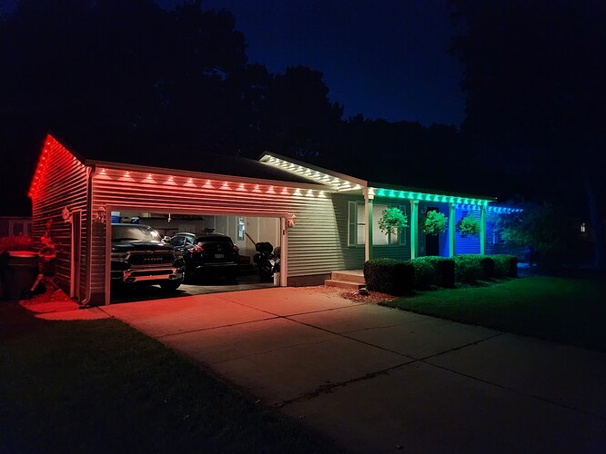

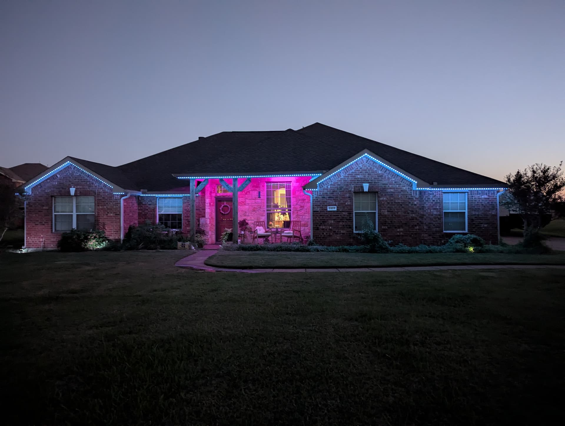

I originally went with some WS2815 strips in the front on the house. They were IP65 versions, even encased in an aluminum channel with a plastic diffuser over top. They looked good for a couple seasons, but the strips would die out or not work very well. Soldering replacement strips on a ladder was no fun and eventually I gave up.

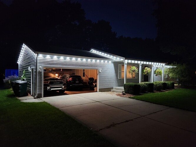

Fast forward to just a few weeks ago. I got a deal on some Govee Permanent Outdoor Pro Lights and decided to give those a go. I’m really happy with how these look.
I did not trust the 3M tape to be enough to hold each light up so I printed brackets for each LED. I also didn’t think I could get the wire to lay flat and consistently to look good. There are pre-made tracks for these, but those are twice as much as what I paid for just the lights. Instead I bought some vinyl undersill trim, cut the nail strip off with a table saw, and slid the wires in there. I modified the bracket model to accommodate the new channels I had created.
The Govee app leaves much to be desired, but it’s fine for now. I can easily make an adapter that plugs inline to make these controllable through WLED. I may do that down the road, but we’ll see how this season goes.

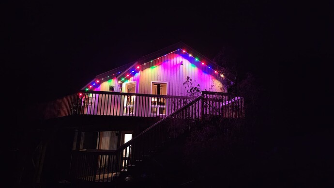

Your post is actually quite hilarious to me. You and I went down the same path and I’m basically just DIY’ing the Govee setup. I do plan on mounting my J-Channel so you can see the pixels poking out under the edge of the eave and not just the light shining on the house.
This is the cheapy set I got at costco. Need to get another set to finish the rest of the way around the house.

The new LEDs are on the house and the old ones are pulled off. No power injection right now except the halfway point. The two wled controllers are set up as DDP so the first controller runs both halves of the house.
I’ll get pictures after dark.
Now to work on rebuilding the power supply I use to run all our blow up ornaments.
Lights. Porch lights are just Kasa bulbs. I was too lazy to turn them off before taking the picture.
