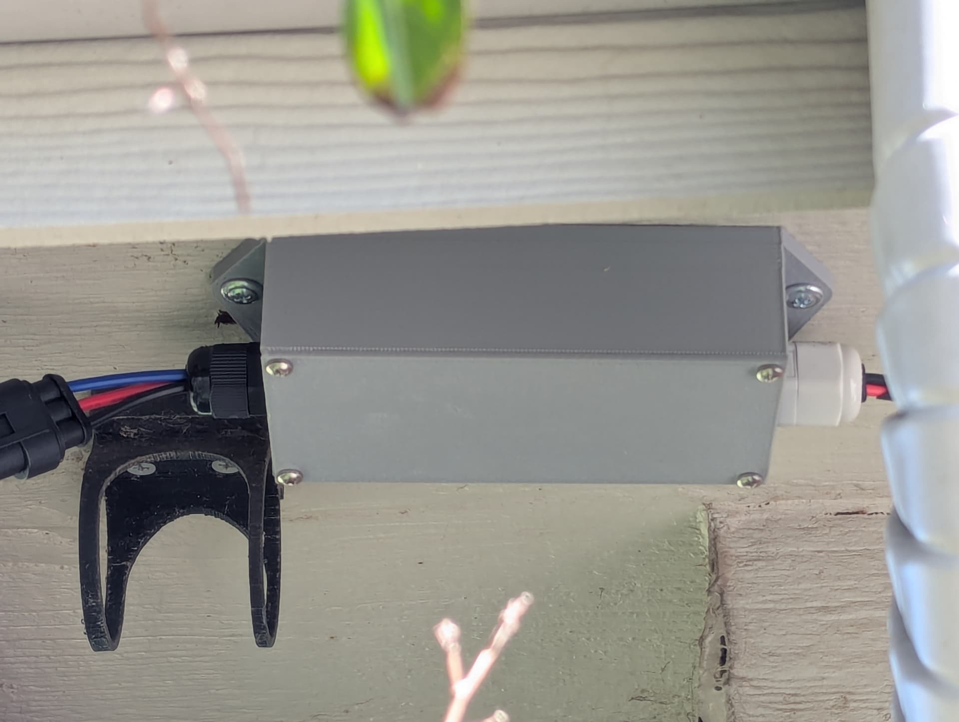

Then I designed and printed an enclosure to make the wled controllers a little more weather resistant.

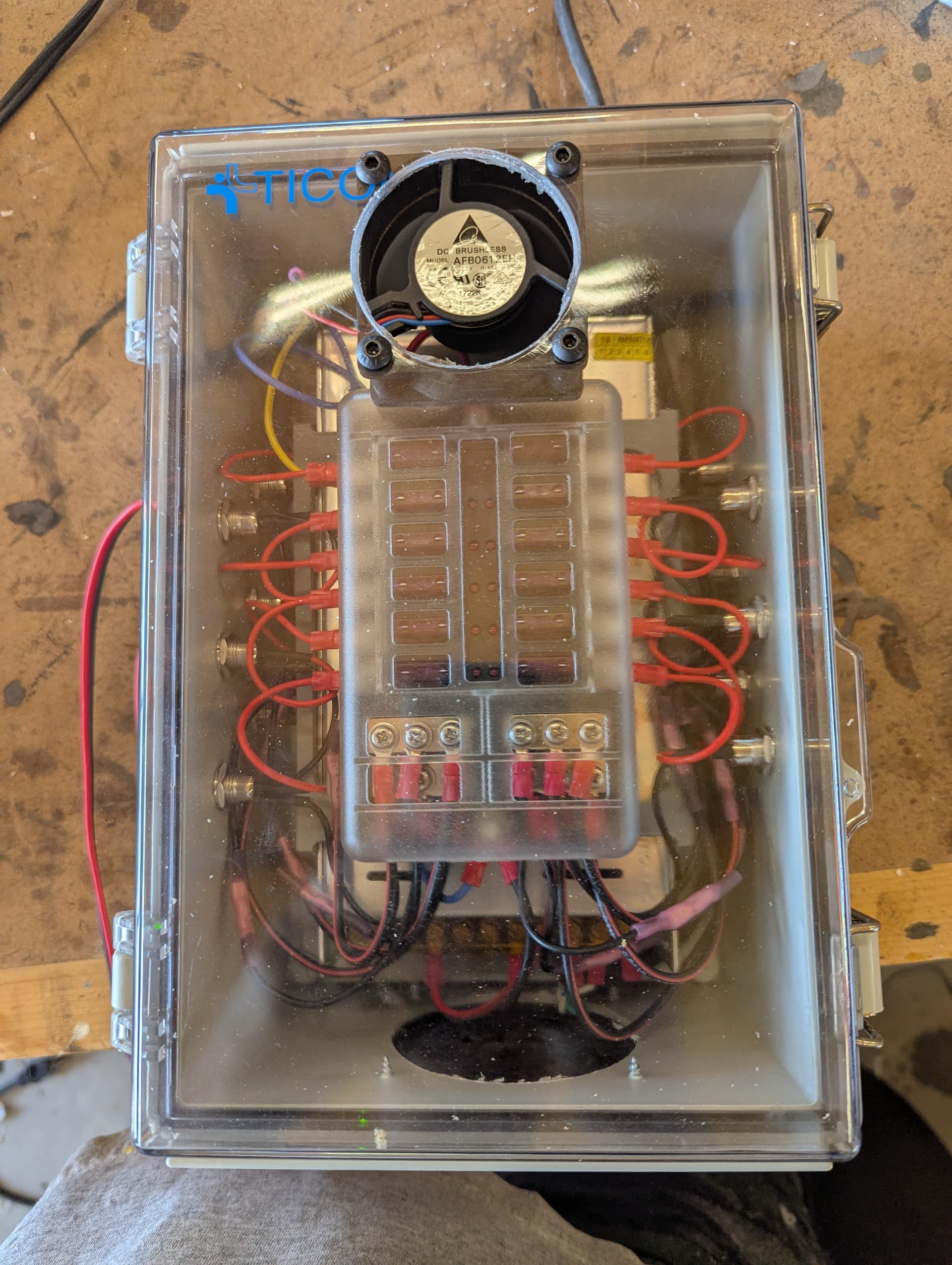

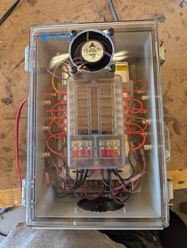

I also finally got around to rebuilding my power supply I use to power all my inflatable decorations. The exhaust fan is a psychoticaly loud delta that makes it sound like a leaf blower. I have a noctua on the way.

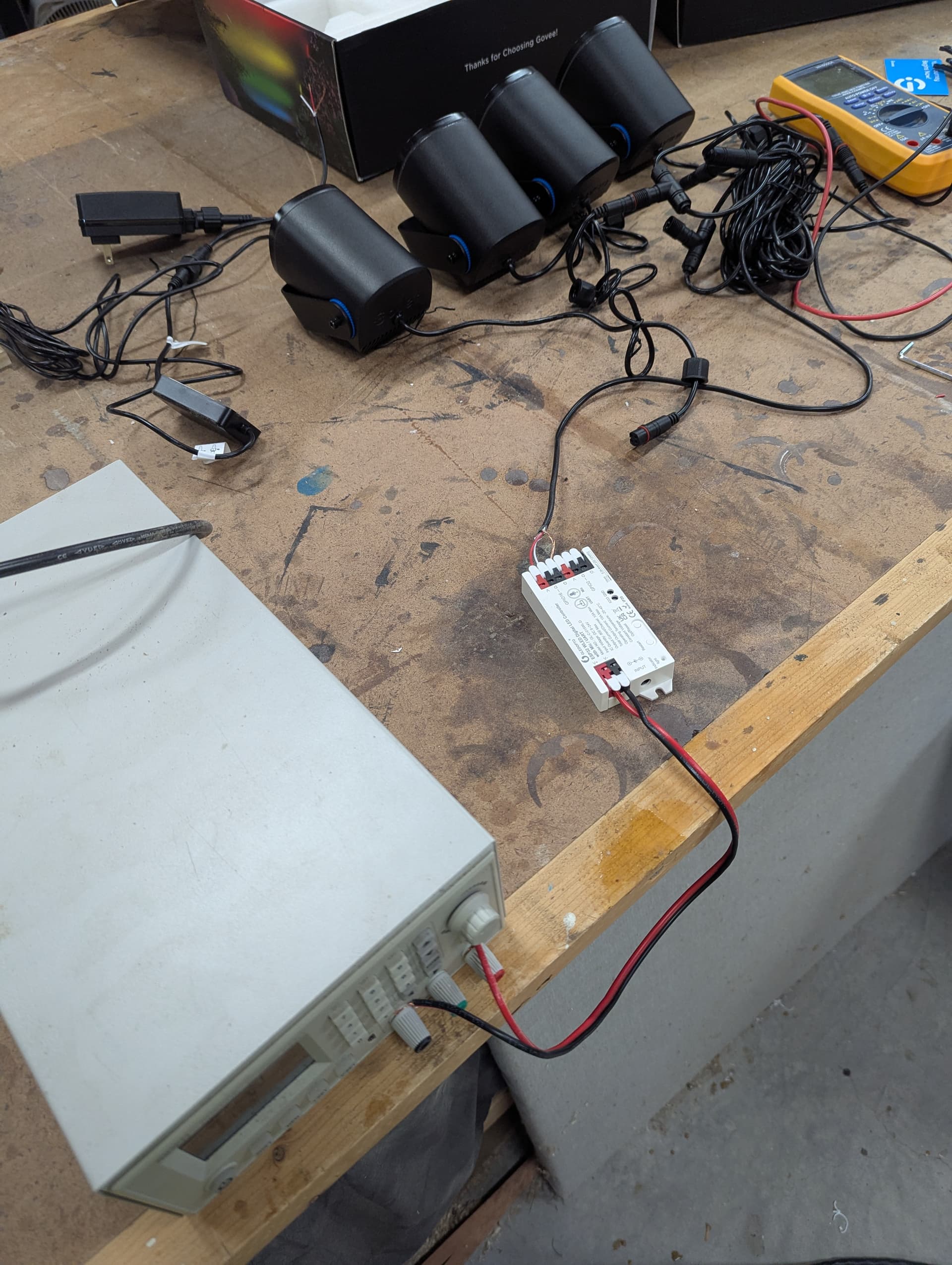

I got the wled hooked up to the govee spot lights. It works, but it looks like there’s a bug in the led driver. The led driver that these use have a separate control byte that sets config in the driver on start up. It doesn’t look like this is being configured correctly. I have to reset the led preferences after start up to get full brightness. I have a thread in discord about it m
The bug has been figured out. Combination of switching to current alpha branch and changing the max output current per LED in the configs. Not sure which actually fixed it as I did the tried and true method of testing by changing a lot of stuff all at once :confused:

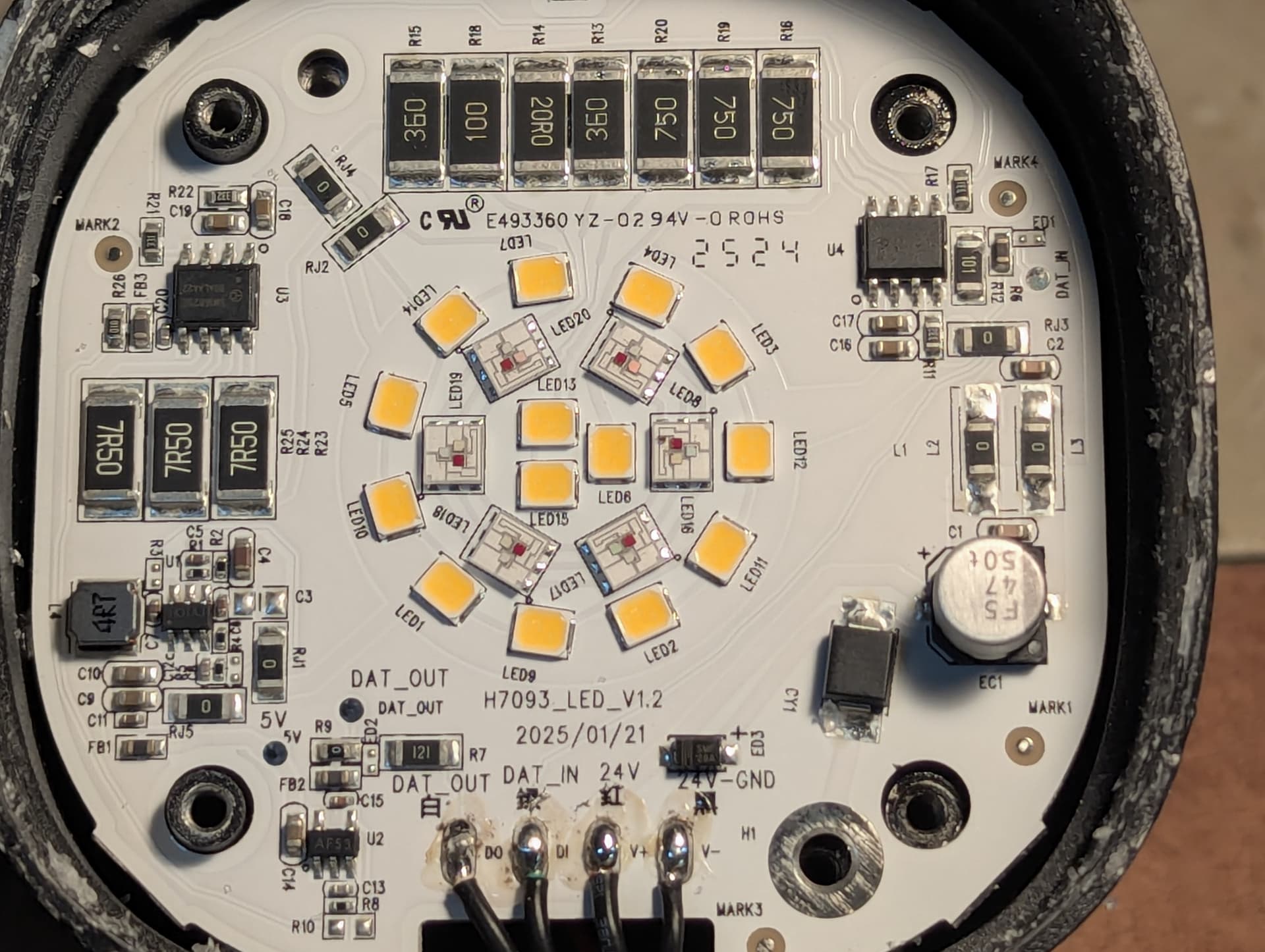

I did go so far as to tear one of the Spotlights down to see what was on the board to make sure I was using the correct controller. It’s a nice clean little board.

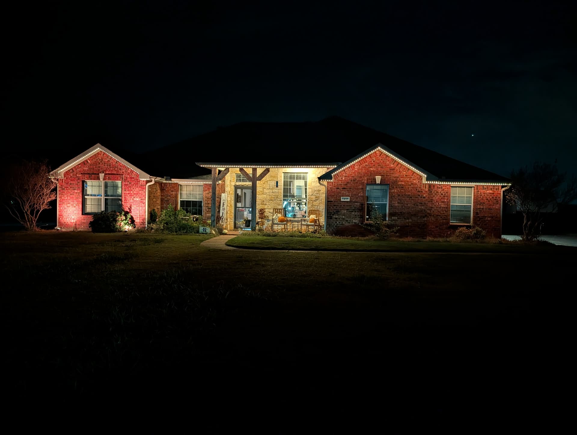

And done.

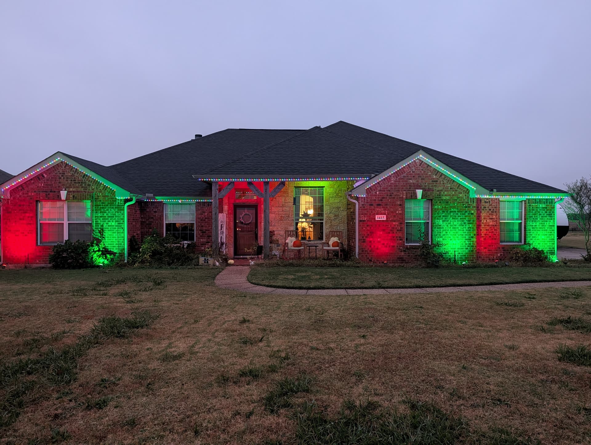

The spot lights on the right is a 4 led string. The lights on the left is only 2. For some reason the ones on the left are brighter. There’s more than enough current available for them to all have the same brightness. I’ve messed with the current adjustability on the wled, but it’s not helping.
Also, not all of the animations work on the spotlights. “Aurora” just causes them to turn off. But chase and other animations work fine.

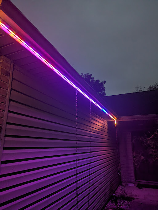

The eaves are set to move the colors across the house.
More testing to come.
Funny. The picture makes it look the same.
Got a picture of what you’re working with?
Still fighting the Govee spot lights. I think I’m running into a current limited issue. The string with the spot lights doesn’t run as bright as the strings with 2. If I fiddle with the lights turning things on/off I can get all 4 to light up bright like they should. It makes me think something is shunting the current during start up and they don’t recover. I’m going to try adding some power injection in the middle of the string and see if that helps. While I’m at it, I’m going to rig the lights so that I can convert the string of 4 into two strings of 2 and run them off separate controllers.
