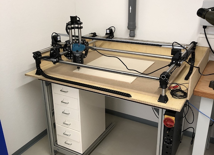

This is my first CNC build and it works pretty well in my opinion. Thanks Ryan for this awesom machine!
Data of my build:
  • Newest version from dezember 2018
  • 25mm conduit with 2mm wall thickness (very stiff!)
  • 600x800x110mm workarea (with this thick tubes it is still very stiff!)
  • Belt tension looks good (no bass-guitar-string and not loose)
  • everything is quare and snug tight
  • Katsu (Makita clone) router with massive mount (https://www.thingiverse.com/thing:1652878/files)
  • CNC shield with arduino uno and Estlcam Software
  • https://www.thingiverse.com/thing:1652878/files
First cuts where pretty nice. good sizes and good "roundness" in normal plywood with a 4 flute 4mm cutter. A bit gets a bit hot but I think its normal because of the low X/Y Speeds and the high RPM.
Then I switched to a 1 flute 4mm cutter (https://www.werkzeuge-fuchs.de/de/fraesen/oberfraeser/acrylfraeser/ent-spiral-bohrnutenfraeser-hs-e-hsse-z1-s8-fraeser-alu-dibond-alucobond-alucore) and tried to cut Polycarbonate and I have a serious problem with it…
First I checked some other videos and posts from people who cutted PC with goo results. Many of them did this job with a 1flute cutter, low spindle speeds, low Z axis and high X/Y speeds (up to 1000mm/min).
  • I tried a first cut in a sheet of PC with 800mm/min, 1,5mm Z Axis and 10000rpm and it get a nightmare! The whole machine was shaking and nearly my router bit broke appart. The router bit (4mm) made a hole with nearly 20mm diameter!
  • I tried a second cut with PC. 200mm/min, 0,4mm Z Axis and 12000rpm. It gets better but not good - the machine was still shaking a bit and the 4mm line of the router was about 4,5-5mm in some areas.
  • I tried a third cut with PC. 200mm/min, 0,4mm Z Axis and 14000rpm. It gets better but still not good. The machine was still vibrating a bit but the result was ok.
Why is my machine vibrating this hard with a standard 1 flute mill? All bearings are on the rails and everything looks and feels fine - but if I push the machine to more X/Y speeds the machine vibrates so hard that I have the fear that something gets loose...
Thanks for your support and kind regards
Sebastian
Here a picture of my setup

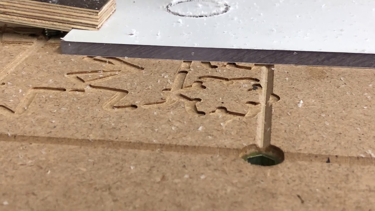

A couple of minutes ago I tried to go with 5mm/s, 1,5mm DOC and higher RPM. I used a 4 flute/6mm. In my opinion I had a good result… (see picture attached)
but why does it shake so hard with a 1flute and „softer“ settings?
