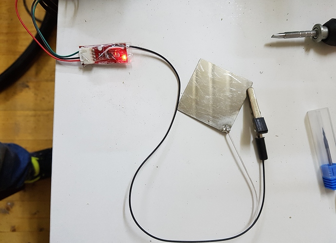

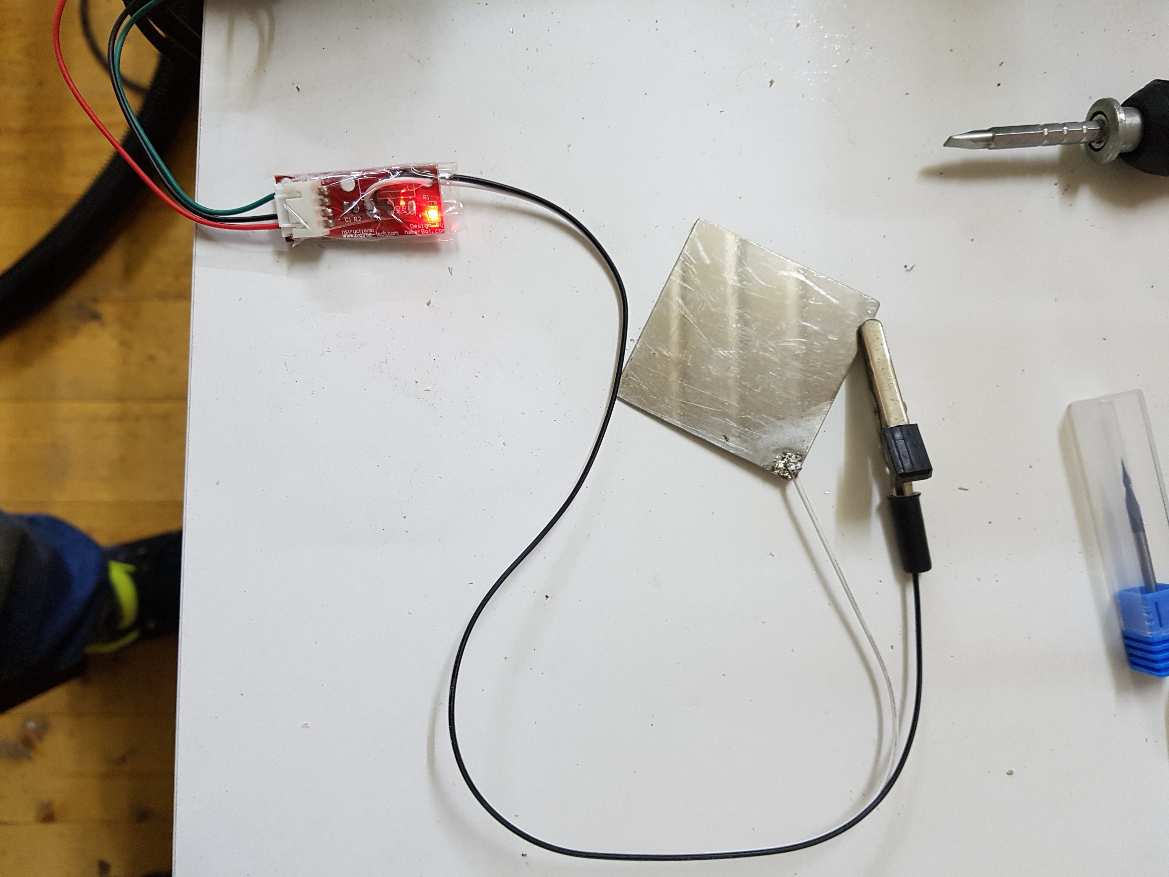

I had same problem. Length of wires of your z-probe is too long, so it triggered by emi. First time i swapped wires so ground was connected to the bit, signal ware to the plate. It helped, but not too much.
So i made electronic probe
[attachment file=85275]
