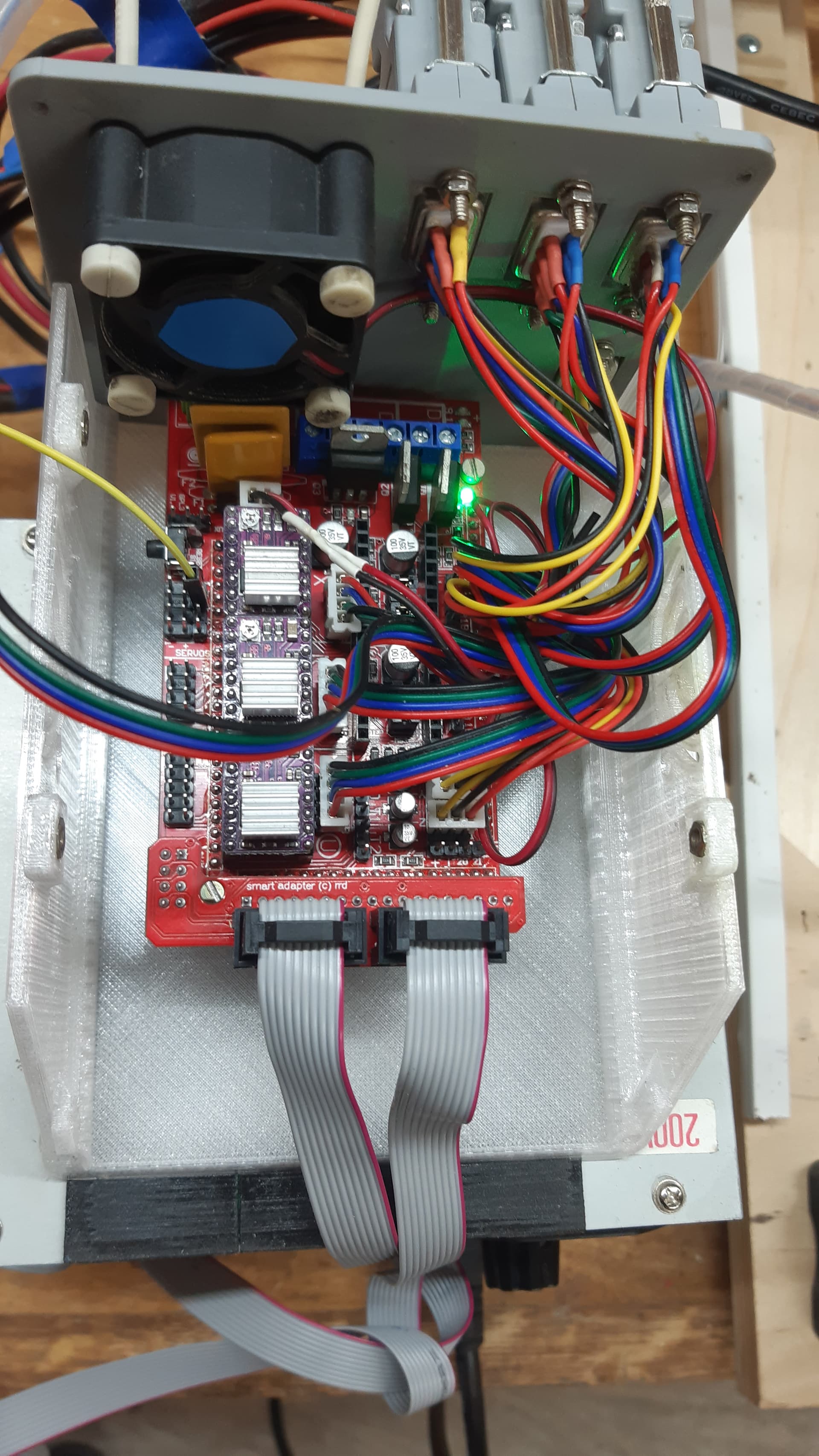

Good afternoon. I installed a new firmware on RAMPS 1/4 marlin and connected a laser with PWR control, 44 pin for control does not work. What could be wrong? I measured the voltage at D9 there it changes while the engraving program is running. How to make control from 44 PIN? thanks in advance
I’m not sure why you are seeing voltage changes on D9. Are you running the latest version of V1 maintained Ramps firmware (515)?
In the latest Ramps firmware maintained by V1, the laser PWM is assigned to pin 6, not 44. If you need to make it 44 for some reason, you will need to edit the pins_RAMPS.h file. Below is the section that controls the assignment. Since there are no servos assigned, pin 6 is selected.

Switch your engraving software to using inline commands or M3/M5 to control the laser, then use pin 6. No firmware changes required.
It looks like D9 is assigned as a fan pin. That means your engraving program is generating fan g-codes to control the laser. If your engraving software supports it, the best solution is to use inline commands. If it does not, M3/M5 commands can be used. Both will use pin 6 (a 5V pin) for laser PWM.
If you use inline commands, you must have the following at the top of your g-code file:
M3 I
This can automatically be inserted in most authoring software by adding it to the “start code” section.
Many thanks. Tomorrow I will try these changes and write the result
What engraving software are you using? Is it Lightburn?
I use Lightburn and LT-80W-AA laser
In Lightburn, under Device/Basic Settings, you want:
In Device/GCode you want:
Pin 6 on the Ramps 1.4 board is circled in this snippet:
Thank you, I will do it and write to you))
Greetings. Thank you everything went well
