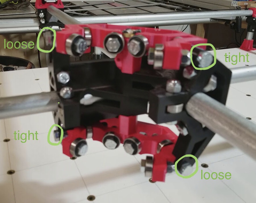

Hello everyone, I have a problem with my “MPCNC”. The Z axis is skewed sideways. It’s not the XY frame. The four corners / tubes are all at the same height. The tubes are at an angle to the front and back. I tried a little to fix the problem by making adjustments to the screws of the middle section. Unfortunately without success. Do you have any ideas about what else I could do?
With „the tubes are an angle to the front and back“ im mean this:
That is just a matter of getting the tension fairly equal on all four of the 2.5" bolts. I bet you will find two opposites are fairly loose and two are tight.
Thanks for your quick response, Ryan! Today i tried to fix it with equal and different tensions on the four screws (for example like shown on the pic). Sadly it wasn‘t the solution. Maybe i have to try it just with one tube on the left and the right side without the printed toolmount and z parts, to see where the problem is. :sleepy:
Start by making things more loose instead of making the loose things tight.

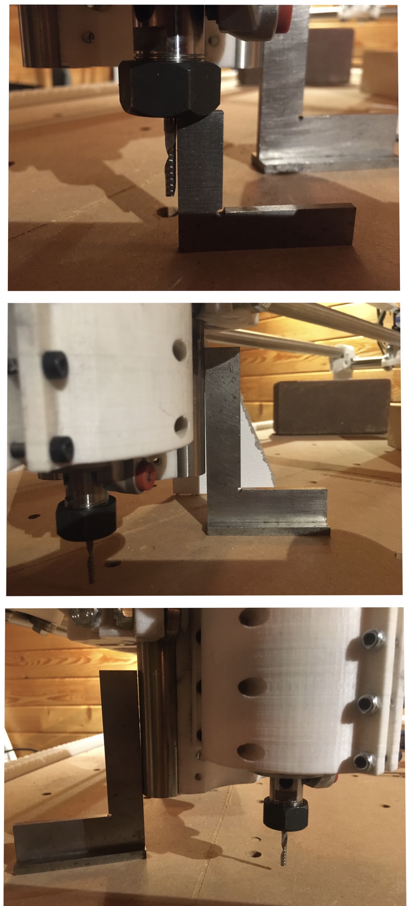

As i posted in another thread already today, my spindle is quiet heavy and leads to more tilt on my z-axis than my lighter proxxon tool.
I do think if i minimize that play using shims oder reprint that spacers it will help to carry or distribute the spindle weight over the parts.

I also think the tilt and play get’s more worse when starting to mill sheets of mdf or aluminum.
Maybe i will change dimensions so it get’s more rigid and use a double or bigger belt as show in another post.
