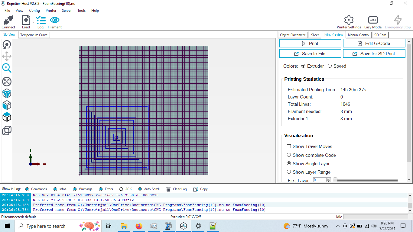

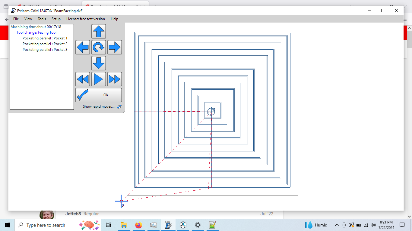

When I generate code it shows about 17 minutes. In Repetier Host it gives a time of 14 hours and doesn’t load the entire thing. If I try and run it, it usually just goes to the center and plunges into the foam and just sits there. Any idea what the problem is? Is there another gcode sender that people are using? Thanks.
Off by a factor of about 60?
That’s usually a mismatch between speeds in mm/minute vs mm/second.
That was it. Thank you!
