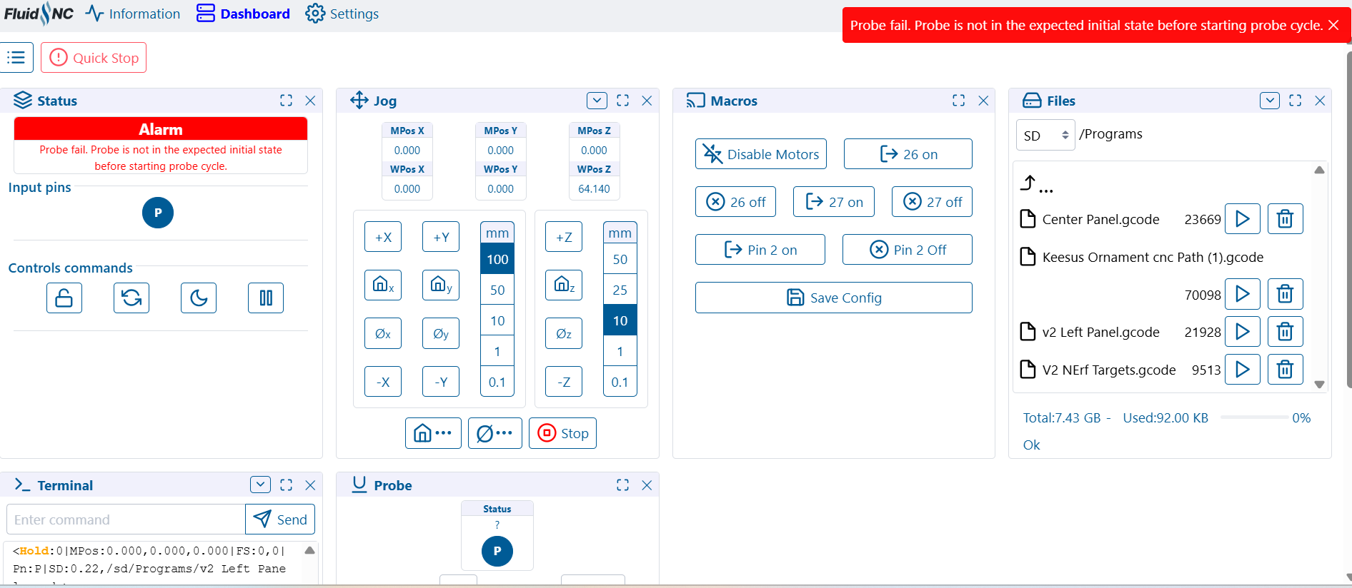

After successfully running several programs, I began to get the following error when I was probing my endmill at the beginning of a program.
I looked at the probe continuity indicator light on the jackpot board and it seems to be behaving normally. The light turns on when I touch the probe to the bit and turns off when I take it away.
I even completely disconnected the probe from the jackpot board and the WebUI continued to say that the probe was still making continuity.
I have tried restating the software, power cycling the machine, and trying known good GCODE. With no success thus far
Anyone know whats going on here? Or how I can fix it?
I’m not sure what’s going on but that error message is what would display if the probe was already making contact at the start of the probe.
What version of FluidNC do you have? There were some probing related fixes in 3.9.8 but I’m not sure they apply to the situation here.
The other thing we could try is moving it to a different connection on the Jackpot.
Im on FluidNC v3.9.9
I’ll try changing the pin on the jackpot
Yup, it was something with the connection on the Jackpot. Switching the pin solved the issue.
Thanks for the help! Any idea what could have caused this in the first place?

Is it possible that you swapped pin polarity when you moved the probe pin? I’m curious if that pin on the Jackpot is fried, which most often comes from ESD damage.
