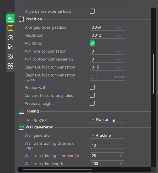

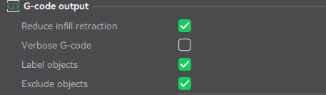

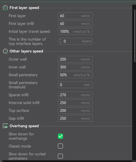

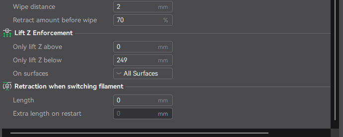

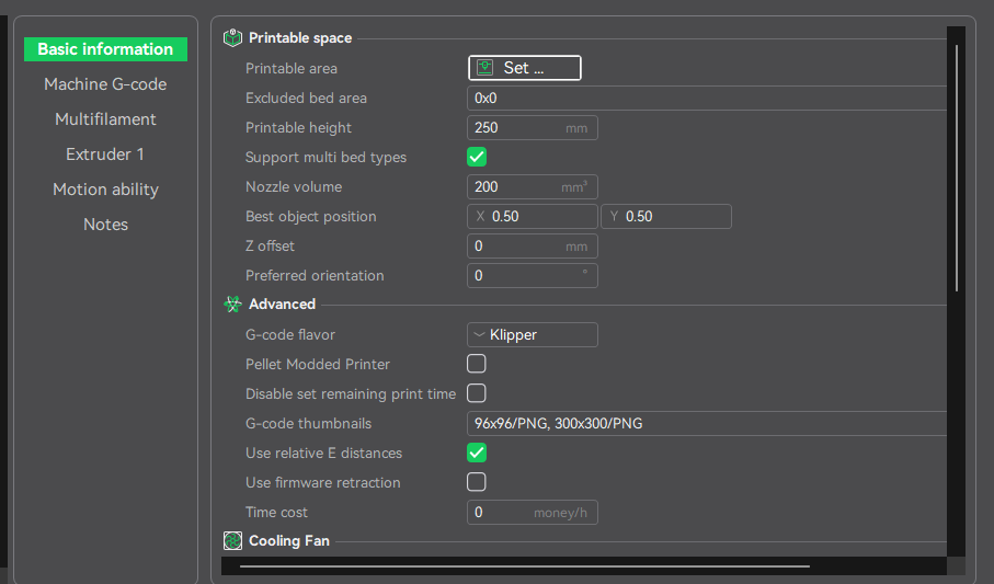

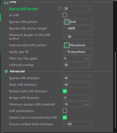

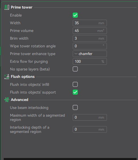

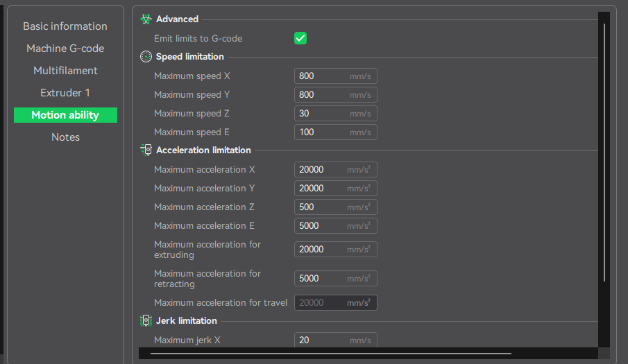

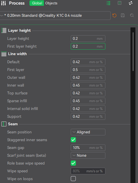

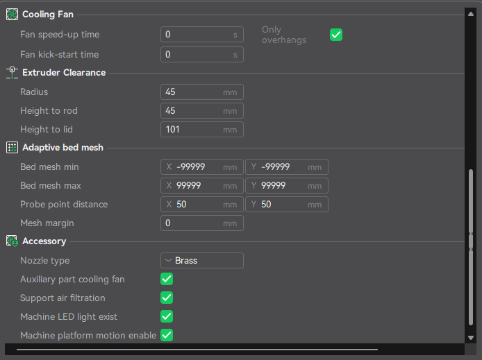

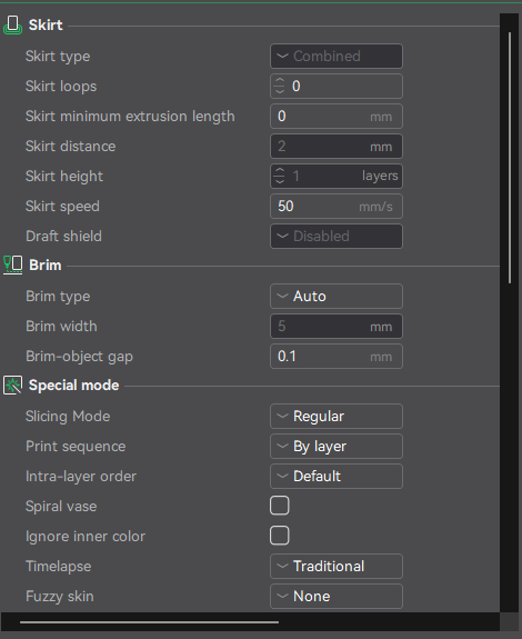

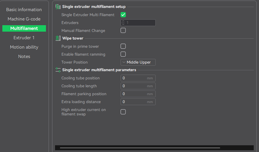

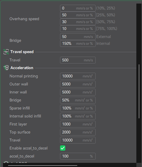

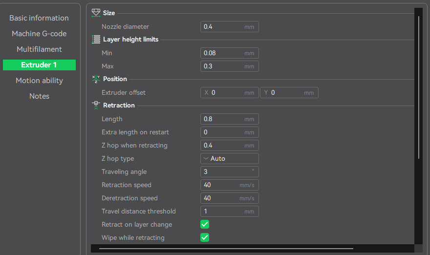

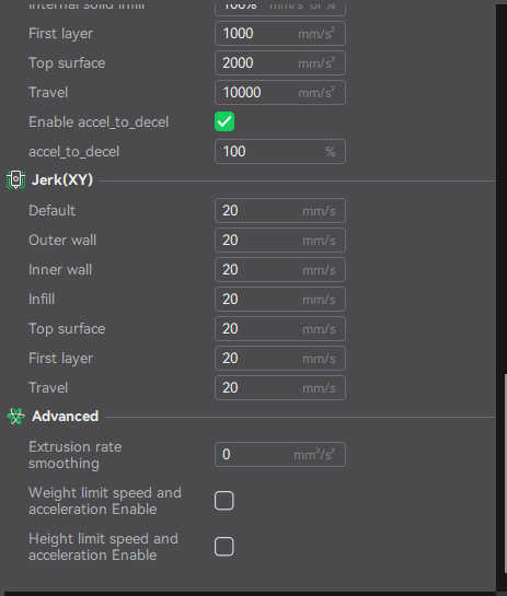

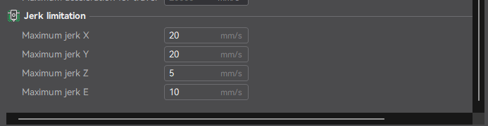

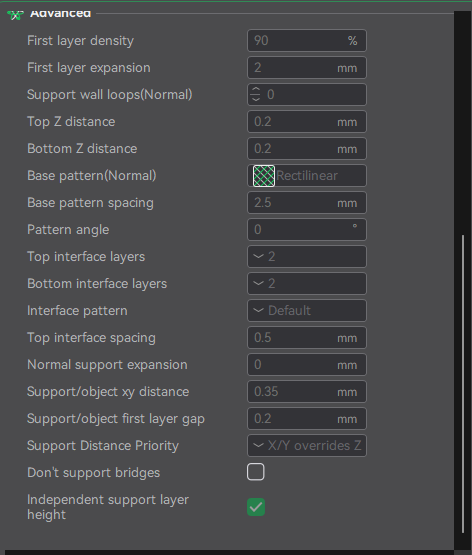

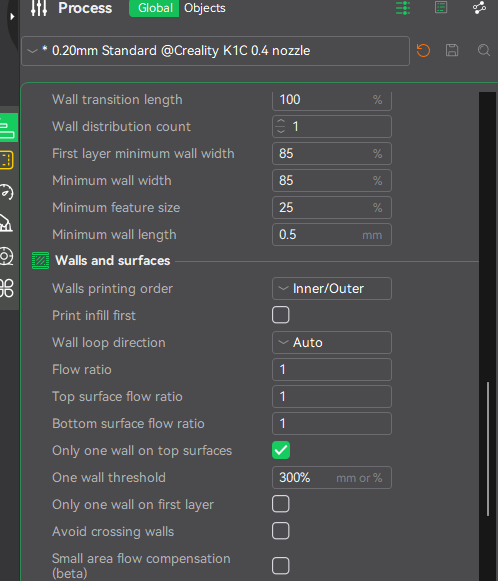

This is a screenshot of settings.
Please confirm.
That’s all for now.

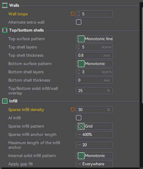

I’m embarrassed to say that I have hardly ever printed with basic PLA.
I’ve only ever changed the print settings for each filament by myself, such as changing the wall thickness (not the height) from 3 to 5, or imitated other people’s settings…
I plan to print the wall thickness with a setting of 5 loops.
I would appreciate it if you could give me detailed information on various settings for printing parts, such as whether it should be 6 loops or 4 loops.
It’s a 0.4 nozzle, but I’m also curious what you all think is a good layer pitch.
I live in Shiga Prefecture.
It’s next to Kyoto.
The instructions have that. It’s 3 walls. More can be a problem.
Yes, use 3 walls.

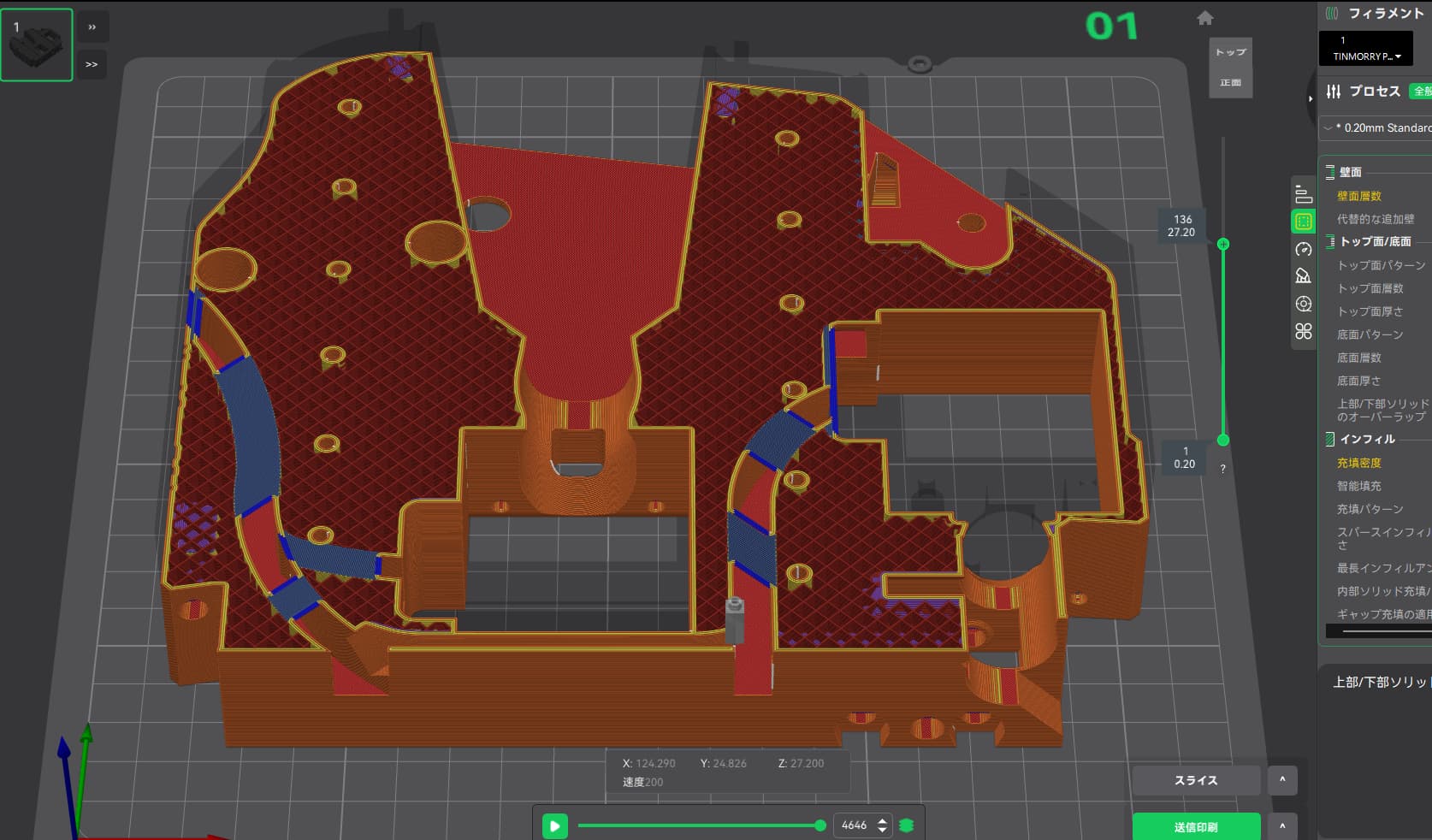

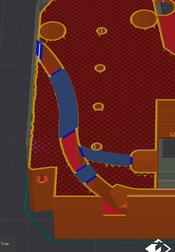

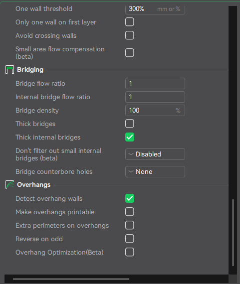

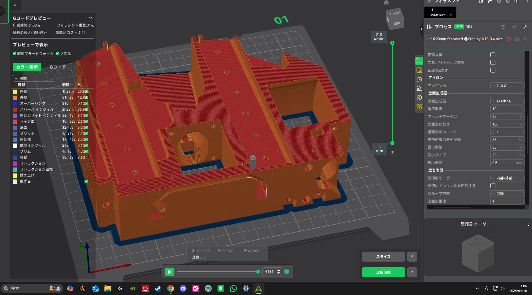

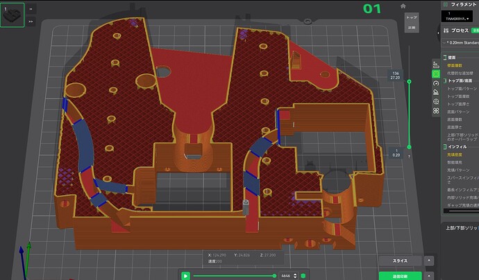

Below is an example of what to look for in the YZ plates.
In the screenshot below, this is the layer at 27.20mm high. Note that the bridging goes across the channel inside the part in the short direction. This is an area where those special hints I mentioned are in the part. When you preview your print files, they should look like this. If the bridging overhang lines run the long direction then you will have a bad result in your print.

The instructions have a table of recommended settings and notes at the link below:
https://docs.v1e.com/lowrider/#diy

I checked the preview with 3 loops (25% infill as per the instructions).
The result was the same as the screenshot.
Basically, regardless of whether it is large or small, use a brim to prevent it from warping.

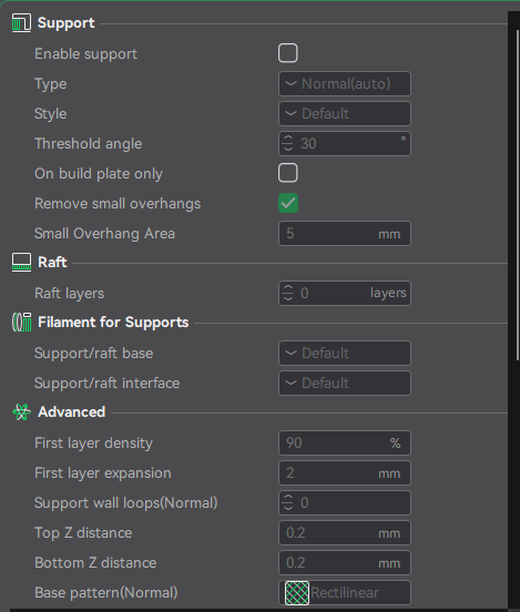

Regarding support material, is it better not to use them?
(I don’t want to use the small internal wiring spaces and holes…)
I always use the brim and you should also use the cable channels, without them the cables get messy.
Do not use supports. These parts are deliberately designed not to use/need them. It will only make things worse, not better.

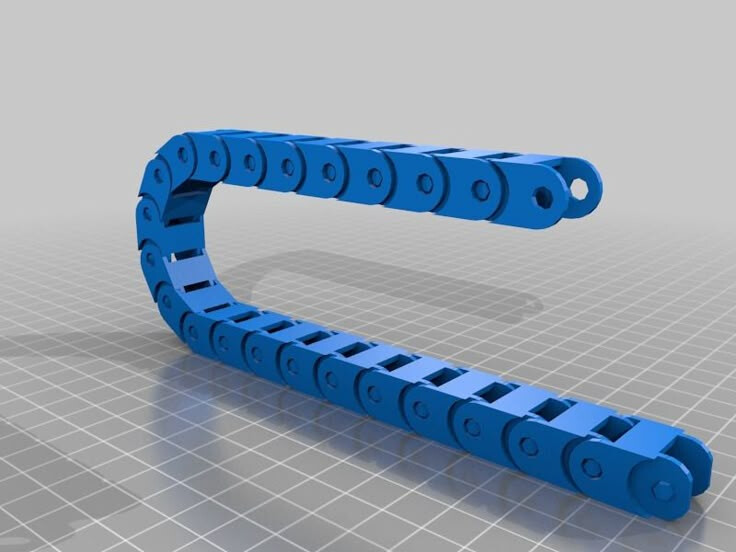

I agree. I would like to use something like the image as well as a wire sleeve. (I’m not sure if I can afford it due to my low budget though…)
