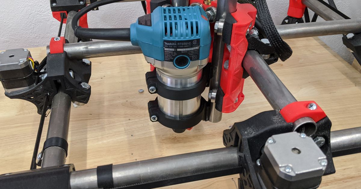

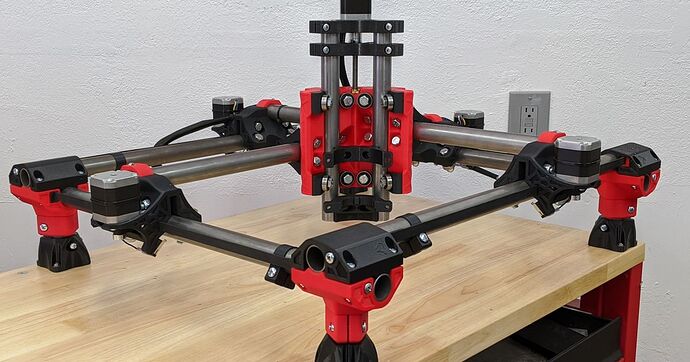

I printed the MPCNC machine and the tool attachment will not fit to the Z access. Can you recommend a Makita tool attachment that fits.
The Makita mount ought to be fine.
There are 2 other parts that form the basis for the tool mounts. They are needed because the Primo could be made with 3 different sized tubes. 23.4mm (3/4" conduit) 25mm tube, or 25.4mm (1" OD tube). Because these are different, an adapter of sorts makes for a standard mounting surface.
So you need the correct upper and lower tool mounts for the tube size, and then the mounts for the tool itself.
I printed all the parts with the 25.4mm tubing, marked with a J. Can you recommend a link to the Makita mount?
The “upper-tool-plate–primo” and “lower-tool-plate-j-primo” from the main need to be there too.
