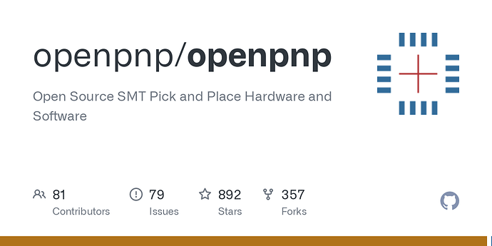

Something close to what I’m looking for can be found here:
http://openpnp.org/
Its a pick and place machine used prominently for placing minute components on a lot of PCBs.
But there’s no way I can use it for print and cut function as I require, as the software isn’t built for that purpose.
