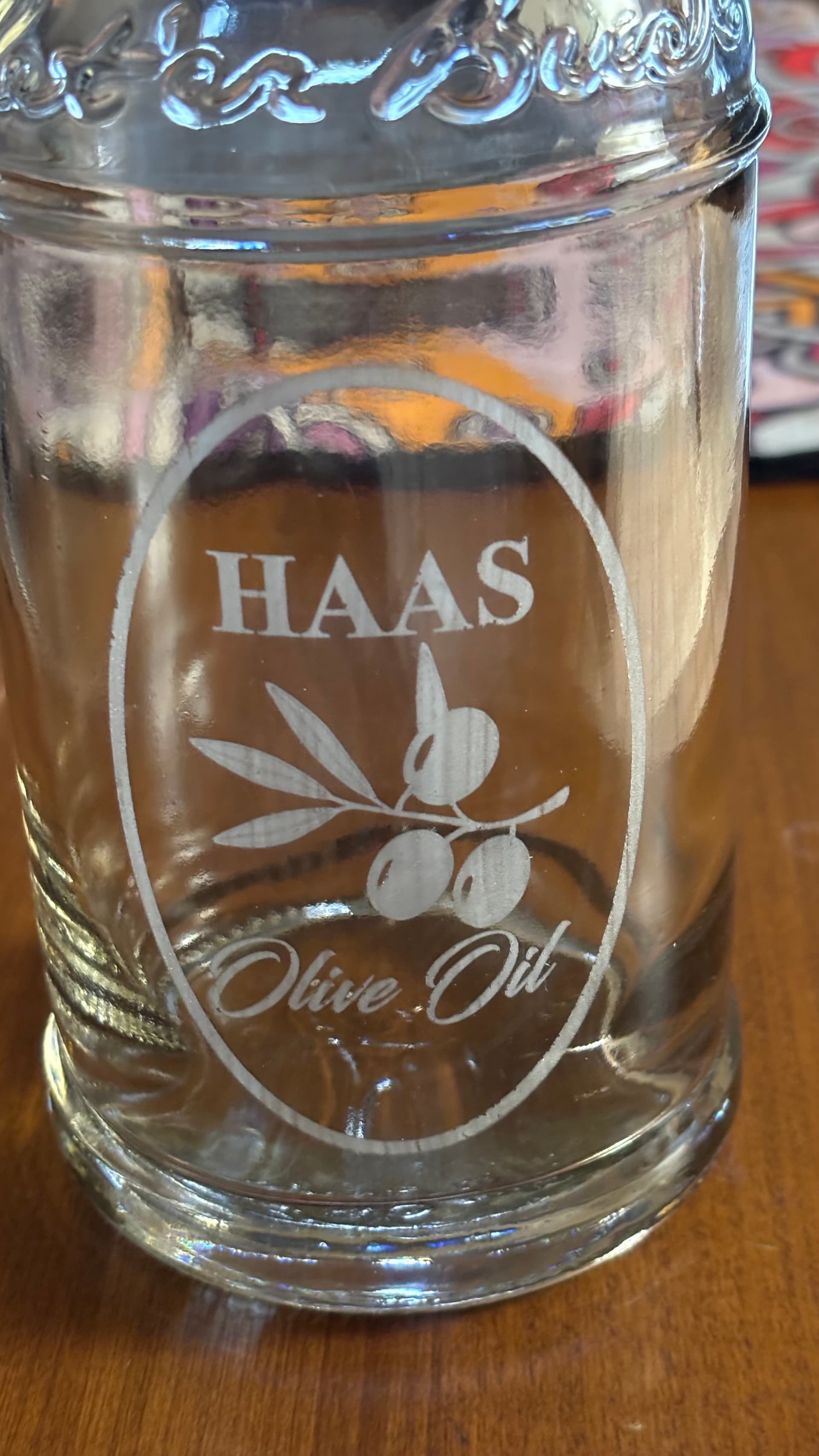

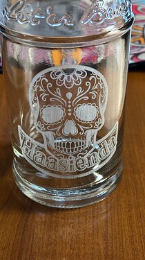

I just finished doing these:
Thank you I’ll try your file and see if it makes a difference I’ll also double check the settings in lasergrbl I believe they are set up 0-1000 though. The glass bottles are very cool! A rotary axis is on my someday list so it’ll be great to have that option already built in! The weather here is forecasted to be awful cold the next few days so I’m planning on short bursts of work on the cnc since it lives in my un heated garage!
