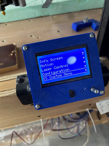

  1. Even though I set current limits on the Ramps Board Drivers they seem to run really hot when I touch the heat sinks.
  2. My job start strategy has been to do the following:
a) Use the V1 Custom Menu on the LCD to home the X and Y axis.
b) Move the 3 axis to the start position for the job.
C) Go the print file on the LCD and start the job.

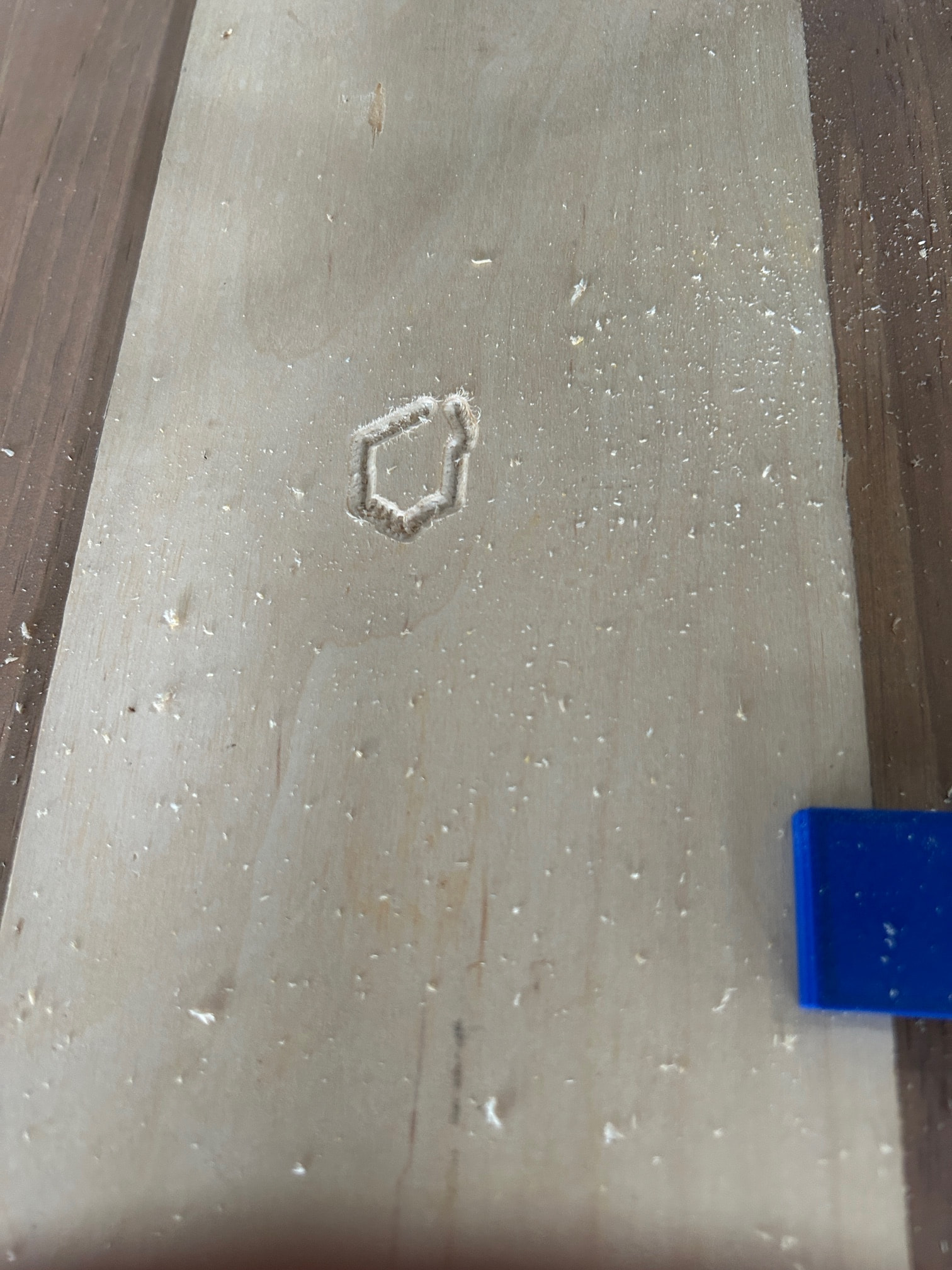

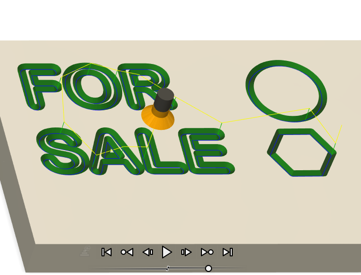

Below is what I post processed from Fusion 360.
On the first attempt I got this and then the Z axis raised and traced out the rest of the file in the air.
On the second attempt it did a distorted job on the hexagon and then dove into the board,
The machine ran well before I had to upgrade due to Fusion 360 making changes that made me go from Marlin 1 to Marlin 2.
Does anyone have any ideas on any of this. I’ve got a tremendous amount of time in this now with little to show for it.
Pardon the barrage of questions, but hopefully they’ll help isolate what’s causing your trouble.
When you went from Marlin 1 to Marlin 2, did you clear the eeprom? If I remember correctly, some of the saved values were shifted to new memory locations, so old info left from the previous version could be causing things to act strange.
It almost sounds like the probe is acting as if it was active (plate touching the bit) already so it just did the pull-off when you tried the probe routine. Any chance you’ve got the probe set as normally closed in the firmware instead of normally open? Most of the end stops should be configured as normally closed in the firmware (again, if I’m remembering correctly, it’s been a while since I’ve run Marlin on anything, and I never ran it on my MPCNC).
For Z, are you sure your steps per mm setting is correct? How much Z travel do you actually have? What positioning mode (absolute G90 or relative G91) are you in when you execute the tool change code? The command may be telling it to go up 35 mm from the current position if you’re in relative mode, or go to Z=35 if you’re in absolute. If you’re already up high and tell it to go higher, you can run out of travel, especially if you don’t have soft limits enabled.
