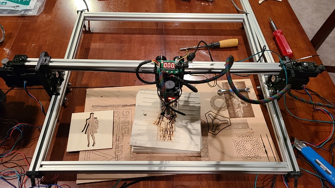

Decided to build a separate platform for the laser. Primo worked great, just took up a little too much desk space. This will do about 400x400mm.
It’s a hodge-podge of different parts from multiple machines I found on the thangverse. Also used @meatball 's belt clamps from his remix of @geodave 's cantilevered laser engraver. Got another CNCshield and have it pretty much dialed in. Haven’t decided on whos legs I’m going to use, It’s currently sitting on 4 M5 screws in hammer nuts.

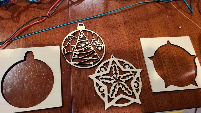

So the Christmas gift factory is up and running. These are 2.6mm stock cut at 200mm/min, 100% power, 2 passes. Somehow I feel that faster speed with multiple passes makes for a cleaner cut.
dang it. I’m going to hobbylobby and picking up some thin plywood this weekend. I really need to see if my laser can burn through it now.

I would really like to see a picture of how you have your laser wired to the control board, to help make sure i am doing it right for mine.
So I have a pair of wires going from the Z-max end-stop to the TTL input on the controller that came with the laser. It then connects via a 4 wire lead to the laser head itself. This carries power, PWM, and temperature feedback. The 4wire cable came with the laser kit.
thanks for the pics, unfortunately I am using a different board, but the concept is the same.

I made a new nozzle from a pen and have it directed better now. Almost no scorching on the cuts and repeatability is great! Figured Sata…Santa’s workshop needed some helpers.
Mrs. Claus has decided on gnomes this year.
Another test. This time 3.12mm, labeled 3mm-1/8" baltic birch plywood. 100mm/sec@100%, 2pass.
EDIT: Sorry, 100mm/MIN!

Minor splintering. Nothing that can’t be fixed in post. Probably would’ve turned out nicer if I used a knife to weed it out.

More pieces from Santa’s workshop.
Today’s output…
Took about 1-1/2 hours each piece. I used the 1/8" birch, 200mm/sec, 100%, 4 pass. Still needs some post, but cuts are done. Got the file at 3axis.co.
EDIT: Sorry, 200mm/MIN!
