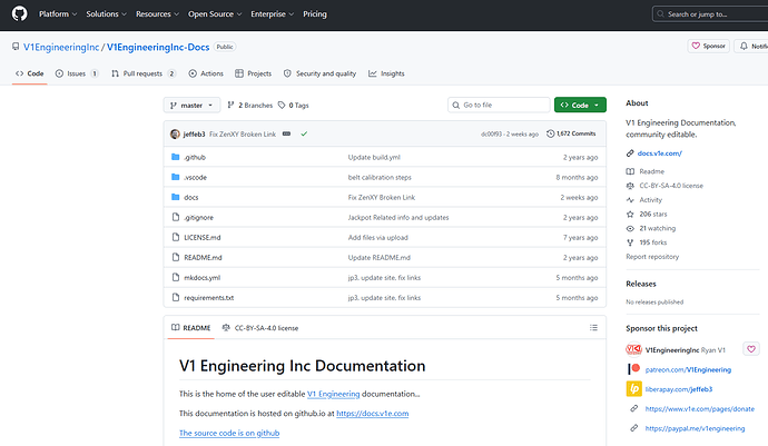

Hi Ryan,
I went to V1 Engineering in Github and could not find arduino/marlin files for the mpcnc. I get to the page below and have checked every link to no avail. I found that when I purchased the preloaded Arduino Mega it was approximately January 17, 2018. The version of Marlin that is on it is Marlin 1.1.0-1 I would really like to get a copy of that version for comparison to a new Marlin configuration. Any idea how I could find that firmware version? Also is there a Marlin 2.x version of the firmware somewhere for use with the Ramps 1.4 and dual endstops?
Release V515 Marlin 2.1.1 · V1EngineeringInc/MarlinBuilder · GitHub, here you go last updated in 2022 but it should help.

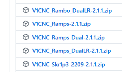

Hi Ryan,
What is the difference between the V1CNC_Ramps_Dual-2.1.1.zip and the V1CNC_Ramps_DualLR-2.1.1.zip versions from Release V515 Marlin 2.1.1 · V1EngineeringInc/MarlinBuilder · GitHub
Also,
When I download the zip file V1CNC_Ramps_Dual-2.1.1.zip and extract it to a folder I get this result which has a zipped file in it.
If I extract that file I end up with this in the folder.
Is there a file I can open with the Arduino IDE to flash my Arduino Mega 2560 with or how do I go about getting the firmware on to my Arduino?
I will admit I’m in new territory here and really appreciate your help.
I believe the RAMPS_Dual is the version for an MPCNC with dual endstops for auto-squaring. System config is Dual X axis, Dual Y axis, Single Z. Each X and Each Y have an endstop to let the machine auto-square. This firmware is for an Aurdino + Ramps controller setup.
This is also for an Arduino/RAMPS controller, except now for a LowRider CNC (Single X, Dual Y, Dual Z). This uses a single endstop for X, dual endstops for the Y motors and Dual Endstops for the Z motors.
The .hex file is a file that some device programmer software can load (for example you can use XLoader to flash it) This doesn’t let you make changes or see the source code.
