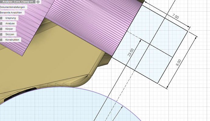

OK, I measured the dimensions in the STL as good as possible.
Could you then please check STL once more, because the STL from thingiverse does not match your design, as far as I can check.
I used your dimensions to show the difference on the STL from thingiverse. The square is the bearing inner bore, wich does not align with the bore of the clamp, where your model says it should.

You have sketched the bearing in your model, with an axial distance of 23,5mm between bearing and tube. But does the bearing bore align with the core and clamp bore, is there eventually the small deviation I am measuring in STL?
What letter is debossed into your part?
All the bolt holes are centered on the bearing, yes, I checked. I am taking this very seriously.
I’m measuring the bearing holes to be 23.6052 mm away from the central axis where they would be equally distant.

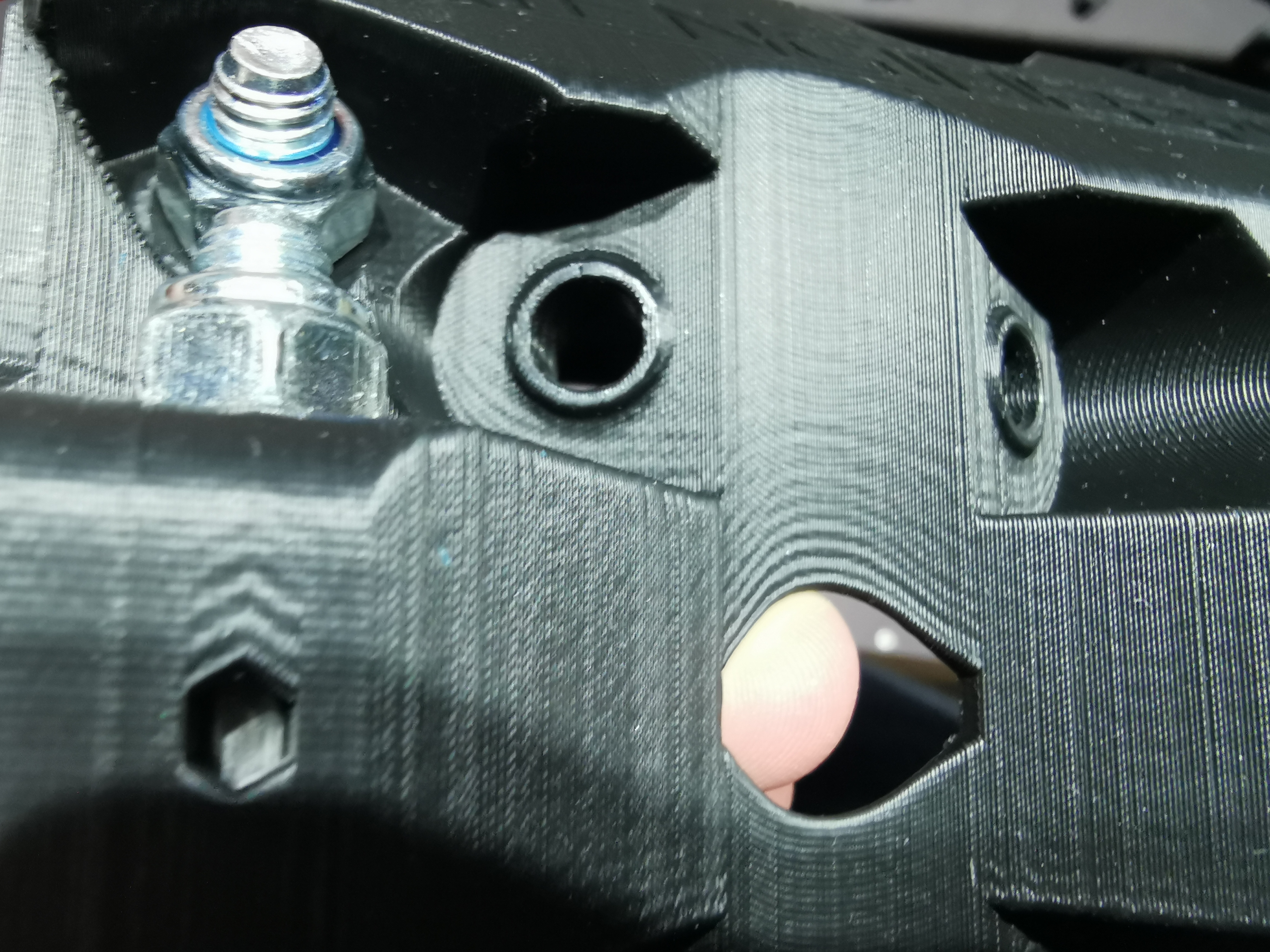

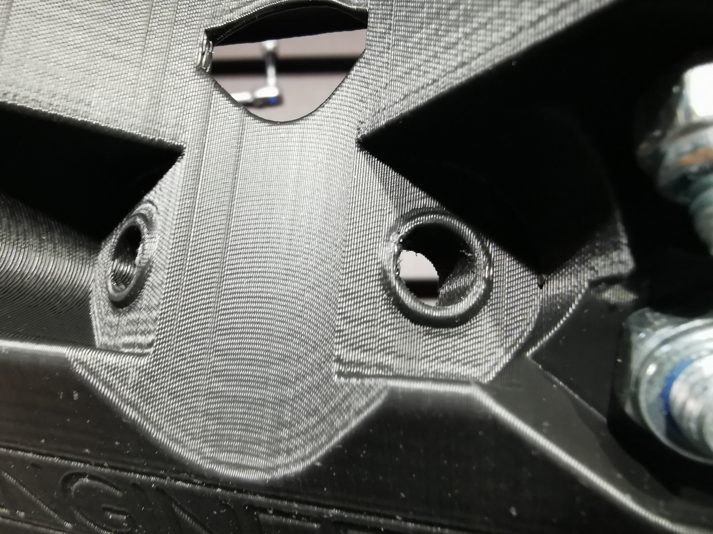

If your printer has acceleration issues (too low of accelerations) you will get a large bump on each of the Core and clamp bearing stand offs. One of the only places I do not have a round corner. 90 Degree corners are easy place to get print issues. Since this would occur equally on two parts the error stacks up. You can easily move the clamp 1mm+ too far out. If you tighten the two bolts that go into the core a little extra it will most certainly pull it in nearly .5mm, and if there is a faulty print, you could bring it in even further, as the acceleration bumps will easily crush.
Can you show a picture of your bearing surfaces with no bearings, or bolts.
You should have slightly shiny flat surfaces from the bearings fully seating on both sides. If it is not perfect all the way around it is getting assembled crooked, if there is no shiny surface it is getting assembled too loosely.

Yes, I sanded the core and clamp standoffs and tightened a lot harder. It’s better, but not good yet, maybe a little more sanding. I realy don’t want to give more torque. But sanding isn’t very precise.
