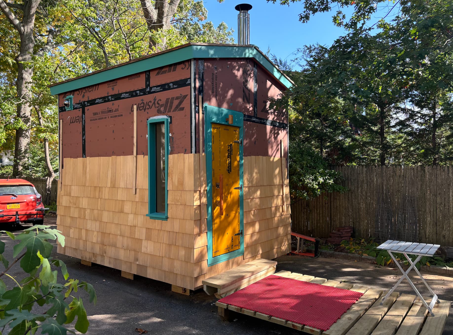

I decided to learn how to shingle. Eastern white is a bit overpriced on the East Coast so I paid a little more per bundle for premium Alaskan Yellow Cedar.

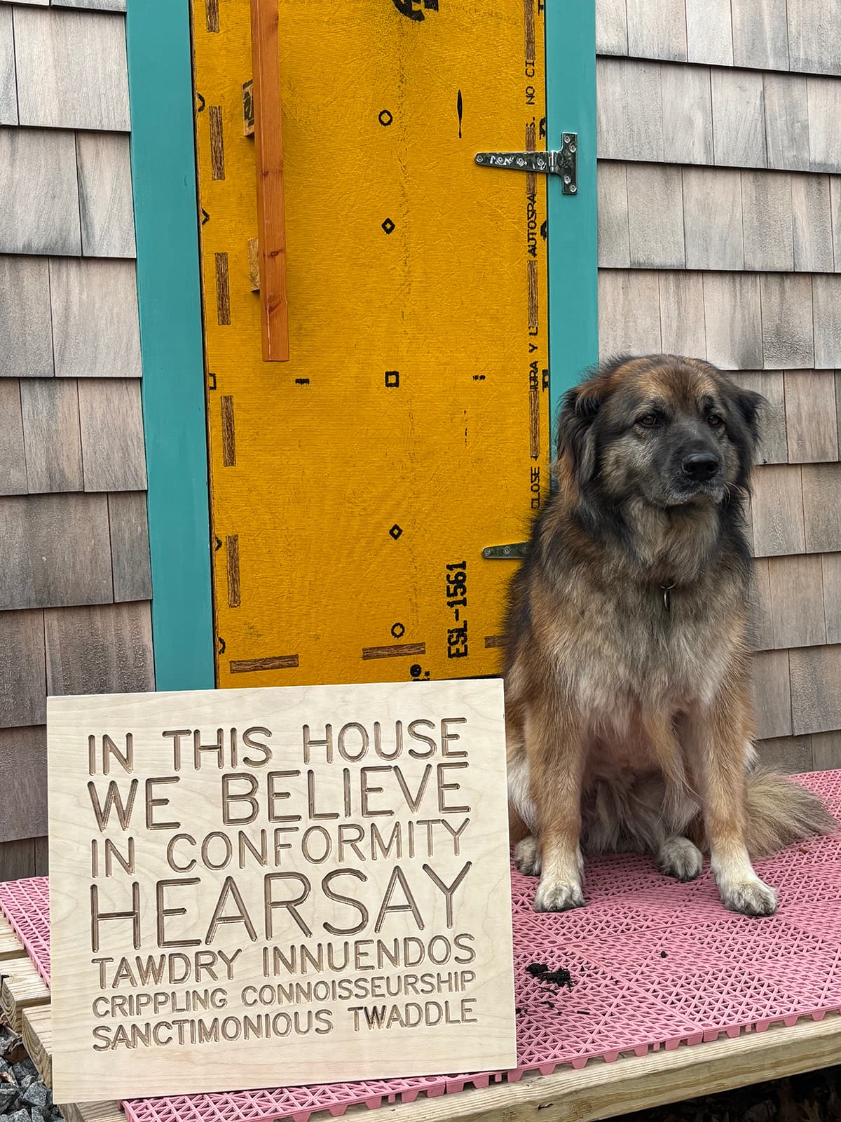

I wanted to showcase some part of CNC process so I used the exterior of the door to work with the cool Advantech X-Factor yellow. Saturated exterior with West System and a UV coat of Epifanes Boat Varnish.

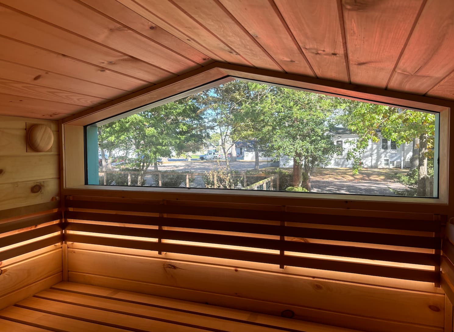

Tempered IG panels framed out in rough opening. Sealed with Buytl tape and polurethane SIKA. Inside pine treated with semi-permeable OSMO – a pretty low-key non-toxic finish to add a little waterproofing for condensation.

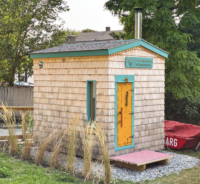

Finally, an update from the Dept of Saunatation!
It is up and running. Big success.
We got a little cheeky and squeezed 12 people inside for my wife’s Phd defense afterparty. I think 8 is sort of the comfortable max.

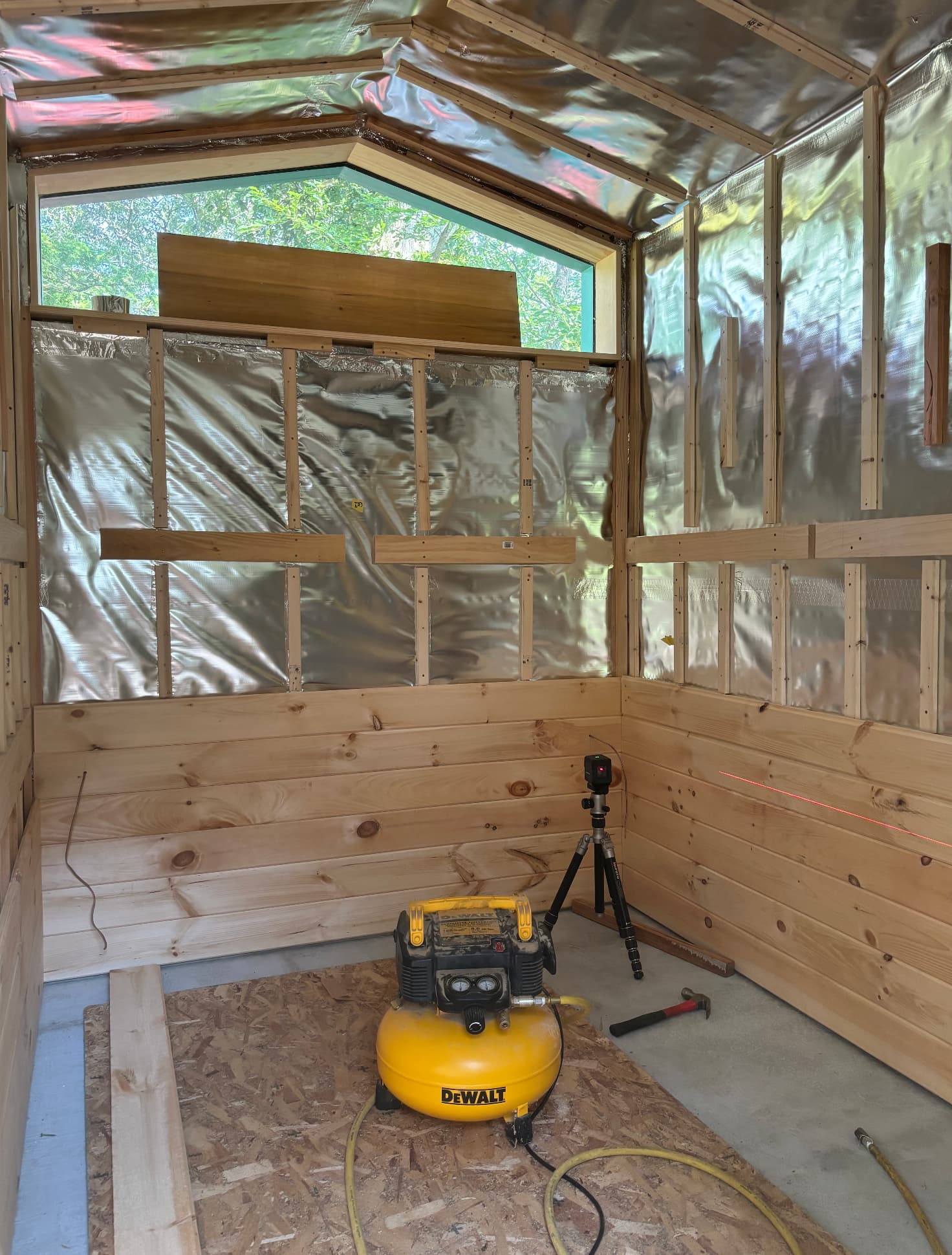

This is about where I left off last in terms of progress…
Rockwool R30 insulation to match thickness of CNC frame.
Reflective vapor barrier, furring strips for air gap and T&G Eastern White Pine (lumber yard says Northern. Not sure distinction).

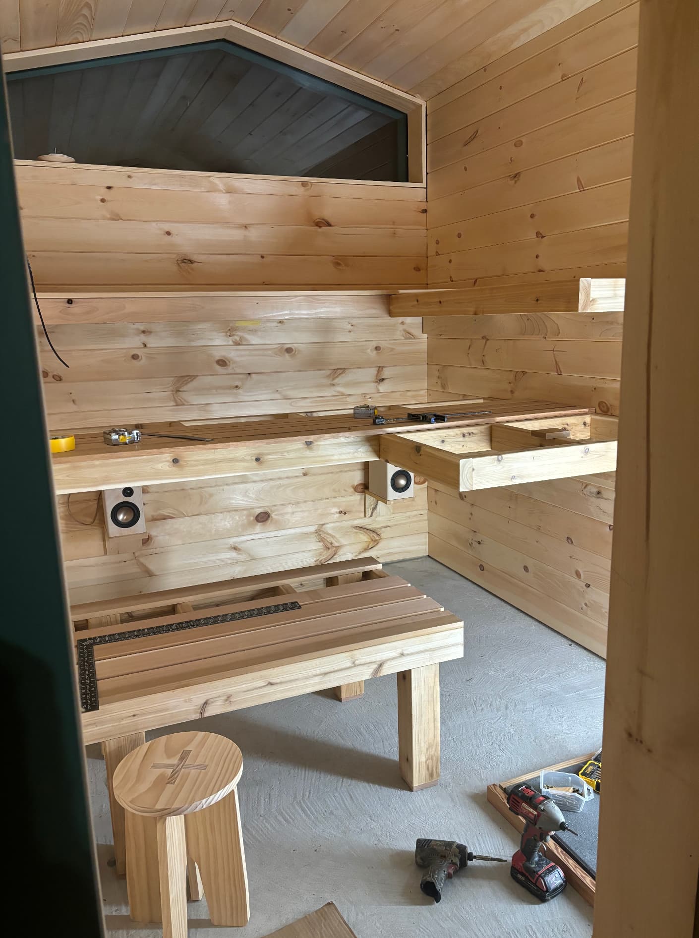

Durock/Vinyl cement for floor and stove area

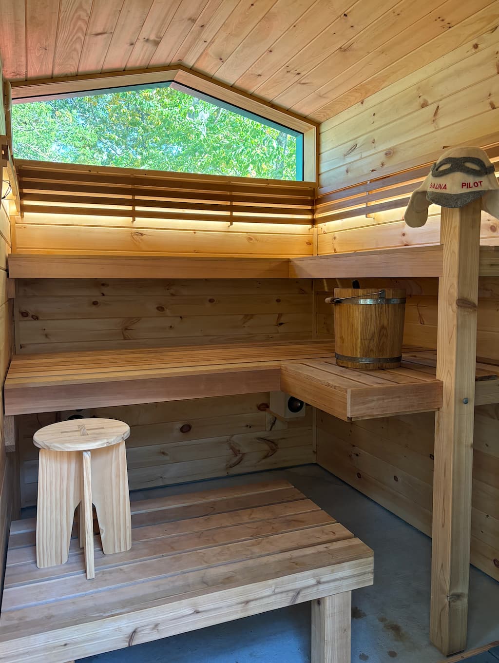

Cedar benches

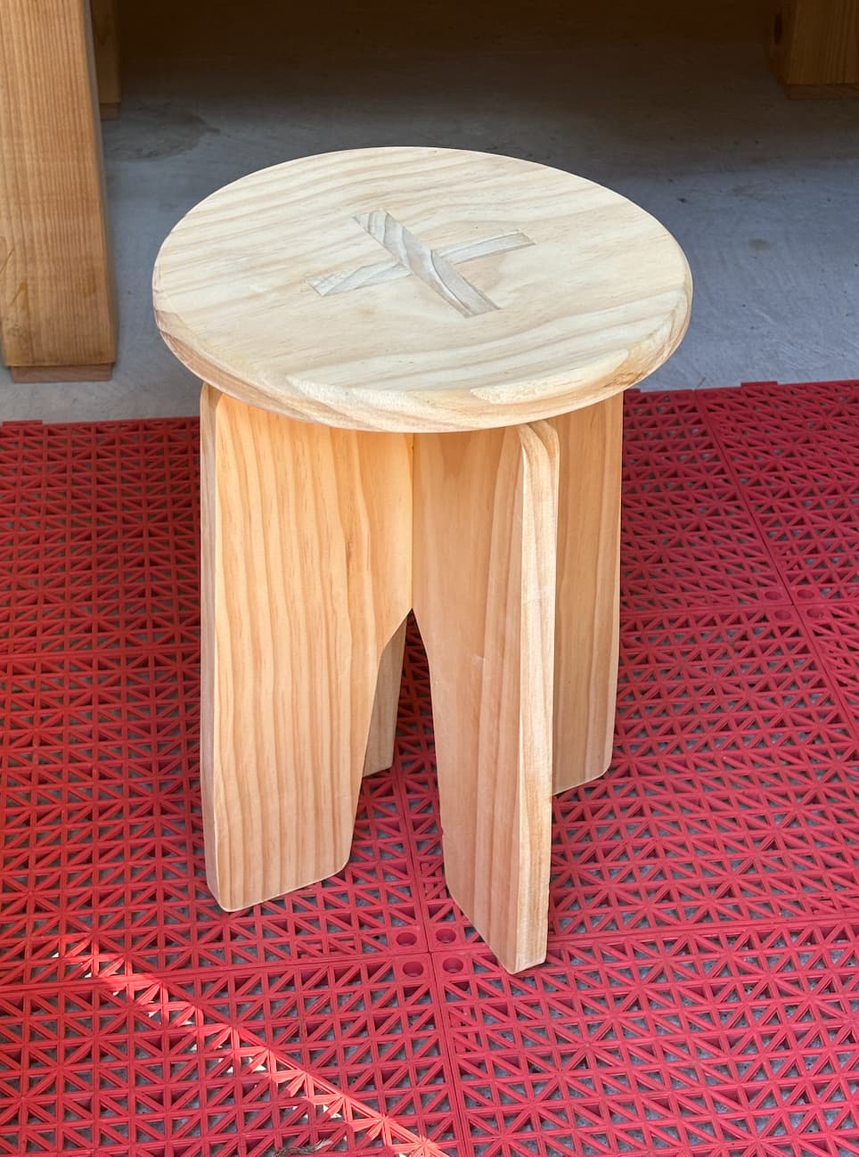

Stool made on Lowrider in Select Pine
Stove burned/cured a couple times outside and then inside. Stainless heat guard sheets on back and side.
Have to manage the dirt and stains on cedar better.
Backrest slats in cedar, Used Lowrider to cut the curved pine supports. Adjustable air vent on left.
Aside for a couple small details inside… the shingles are the last big ticket item.

Also, the stool is really neat, it just looks good.

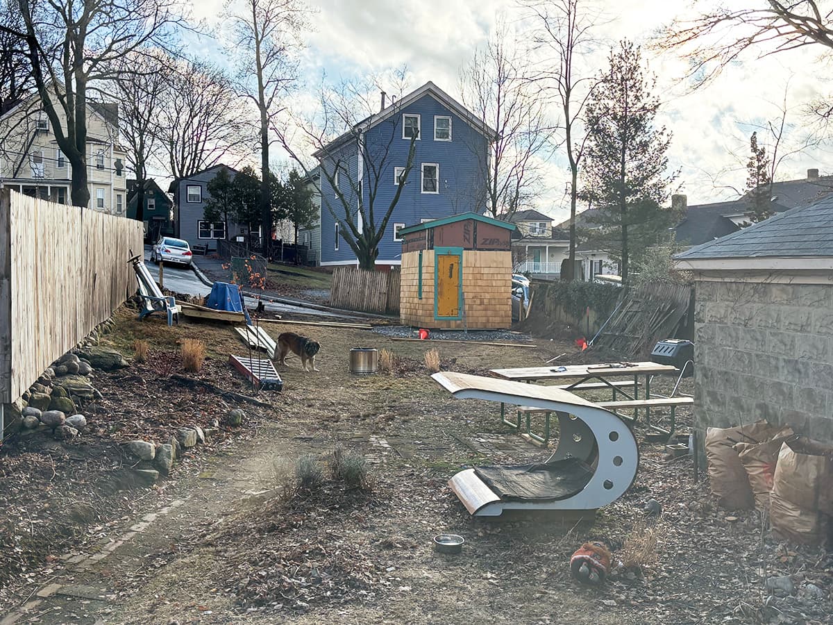

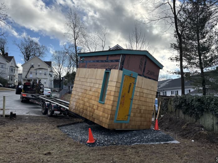

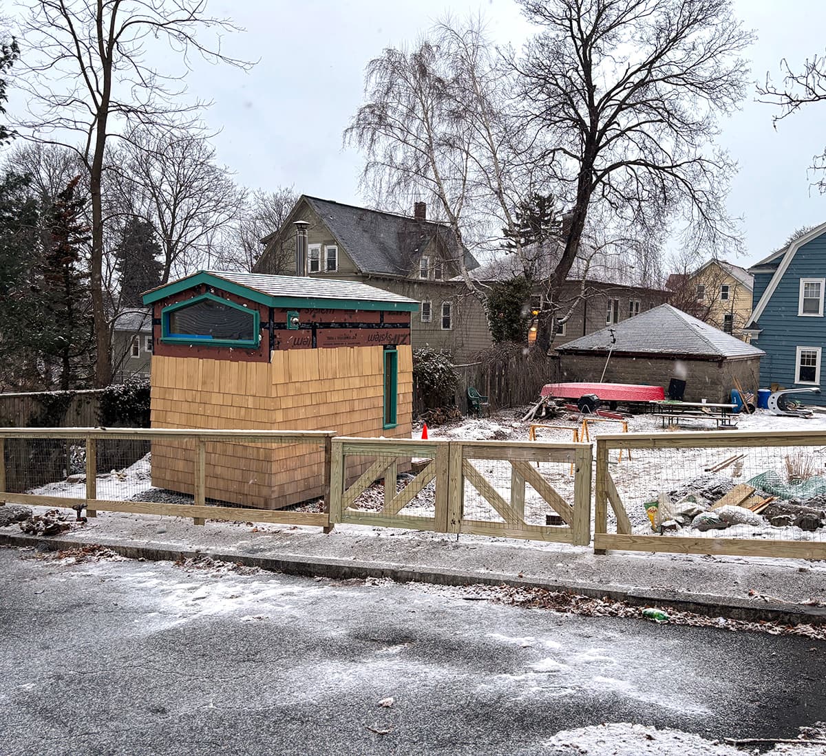

Small update on this.
Sauna was moved from Long Island to Providence, Rhode Island at the beginning of 2025 by a rockstar shed moving crew. After dealing with i95 they had to contend with a pretty steep diagonal incline on arrival . Their trailer could gyrate at all angles and had a second set of wheels that lowered hydraulically allowing it to move left/right. They tucked the sauna into a tight corner of the plot. This was a very cool experience. I would definitely recommend building on a heavy duty sled foundation to anyone who might be thing of moving a small building down the line! The move cost under 2k.
Unfortunately, someone in the family got DOGE(d) in March so we had to self-deport to Denmark…where there are definitely no saunas :smiling_face_with_sunglasses: . Hopefully, we can come back to this!
