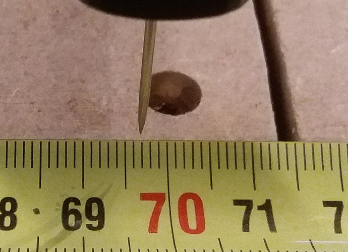

So my first idea was that the axis position accuracy might be bad.
I inserted a needle as tool and placed a tape measure along y.
1st test: position accuracy exactly where I milled the squares with a step of 30mm:
[attachment file=98864]
[attachment file=98865]
With this approach, one can easily ‘see’ deviations of about 0.1mm or even better. We would expect 0.4 - 0.5 mm, so this should be obvious. However, position accuracy is good.
Then I tested along the complete Y axis
([attachment file=98866]
[attachment file=98867]
127 - 697 mm = 570mm which is exactly my Y width.
From the second image one could estimate that it might be about 0.1mm off (shorter), which is good i think.

The needle test shows about 1mm less actual travel on 800mm.
Yes, one side is long, but I replaced them by metal wires. The X was really a bit loose, so I added some tension. Needle test not much better.

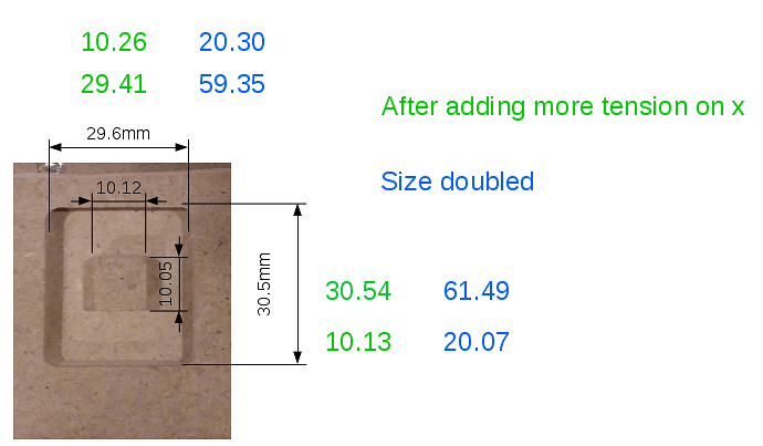

I then milled another test and a double sized test. Here are the results:
[attachment file=98918]
same sized square: numbers in green: effect worse - I would not have expected that.
Double sized: in X error gets a bit larger, but much less than doubled. Y: for the outer square I see a huge (triple) error.
I’m clueless

There is nothing consistent about your numbers, nothing that can be fixed until those stabilize, at double the size some of your tolerances got better. I can only suspect you have a large build or your gcode is not correct.
Again, pictures would really speed up this process, guessing take forever.
I was also thinking it could be nothing consistent in the mechanics as the effects are opposed (in x/y and outer inner).

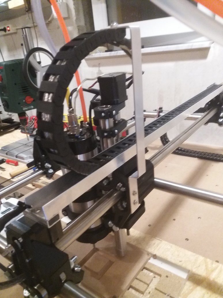

  • provide some pictures (my builds is this one, however the picture still shows the first setup with the long plastic cable ties)
Well you have a very large/heavy spindle, and a gantry cable chain on a very long lever arm connected above the Z axis, and it is a pretty large/tall build. That lever arm is working against the axis you are having the most trouble with and would explain non consistent error on only one axis.
I think some of these numbers can get a bit better but a shorter build will help for sure.

First you ‘main point’:
you have a gantry cable chain on a very long lever arm connected above the Z axis
I was following the advices regarding not to connect the cable chain etc. on the Z axis. In fact it is NOT as far as I understand the situation. Here is a more detailed image:[attachment file=99150] The drag chain rail is connected to the x-steppers, the aluminum harm is connected to the middle part; by this, thecables leaving the cable chain and going to the z axis (stepper and spindle) are 'static' viewed from the z axis (the cable chain movesand the middle part connected aluminum arm hold them in place).
Is this still problematic? I can not think of a better solution.

Yes, it is above your Z axis, it is almost as bad, in this case it is so tall I would easily say it is worse. Torque multiplier.
I don't understand this. The arm is connected to the middle part, not to the z axis. In fact I have nothing connected to the z axis except the necessary cables which however are not moving when the machine is moving and they do not induce any force on the z axis (the force enters - via the arm - into the middle part)
How else could one get the wires force-less to the z axis?
Just my opinion, I use wires from the Z to the Middle, then the middle to the roller in a loom, not cable chain.
Most people do not care about 0.3mm in wood, you do so I am trying to point out all the possibilities. A bar that long is acting as a torque multiplier, any drag induced is multiplied linearly to your gantry. Is you issue happening on that axis? No pictures to reference with your cut so I can only guess. If that is not it, try cutting your entire machine down to 3" Z, or each axis shorter in general. Like I said you have a large machine, that is tall, with a giant spindle, using cable chains, all of which can be working against you with tolerances you are wanting.
OK, no offence meant, I appreciate your help! It was just that I did not get it.
You say: the cable chain has drag and the arm sclaes up that drag against the mid part when moving (in this case the Y axis should be affected - right?)
