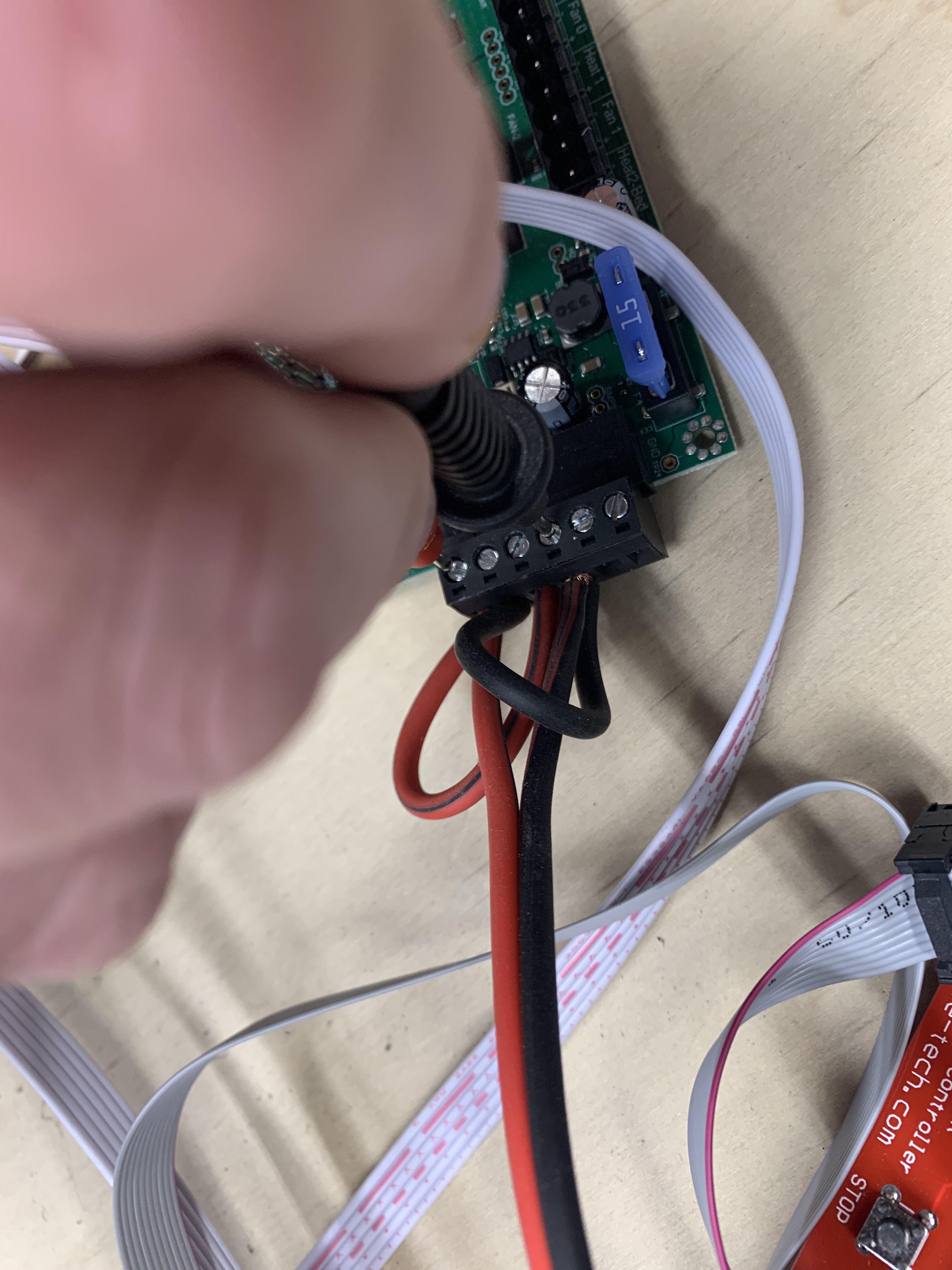

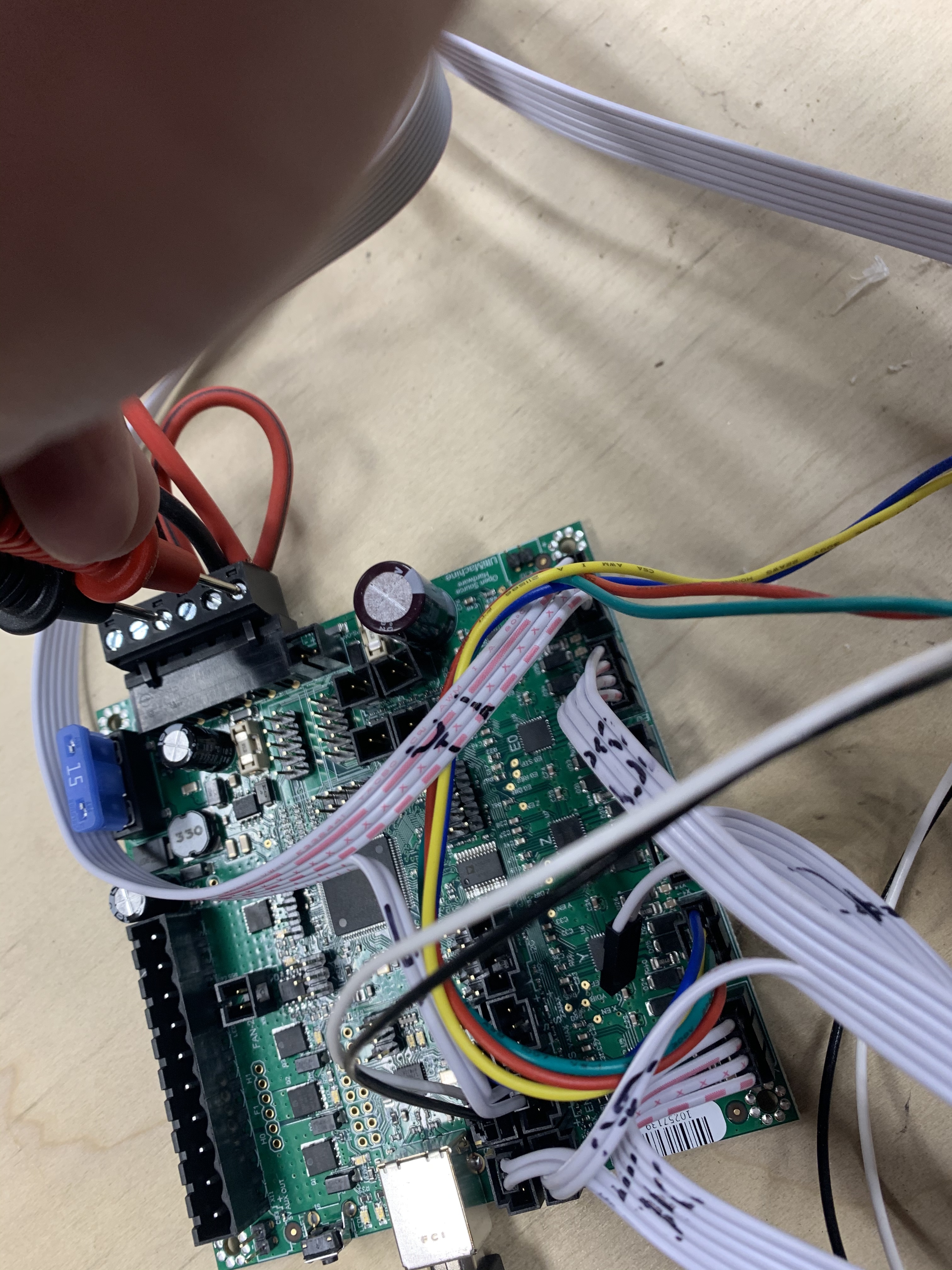

I wired it up according to the diagrams. Pics. Below. No power to the lcd. No power to the indicator lights on the board.

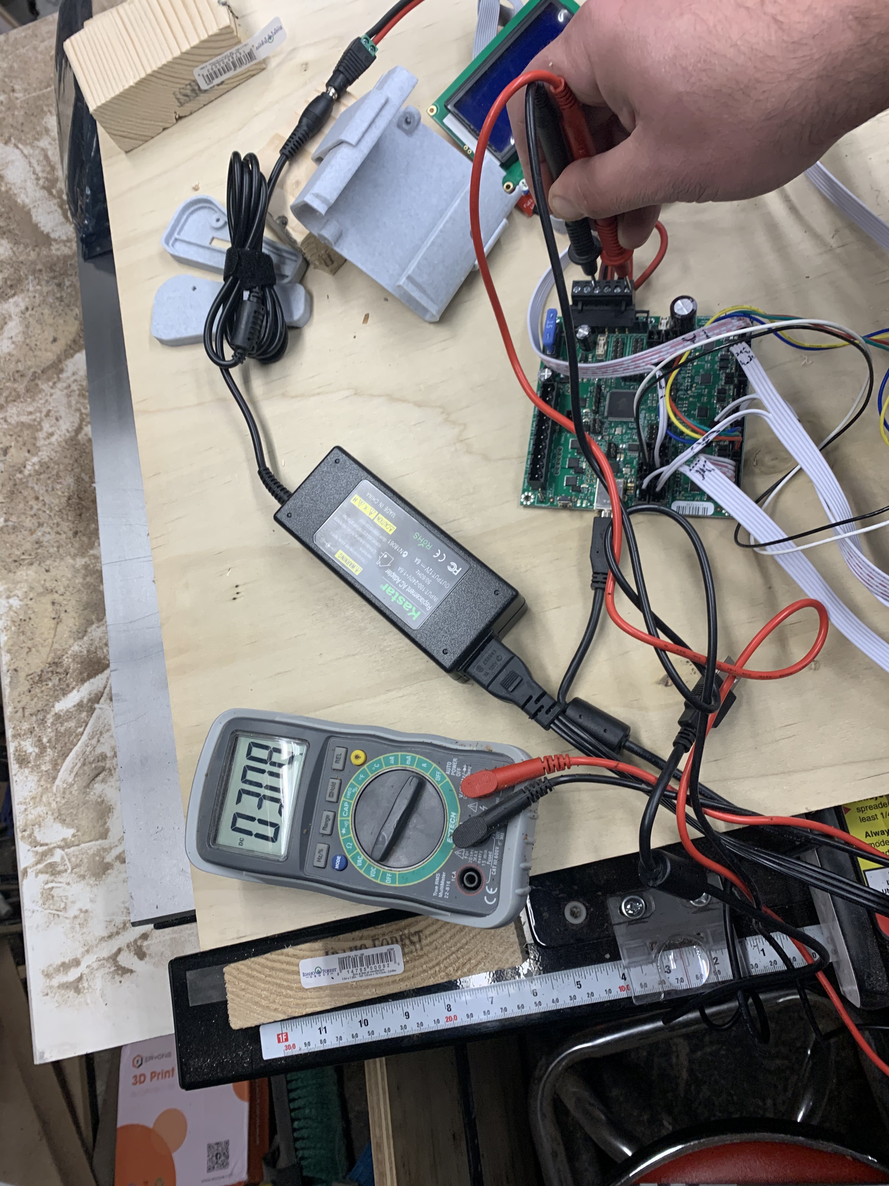

12 volt, 3 amps are coming out of the power supply into the board. I can measure 12 volts across any of the terminals and from the fuse to the black.
Maybe someone can spot what’s wron in my photos.

It may be a trick of the lighting, but it looks like your fuse isn’t seated all the way. Might be worth pulling it, checking to make sure it isn’t blown, and reseating.
Thank you for looking at the photos in detail
I did check both contacts on the top of the fuse and both sides of the fuse read 12 volts. It would be quite a fluke for the fuse to see 12 volts on both terminals and have something else wrong.

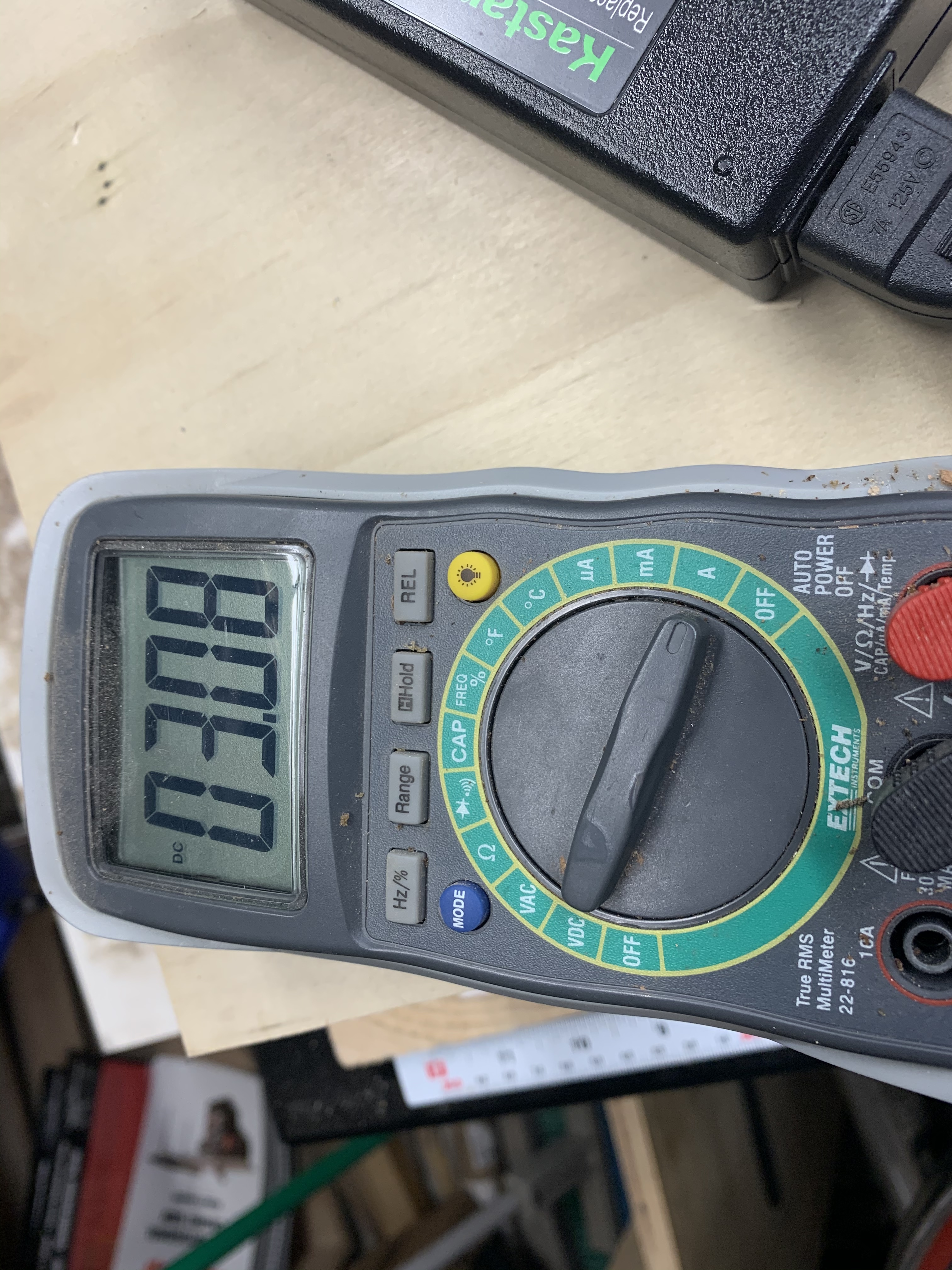

Thank you to everyone who looked and took the time to read this. As I mill this over, and I have been all night, I think the biggest problem is that my power brick is putting out 12 amps 3 volts and the board needs atleast 12 amps 5 volts.

What you are doing in that picture will not actually read Amps. You need to hook it up inline, not just passively and then swap you red probe to the amp slot.
At that point what you are reading is how many amps the board is drawing, not how much the PS has. There is not non-destructive Amp test. You need to run them for a significant amount of time with a calibrated Amp drawing load and see it melts down or not.

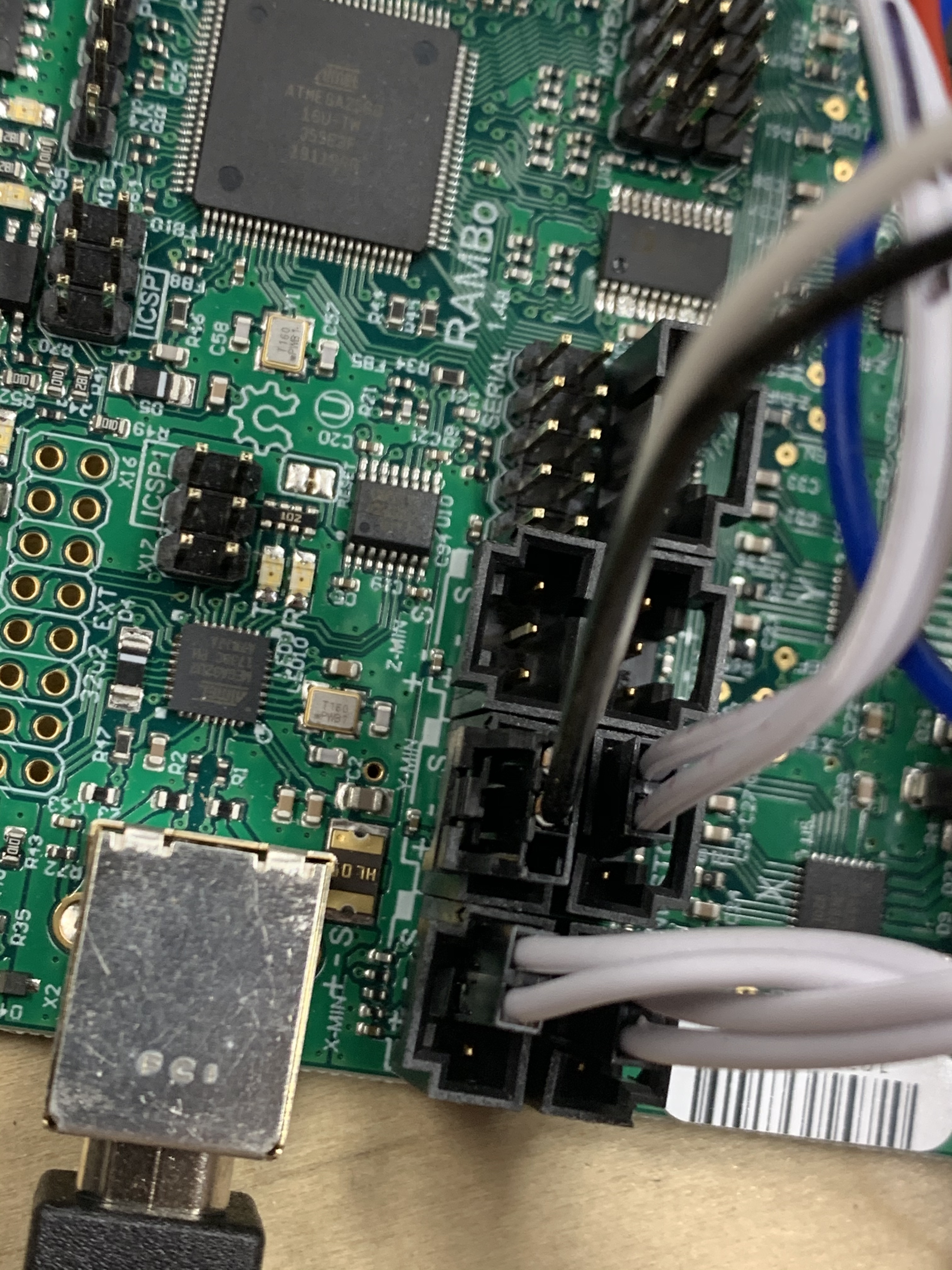

Unfortunately from what I can see you have plugged your endstops into the wrong ports and Hopefully only blown a fuse. I see you have half of them in (+ & -), they go it (- & S). You have created a direct short I don’t know if that blows a fuse or pops the board, or maybe just the endstop ports.
You can test the little fuses by pulling them out of the board and doing a resistance test. with your meter.

Here is a closeup if the board. Nothing has been unplugged since the previous photos. The + channels are empty.
Look closely at the labels on the board, those plugs are back to back so the ports are mirrored.
Oh. Ok. Thanks again for the support.
From this diagram, it looks like both of you Min Endstops are wired right, but both of your Max Endstops are wired to +.
Thanks. I understood Ryan’s comment, but feel like a bit of a dunce. Hopefully this is my worst mistake.
No worries we all screw up. I just hope it is just a fuse.
Ok. All I did was fix the endstops and I am up and running. I only had time to move each axis, but all the steppers work.
