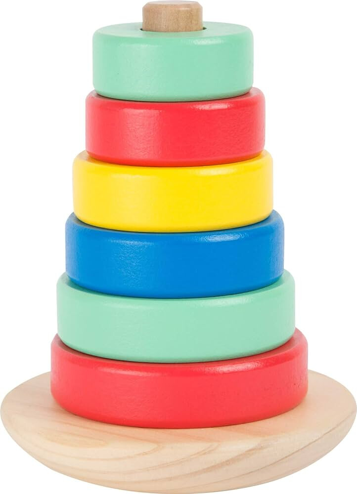

I was hoping this topic would be about the trade offs between cutting holes and combining layers vs pockets. I always like the idea of building layers for projects instead of big pockets.
Not sure what you are saying about layers and holes… intrigued :thinking:
I’m assuming like this.
You create multiple pockets that are smaller, then stack them together and glue. You get two advantages 1/ Your pockets are shallower so your bit can be shorter 2/ you can do undercuts like in the example image. You wouldn’t be able to mill that with our machines in one piece (not a challenge)
I have done 3D as 2 sided cuts that is a similar to that just i think of it as sliced so just semantics :+1::heart_eyes:
