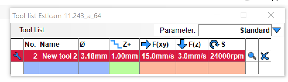

Hey everybody. I just got done with my MPCNC build and I’m working on plotting with Estlcam to get used to how the machine works. When I run the sample crown gcode it works great, but if I follow the instructions on the getting started section and try to run my own crown gcode it starts to move the pen and then stops. When I compare the gcode I see some differences but I’m not sure what may be different due to different versions of Estlcam and what may be wrong with mine. Any help would be greatly appreciated.

You’ve got the feed rate set to 180mm/min. That means 3mm/second, which is very slow. It’s not stopping, it’s just moving very slowly.
Check that your feed rates are set up to mm/min in the basic settings, and that your tool speed is reasonable.
Those are my tool settings. I believe the 3mm/s is the Z feed setting. I have the xy feed set to 15mm/s. The basic settings are set to mm/min as well.
I must have messed up my tool setting somehow. I deleted Estlcam and reinstalled it and set up my tool again and now it is working correctly. Thanks for the help.
