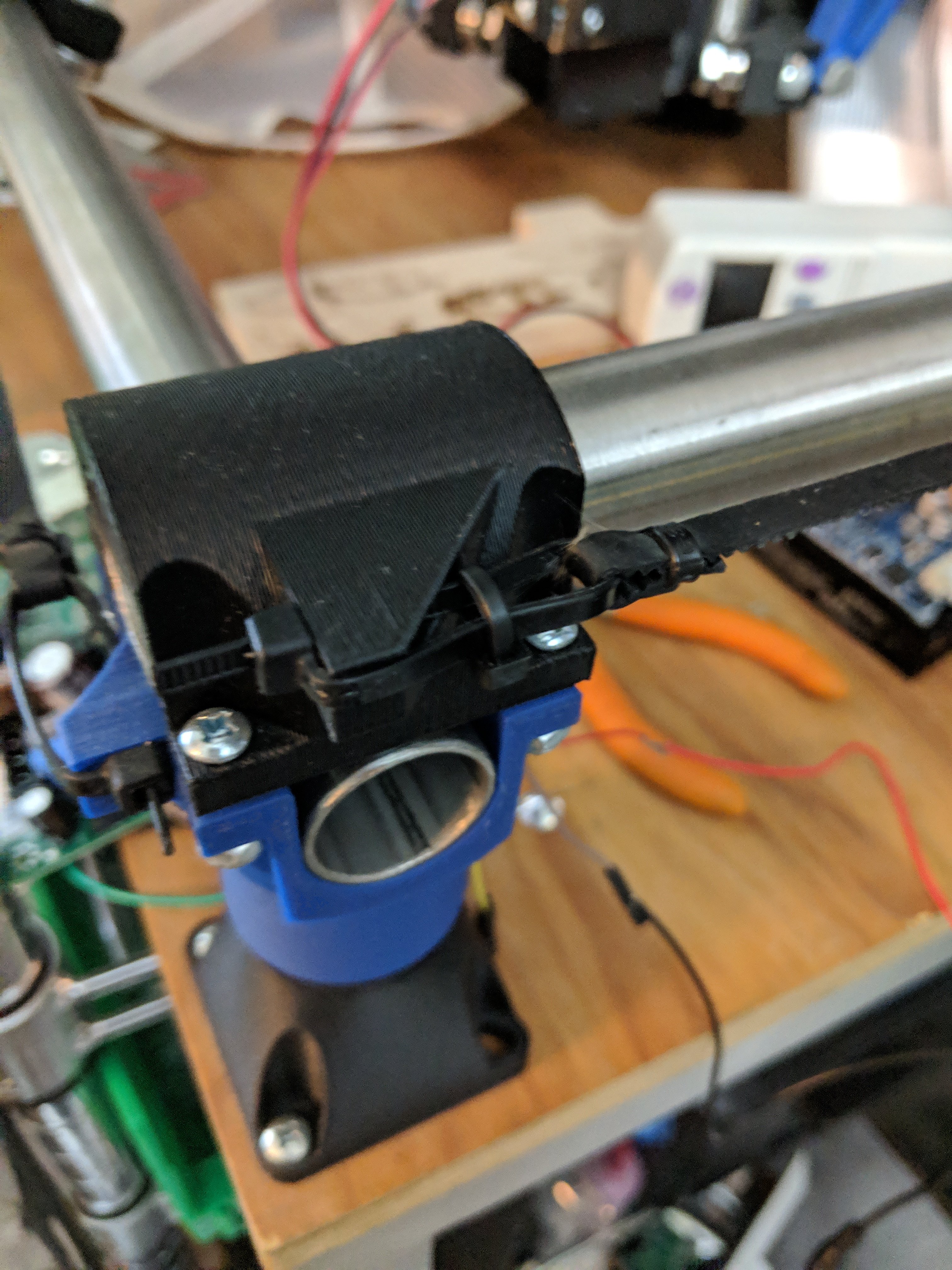

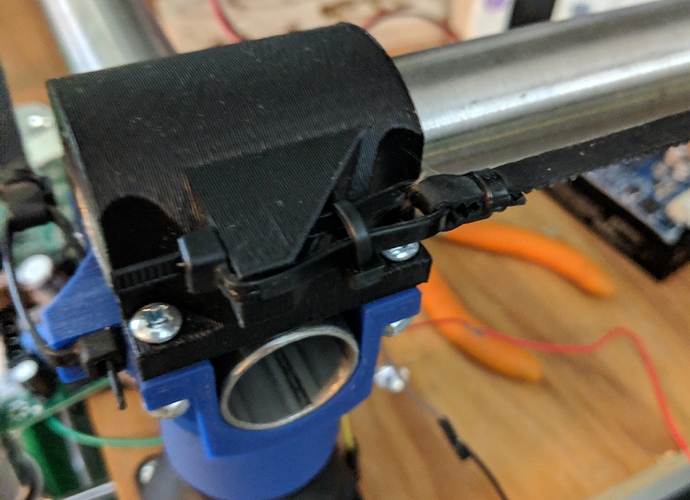

Have you tried this with your beefy (looks since you don’t have specs) Zipties.
[attachment file=89581]
This prevents any springiness from a loop on an large cable tie.
Yes it returns. It’s definitely not backlash.

I did not try that. That makes sense that it would really help. I didn’t have any of your zip ties left at the time with the yellow one, way beefier than the ones in the kit.

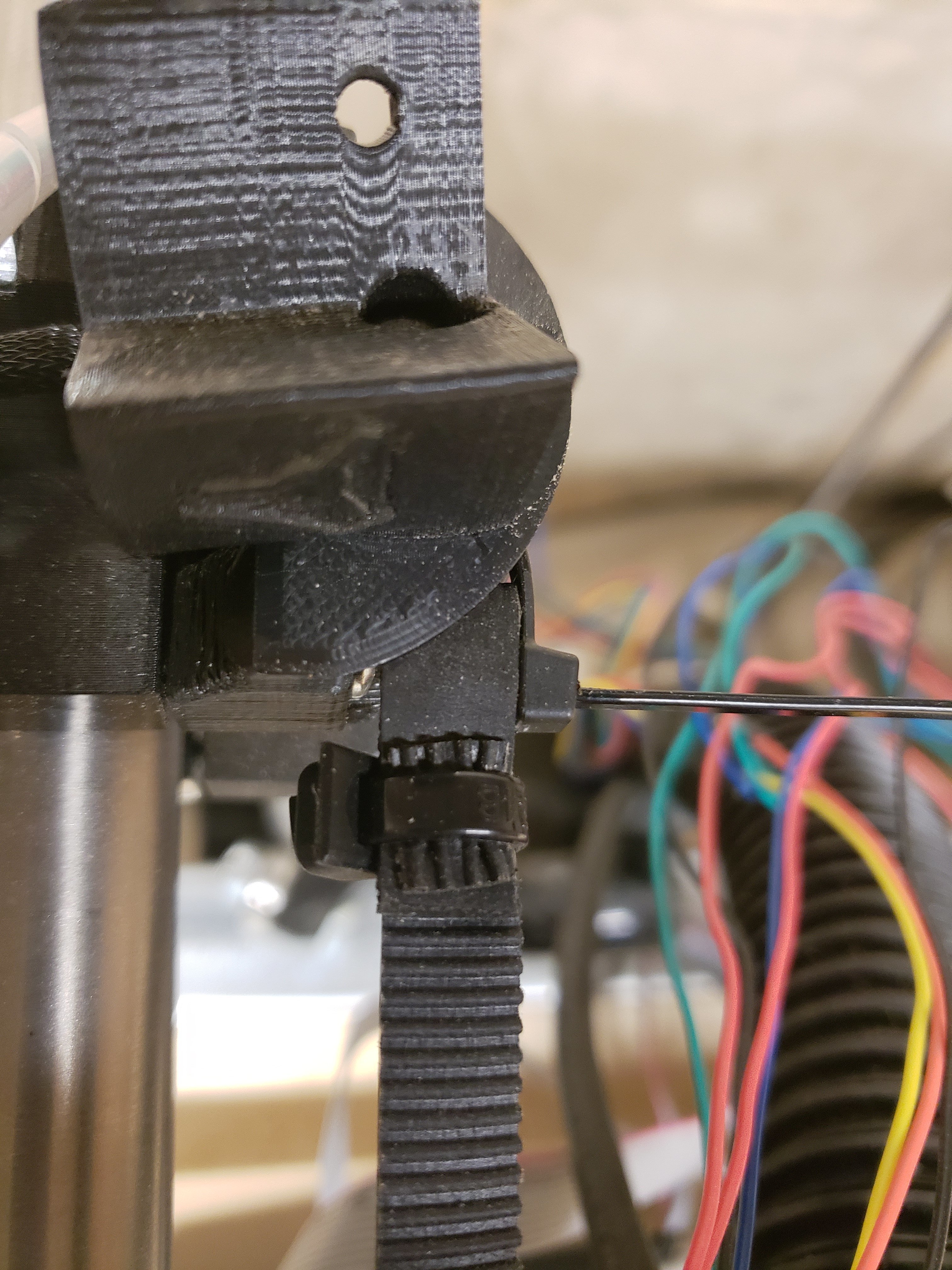

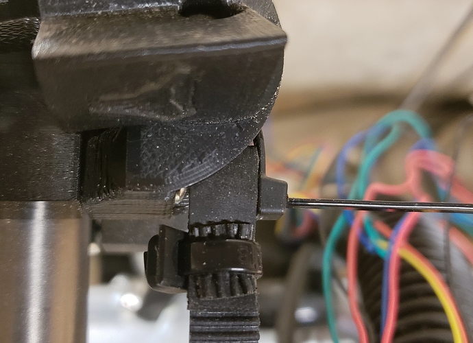

The numbers I have presented now are from the end with the zip tie tightened all the way with the looped belt pressed tight against the printed part and with the little 3d printed plastic in use just like your instructions. I thought that end would be much better but that is what I have tested now, and it’s using the cable tie from your shop and kit. It still has all that flex. Left side is that cable tie, right side is clamped as the picture showed. That side has no springyness left that I could detect at all.
I don’t think having both types of connection at the same time one in each end makes it difference, it just let’s one direction I push test one connection for flex, and then the other direction test the other connection. Clamp has .5mm (which appears to only be at the stepper pully) zip tieall the way snug has 1.3. I presume .5 is stepper, .7 is from ziptie.
I can’t try that extra zip tie as it is since it’s all the way tight. If you think it would be better to leave space and add that extra zip tie around the loop to compress it more ‘rectsngular’ I am happy to test that for you. But I doubt that it would be an improvement from cinched right down. The belt loop could also be adding flex maybe as well?
My current opinion is that the clamping is so easy and removes any possible locations of flex it’s ideal.
Also, the zip tie layout on mpcnc seems different than the Lowrider. Could that difference account for what I am seeing?
= spring.
No I have severely optimized the low rider cable tie path, no hard corners. That will be in the next MPCNC update.

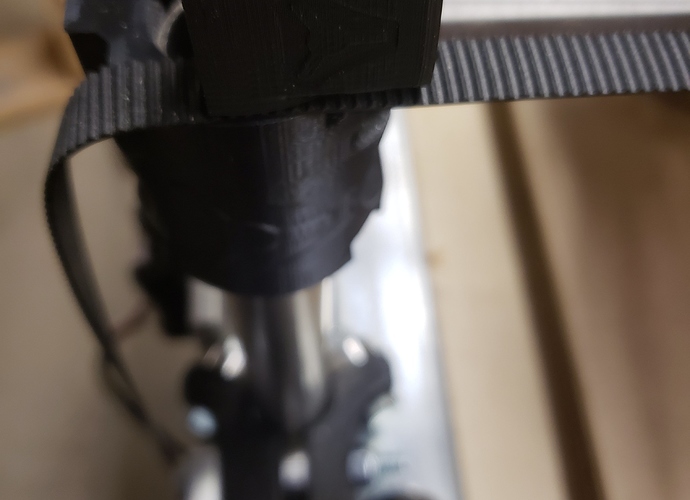

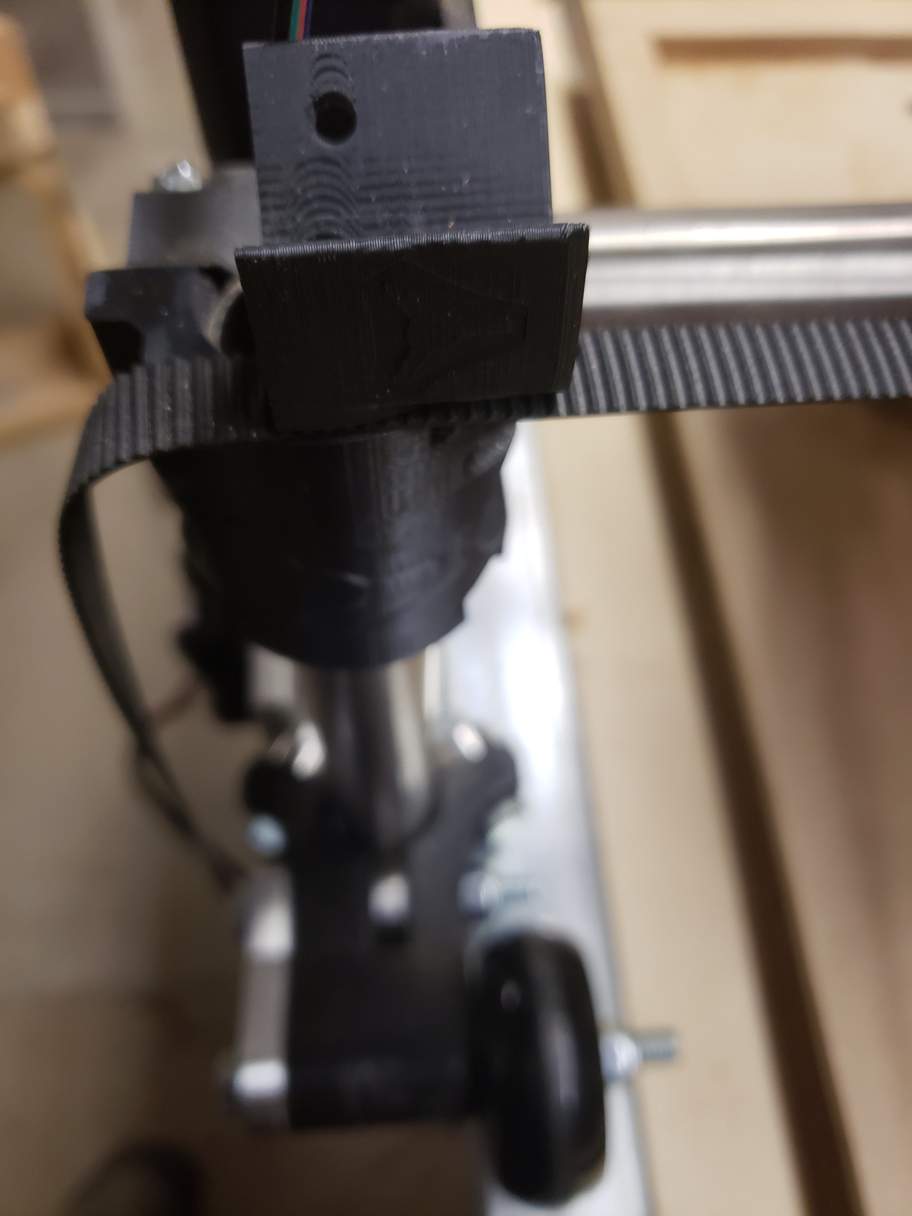

So I just went out to the shop to take a couple quick pictures, don't have time for anything else today in there, but the stepper shaft was not rotating at all now with a quick check. That is inline with what I originally thought should be the case. Everything was cold though. The other tests were done after it was running and the stepper drivers were hot. I would not think that would do it, but I would not knowm anyone able to chime in?
However. The zip tie vs clamp still showed the significant difference. I don't know if it is visible in this video, I took a quick one to try. Also a pic of each end of the belt.
When load is away from ziptie, the other side of the belt goes very noticeably slack (when you can see the whole belt). When the load is the other direction straining the clamped side the belt stays taught. But I need to set up the dial indicator and strain gauge again for more precision measurements.
