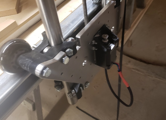

I still have to out some of it back together as I was putting on new y plates milled from aluminum. I still have to reattach the y belts and just printed some new brackets to attach to the y plate to hold the LCD and mini Rambo.
The aluminum plate stopped the flex.by the skateboard wheels. May not matter but they look good and it was some machining experience on my friends Tormach CNC mill.
Added a bunch of tapped mount holes for any potential total future use as I can’t just screw into it like I could with MDF.

Thanks. I’m lucky to have a friend with a very expensive since CNC mill as a hobby toy that I have access to and he helps make parts. My 611 plate is now aluminum also. I did think to add threaded holes to it sadly. (Made that first) so I’ll have to take it off at some point and do some more work. Also want to thread all the holes so there would be nothing extruding on the bottom of the plate if so cut bolts to length. I’m really happy with the y plates so far.

Those aluminum plates are really awesome.
