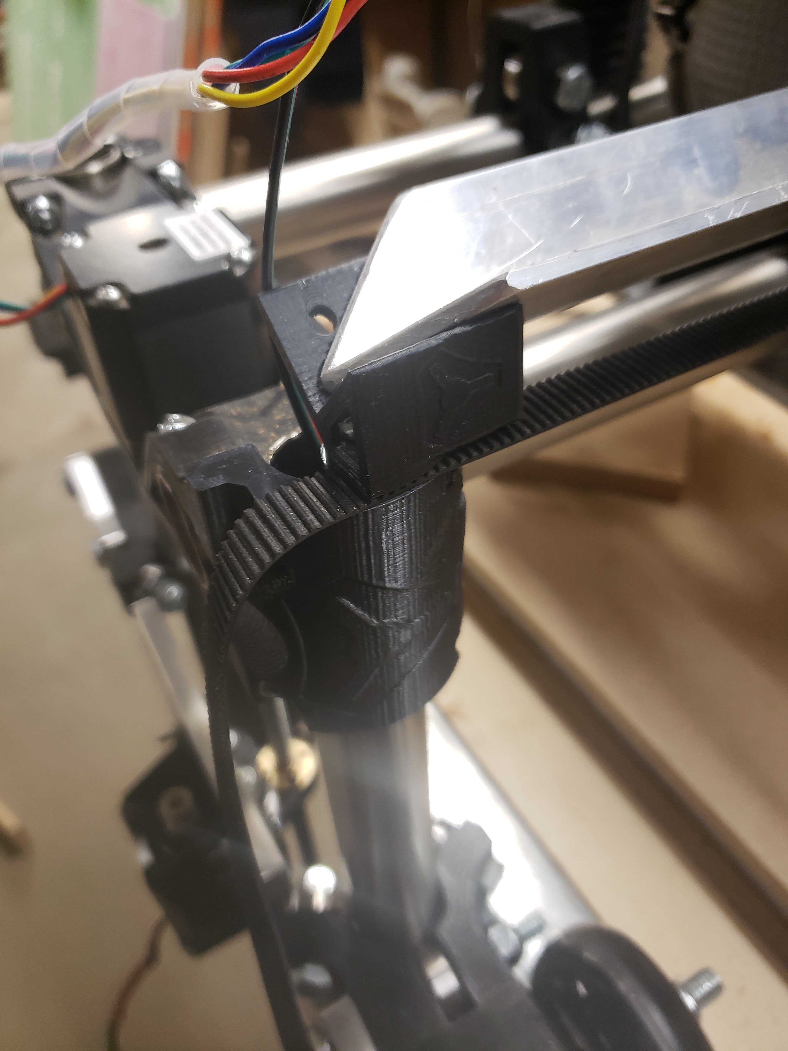

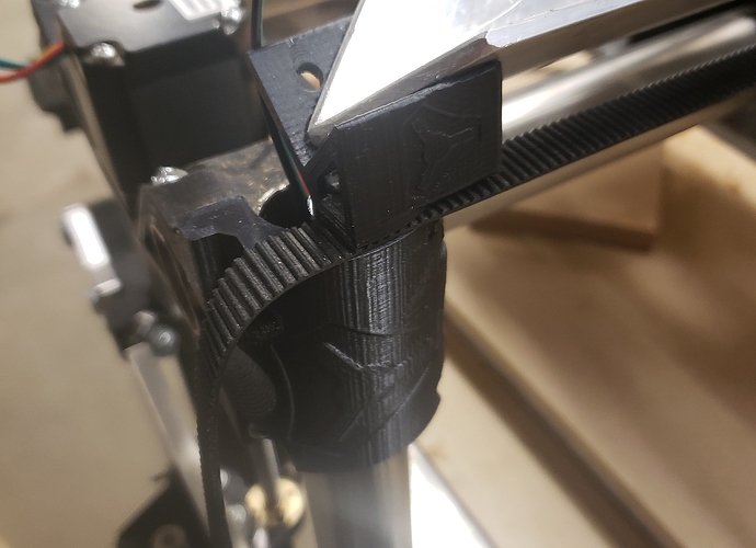

I had posted about flex in my x axis for my Lowrider v2 recently. I could see a lot of it was coming from the way my belt was zip tied on. Ryan pointed out the gap I had. I purchased more GT2 belt to be able to make it long enough to go right snug against the 3d printed part as was recommended.
I did some testing with a digital scale and dial indicator. What I found was with the steppers locked. I could easily flex the 611 plate on the x axis.
I tested with the existing setup, and then with the newly installed gt2. The results were essentially the same. Using an scale I could see that to either direction I had 1.3mm of play with only 1kg of force for a total of 2.6mm. There was still visible plat at the end of the belt where secured with the zip tie very snugly right against the plastic mount.
So I tried removing that connection and clamped the belt down under the aluminum angle bracket. That reduced the play to .5mm. To me that seems like a significant difference. Increasing the tension to 8kg only changed the play to .6mm so I’m really pleased with that. I would like to redesign the one part to be able to clamp the belt. I’ll attach a picture of what I did for a quick test.
The remainder of the play is actually coming from the stepper rotating a bit when the 1kg load was applied. The stepper does that have enough holding power to prevent any movement. I have some 92oz steppers so I tried one of those and had the same result. Looks like a NEMA 17 can’t hold firm enough to prevent rotation, but the small belt change removed a large percentage of the play.
Thoughts?

Well the 1.3mm in each direction was because of zip tie mounting. Even really tightly zipped right against the gantry has flex. Clamping the belt reduced it to .5mm
The two of us measured several times with the same result. .5mm flex at a couple pounds pressure and then up to 19 pounds before the stepper let go it would go to .6mm so very little more with a lot of force. When removing the force it would return almost back to where it was. (Off but about .03mm) which would be from some other little bit of flex.
I’m feeling very confident the zip tie change makes a big difference. I don’t understand the stepper rotation and return though. We thought maybe the mount was flexing, but we could both clearly see the rotation of the amount required for .5mm
I’d really like to know if anyone else can just grab the x tube with the stepper locked on and press with your thumb on the 611 plate and see if your stepper has some give also without letting go. .5mm doesn’t mean a lot of rotation but two of us checked and saw the same thing.

1- Are you using my little tiny plastic inserts on the belts? These were designed to not let the belt collapse on itself.
2-How about a video of your zipties flexing? There are some tricks to make it better but mine in no way moves that much with 1kg at the endmills tip. That force is divided between both sides so each belt/ziptie only sees 0.5kg. I have a scale and have done testing on my smaller belt and tiny zip ties on my MPCNC and I had to pull a significant amount of weight to deflect it (there is a post here with real numbers somewhere).
In use my Lowrider with very little concern for perfection in assembly (trying to replicate a new user) is giving me un-measurable tolerances over 13" (LowRider parts) with a tape measure, most certainly less than 2.6mm.
3-Where is your other thread with all your pictures so I don;t have to ask for them again? Your numbers seems very extreme to me. If this is true I need to stop selling machines until this is fixed. So I am taking this seriously, 2.6mm is extremely unusable.

I see the yellow zipties you have but not the Y axis ones. What rating are the ones you are using? I see one side has a littel slack is the other completely snug?
Yes, I am using the plastic insert. That was a brilliant idea. Without it would not work nearly as well as it does I’m sure.
Since the first pictures I ordered new belts and zipties from you so I was using only your parts as I had run out of your zip ties. I had space but when I redid it I had the one side tight right against with no space tightened as much as I could with pliers without snapping it. The tension is not evenly devided when there is force from the bit .the bit force if going straight in the x axis + or - is applied to the one side.
I could see this because I initially left one side zip tied really tight with no space and then clamped the other side simply by putting it under the aluminum angle bracket and tightening the bolt down as in the pictures then when I tested pulling away from zip tied side it moved 1.3mm (dial indicator accurate to .ooo5") and when pulling the other direction with a strain guage to measure weight vs movement it moved only .5mm away from the clamped side. And when we tried to find it we so zero movement of belt moving, only the stepper rotating slightly. But the belt was rock solid.
My table is full sheet. Although I don’t think that matters since there is no belt stretch in the measurement I’m taking. I’m happy to do any testing you want. I was thinking of modeling a new top piece to clamp the belt better as what I did would not last. I can get a pic of the one side that is still zip tied so you can see what I did. It’s using your zip ties and belt and the plastic bit to put in the zip tie. But the 30 second clasmp I did totally removed all that play. I would not say by any means you need to stop selling it. But to me it just seemed like a good modification that is not costly or a lot of work.
That’s why I’m hoping someone else can check this on their Lowrider and see if mine is somehow acting differently for some reason I’m not seeing.
