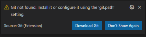

I am using the build tool as shown below
Could this be the issue…
Yeah. That could be it. Install whatever it asks you to.
Just managed a successful build on a clean install of VS on a separate laptop…it was also asking for Git to be Downloaded but the build was successful without it.
