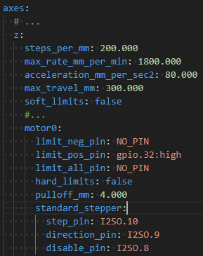

So that is basically what I did. But this is my first time using fluid nc so I’m not sure if I’m modifying the config correctly. I download the config open in notepad make changes save it. Upload firmware type in config name and reset firmware… I’m setting indent errors for everything
Ah, ok. Yaml files are extremely sensitive to spacing, even outside of FluidNC. If anything is slightly off, it will yell at you. The indent errors should point you at where it needs to be fixed.
Everything needs to be indented properly with 2 spaces per level. Don’t use tabs. If you upload your config.yaml file, I can take a look.
This is truncated but you can see the levels:
Thanks for that photo that’s very helpful! How do I get into the config file where it looks like that? I’m used to working with klipper on 3d printers but adjusting everything thru notepad has been a thorn in my side
It’s just that instead of Notepad to edit the file on my computer, I’m using Visual Studio Code. I highly recommend it.
Awesome I’ll download it and try it out. If I get time before bed I’ll run out and change my config will let you know for sure. If it doesn’t work I’ll upload my yaml. Thank you for your time

Everything is working except the z axis
You can either put it in a zip file or change the extension to .gcode or .nc to upload. I can take a look tomorrow.
Thanks for your time
I think you need to add :low to the end of each disable_pin. The config has a disable pin but the driver has an enable pin so that would invert it. For example:
disable_pin: I2SO.8:low
http://wiki.fluidnc.com/en/hardware/official/6_Pack_External#example-config-file
I don’t have the enable pins wired but I will try
