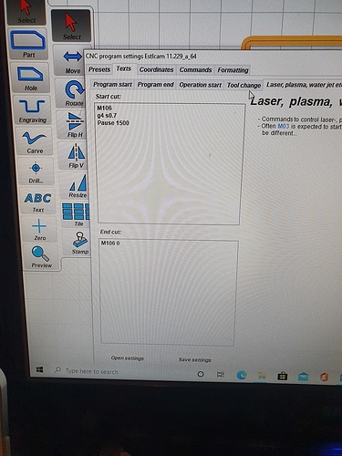

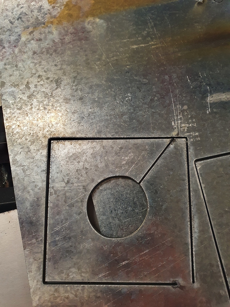

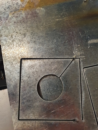

I’ve got it sort of working but its still not finishing the cut and the torch is not turning off between cuts. ive got a ssr relay in place to trigger the torch. ive tried changing the settings and what not but its still doing the same thing. do you know of any settings to try to get it working? I’m using estlcam any help would be much appreciated
cheers
There is an M400 command which might help. Especially when turning it off, put M400 above and it will finish the moves before executing M107.
I think the right way to do it is to set up M3/M5. Then the firmware has a clue what you are doing.
I think you End Cut command needs to be M107 instead of M106 S0
Your cuts look great. Makes me want to give my plasma cutter a try again

ok no worries il give them a try. im using the mini rambo board. ive got the trigger for the plasma hooked up to the fan port on the board. will m3/m5 work with this ?
thanks
I’ve tried the m107 to end the cut but it dose the same thing. thats just a old photo of when I was playing around with the settings.
Yes, you need to change the spindle laser pin to the fan pin in the pins file. You also need to enable the spindle pin. Them M3/M5 will work. I haven’t tried it in a few versions of Marlin.

But before you do that. Did you try just using M106/M107 commands with the M400 I suggested?
I would try this:
Start:
M106 S255
G4 S0.7
End:
M400
M107
Pay attention that all those commands need to be UPPER CASE.
The G4 is a 0.7 second pause. M400 will wait to run the M107 untill all the other commands have completed.
