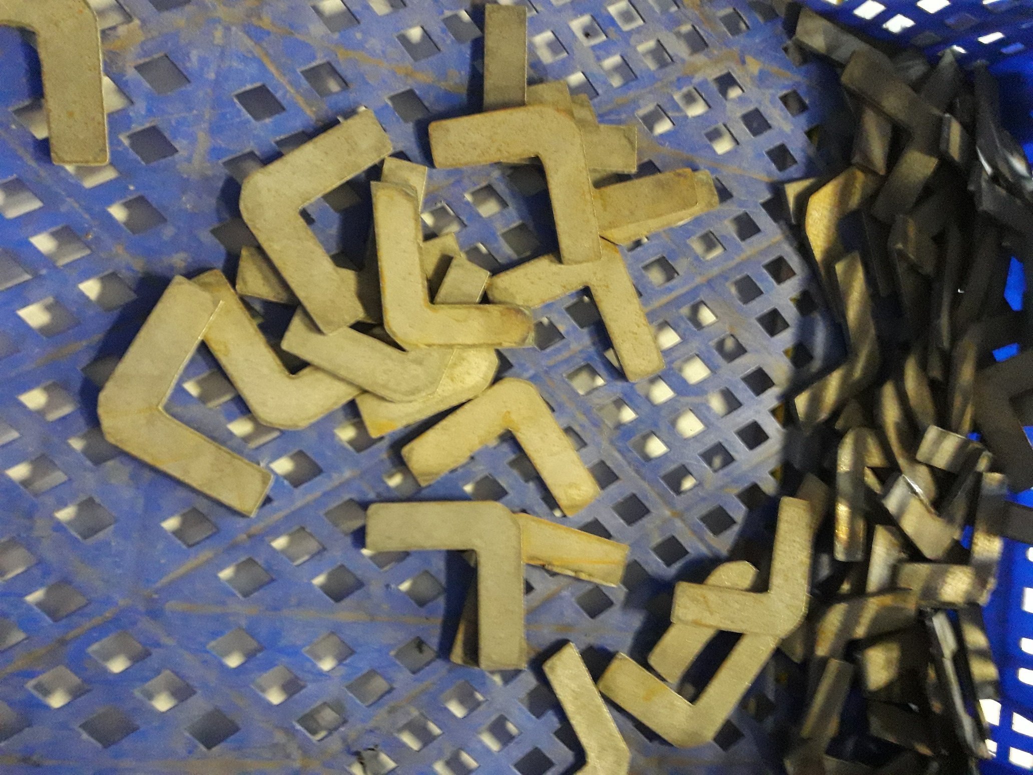

Some progress pics:
[attachment file=111589]
I quickly a tumbler out of a paint can on my lathe. Put some stone in it and let it run about 15min.
[attachment file=111587]
Parts come out very nice.
[attachment file=111588]
When the project is done and working well (easy, nice and quick) i definitely want to share it, so others can use my experience.
