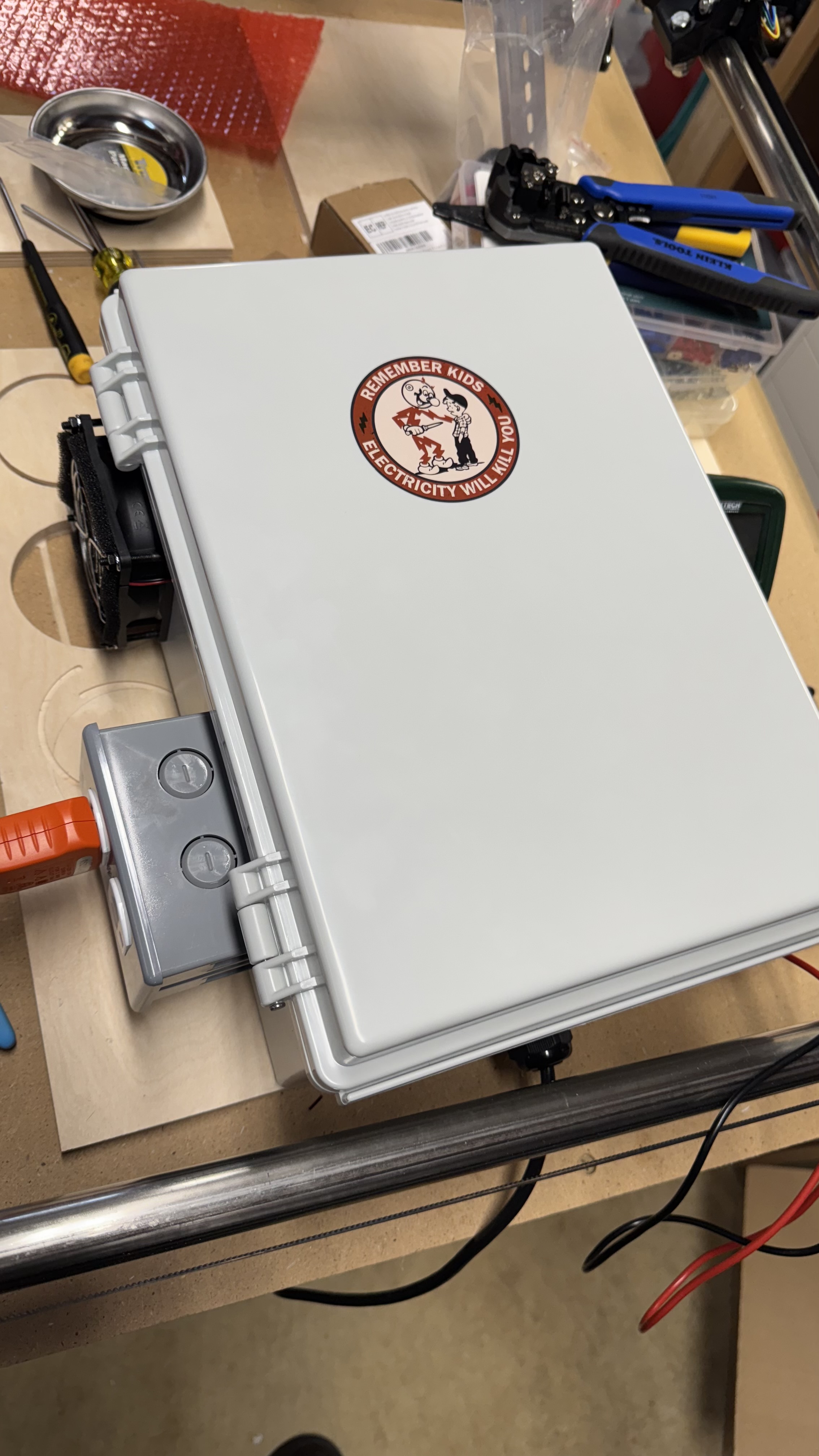

So I’ve finally gotten the wiring other than the steppers and endstops cleaned up, and added a heatsink for my SSR.
Unfortunately, it seems like my SSR may have failed at some point between when I last tested it, and presently, unless it was already failing and I just missed it somehow.
Essentially, when I turn on power at the external cutoff switch, power goes first to the WAGO connector block, and from there to the PSU and to the receptacle, with the hot line going through the high voltage side of the SSR. So without voltage on the LV side, no voltage should be present at the receptacle.
What is actually happening is that when I turn on power to the box, the PSU and Jackpot are powered normally, but I’m getting 85v at the receptacle. Not good.
I’ve tested with everything turned off, and I get no continuity across the HV terminals on the SSR, but as soon as I power things up, there’s only about 10 MOhm resistance, and 85v from the output of the SSR to either neutral or ground. This occurs even if I completely disconnect the LV side, so I am pretty sure it’s the SSR. With no voltage on the LV side, the LED on the SSR is dark, but still passes 85v. If I turn on the Jackpot pin that I set this up on, the LED comes on, and I get 120v at the receptacle.
Does this sound like a typical SSR failure (I know they fail open, but it’s weird to me that this one hasn’t really been stressed at all, and has failed without any external indication, no burning or melting or anything)?

The 85 VAC may be a clue. That would be about the voltage of half a cycle. Perhaps a bad SSR. But first lets check the 5 v source. When turned on do you measure +5 volts? If not then you may be pulling more current driving the SSR than the Jackpot can handle ( about 25 ma). If it measures 5 v,next is to make sure it is not in PWM mode. Or a more simple test use a seperate supply or battery to test it.

When I power on the Jackpot, the terminal (GPIO26) is at 0V DC across the positive and negative for that GPIO. Once I go into Fluid Web UI and activate GPIO26, the terminals read +5V.
I’m using the default firmware shipped from V1, and I’m pretty sure that defaults to HIGH/LOW for GPIO 26 and 27.
I’ve tested with the SSR completely disconnected from the Jackpot, but not using a separate power source.
Thing is, I don’t have any issues with the AC voltage from the SSR when the low side is activated. If I turn on GPIO26, and it sends +5V, the SSR opens up and supplies the full 120V. The issue is when no voltage is applied on the low side. Even with nothing connected on that side at all, I still get 85VAC from the SSR.
I suppose I could plug a lamp or some other load in that would be unlikely to be damaged by lower voltage, but I’m definitely not risking my Makita router on that test, though I don’t think the risk is high.
I usually use a low walt lamp or heating element
Winner winner, chicken dinner!
Plugged a lamp with a 60w light bulb into the receptacle, and no voltage when the GPIO is low. Switch the GPIO on and the lamp comes on.
Tested with my router and it works great. Thank you for the tip on SSRs needing a load.
Now I’m wondering whether I should add in a load resistor, or just rely on the router to provide the load.
Also guess I don’t need the replacement SSR I ordered…but I’ll hold onto it as a backup, in case this one really does fail.
