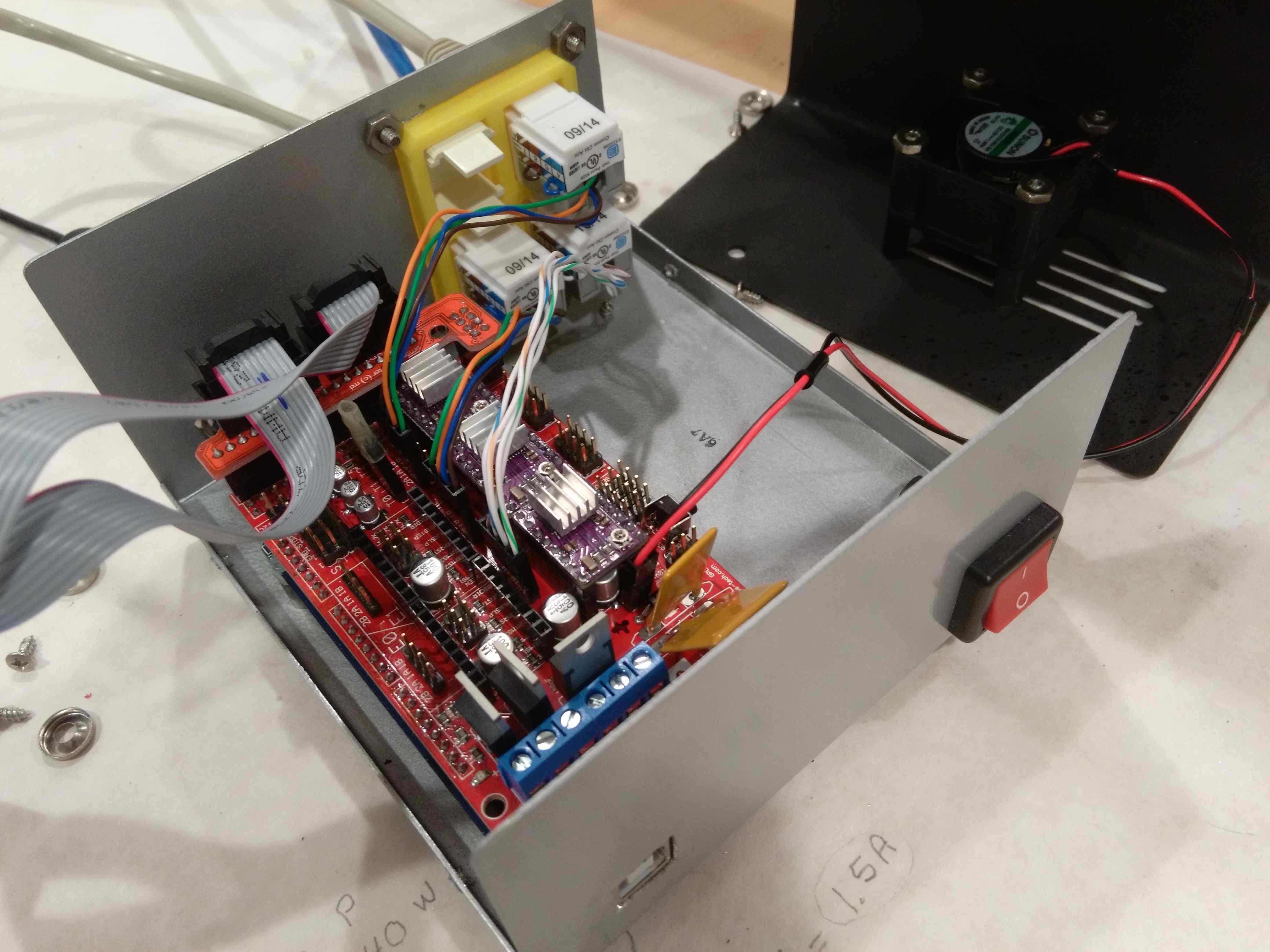

Stick it in a box with RJ45 sockets so it is easy to take apart and transport. I can fit all the electronics and cables in a small box, tie up center axis with a shoestring and stick in in my car. No problem bringing it is a Maker Faire. That is an old Radio Shack box I had laying around. I like that it is not bolted down so that I can reposition it.
Stick it in a box with RJ45 sockets so it is easy to take apart and transport. I can fit all the electronics and cables in a plastic bin, tie up center axis with a shoestring and stick in in my car. No problem bringing it to a Maker Faire. That is an old Radio Shack box that I had laying around. I like that it is not bolted down so that I can reposition it.

Nice, do you use network cable all the way to the stepper motors or only to the conduit entrance? I assume the latter but it is a bit difficult to tell. Think I want to setup something similar If I can find the necessary parts where I live.

Yes the network cable works great all the way. I did double up the conductors inside the cables but don’t think there is enough IR drop to make it necessary. For my 2’ x 3’ setup I really don’t need a drag chain. The cable does not seem to get in the way at all. I do have the router AC and vacuum hose hanging from a hook in the ceiling. Here is an old remix post of the setup http://www.thingiverse.com/thing:858155 . I did not post the files for the RJ45 panel mounts, let me know if you want them.

My psu and ramps box.
Ill go rj45 connectors aswell, if i can find those female connectors somewhere locally

I believe Home Depot has them. They are made by Ideal. If you buy a package of 10, they come with a small punch tool.
