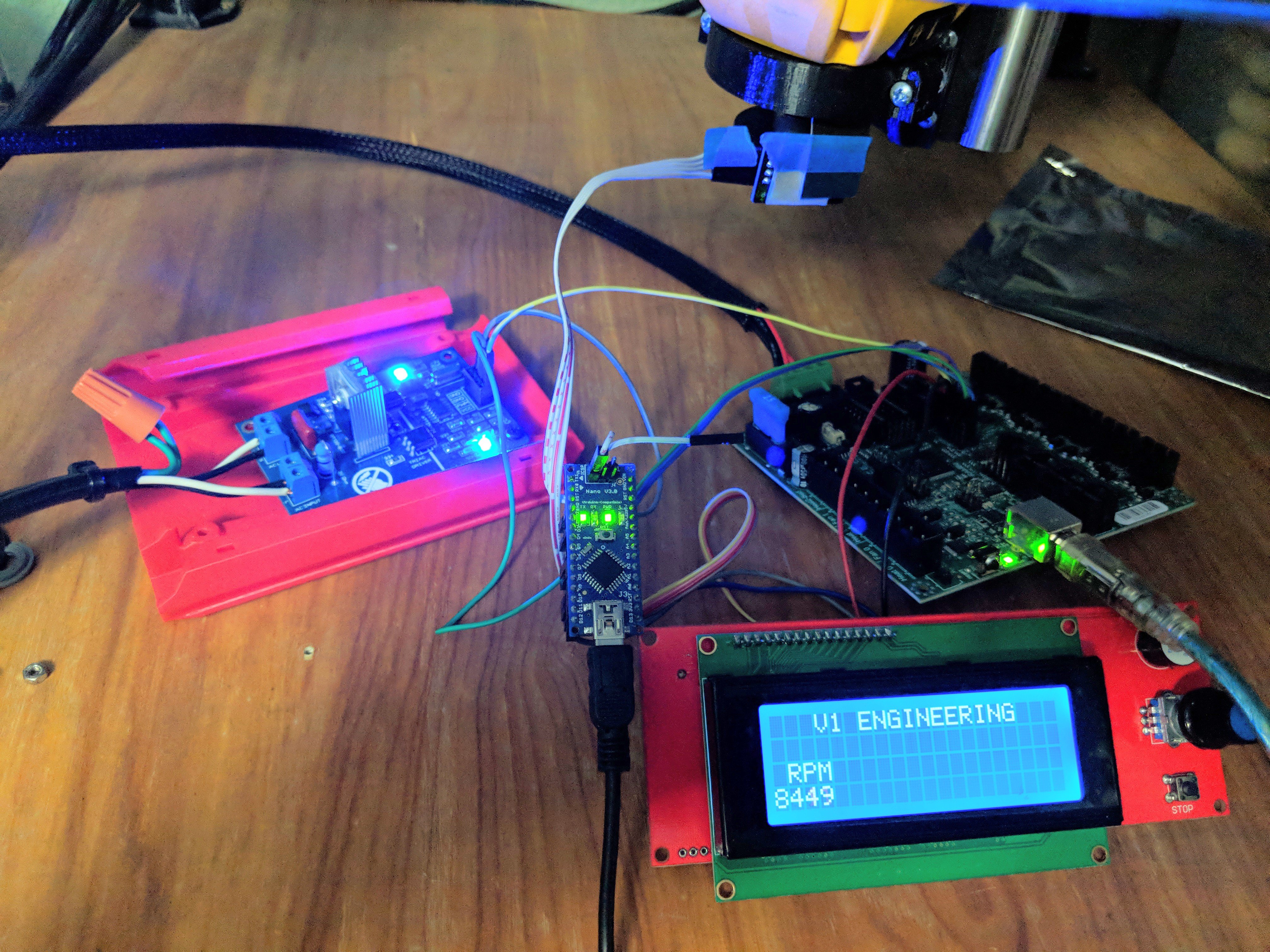

Proof I am making progress
[attachment file=58402]

Did some more digging. Seems the AC controllers PWM is valid between 20-240. I need to test this, the backup controller I have is only valid from 15-90…interesting. I have mapped the output to compensate.
Found another issue. The actual RPM all seem to be short by at least 50-100. The PWM timing must not start at 0 as the error is from the input PWM directly. But I have Marlin set to have a min value of 5000, so I will change it to test what rpm=1 gets me for a pwm.
Dammit, slope equation in marlin. So in steps of 118.4, explains why I was off in between those values 10,000 input gets rounded to 9945…
* The M3 & M4 commands use the following equation to convert PWM duty cycle to speed/power
SPEED/POWER = PWM duty cycle * SPEED_POWER_SLOPE + SPEED_POWER_INTERCEPT
* where PWM duty cycle varies from 0 to 255
set the following for your controller (ALL MUST BE SET)
#define SPEED_POWER_SLOPE 118.4
#define SPEED_POWER_INTERCEPT 0
#define SPEED_POWER_MIN 1
#define SPEED_POWER_MAX 30000
That makes sense. A short to ground looks like a pwm value of 0 and a short to hight looks like a pwm of 255, so by using a smaller ramge, you can have more confidence that the other side is still connected.
