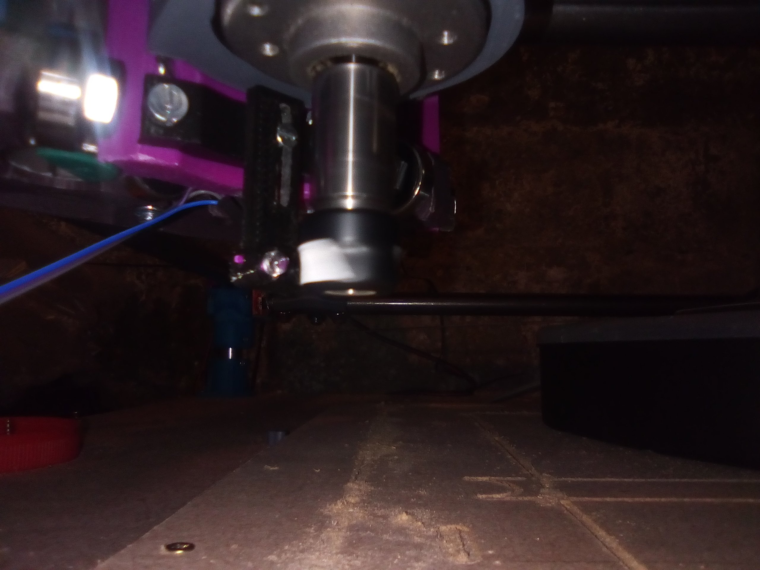

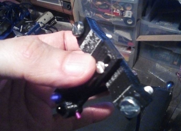

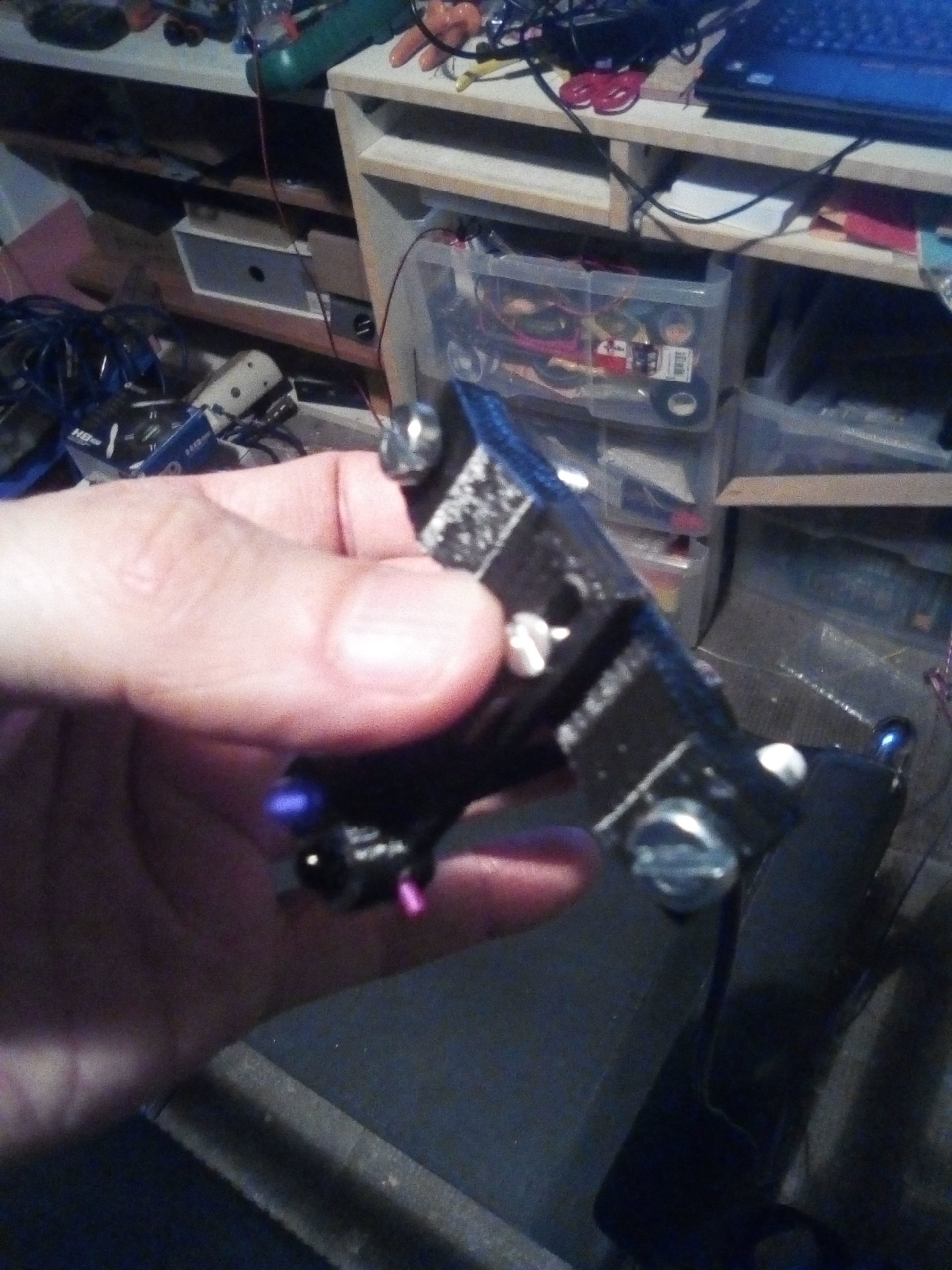

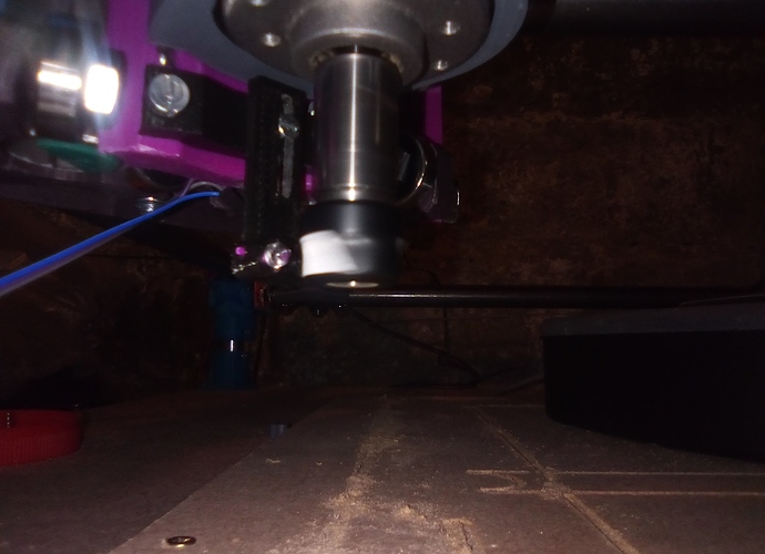

Oh, and here are two pictures of the sensor and the mount I “designed” for it under the spindle : first is “unmounted”, second is near the “spinning” collet.
[attachment file=“58241”]
[attachment file=“58242”]

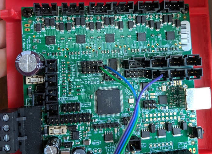

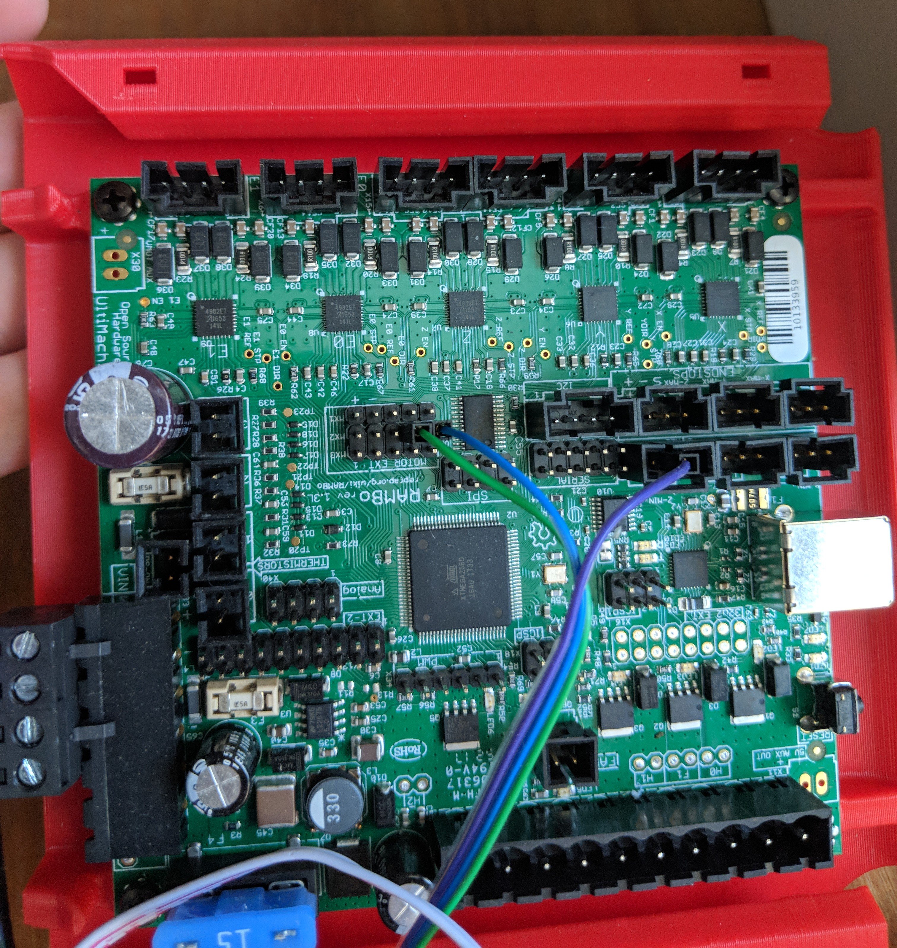

I would like to check with you before I go and start playing with the board that I am getting the correct pins. After going back threw the thread, I see that you are calling to use pins 45, 31, and 32.
Rambo pins-
#define SPINDLE_LASER_PWM_PIN 45 // MUST BE HARDWARE PWM
#define SPINDLE_LASER_ENABLE_PIN 31 // Pin should have a pullup!
#define SPINDLE_DIR_PIN 32
I then see that in the RAMNo manual on page 64 that Arduino digital pin 45 is PL4 and pin 31 is PC6 both on Motor extension MX2 (X31). The other pin Arduino digital pin 31 is PC5 and is on MX1 (X20). Is this correct or am I reading things wrong.
Thanks for the help.
My setup.
[attachment file=58324]
I had a second ground on the motor header…not sure why. You can use those three. I am flashing and plugging everything in again.
thesfreader Do you have some links to the hardware you are using for the leds and sensors, or are those the ones I linked? I am beginning to think smaller size or even surface mount would be a better idea if we are going to point it at the fan or inside at the shaft.

Actually, no, I used some from aliexpress. As for the type size/surface mount, it’ll prpobably depend on the router/spindle used. I’ll be happy with “my” solution at first, but I suppose on the Dewalt it’s quite different.
