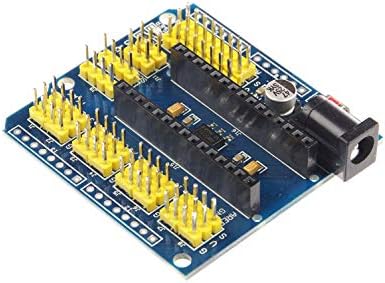

Looks like 0.3A with the big LCD…Perfect no worries. I dropped it on a nano shield I had from the otto bots makes it real easy to wire up.
