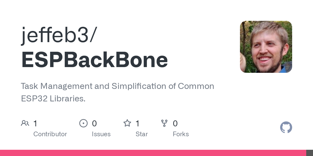

If you want to try this helper library I made, let me know. I found it useful, but AFAIK, no one has tried it.

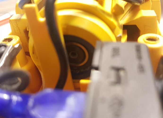

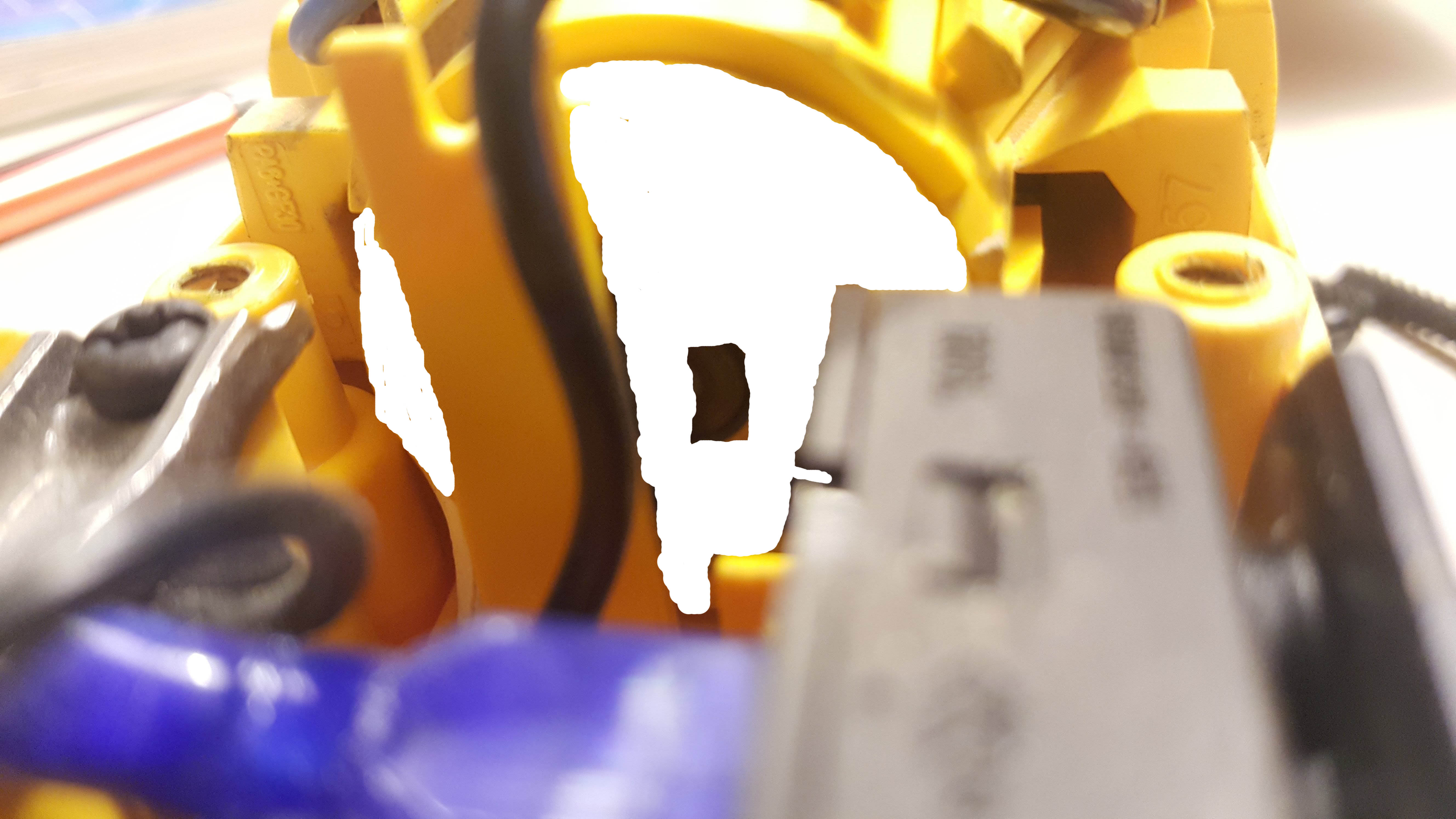

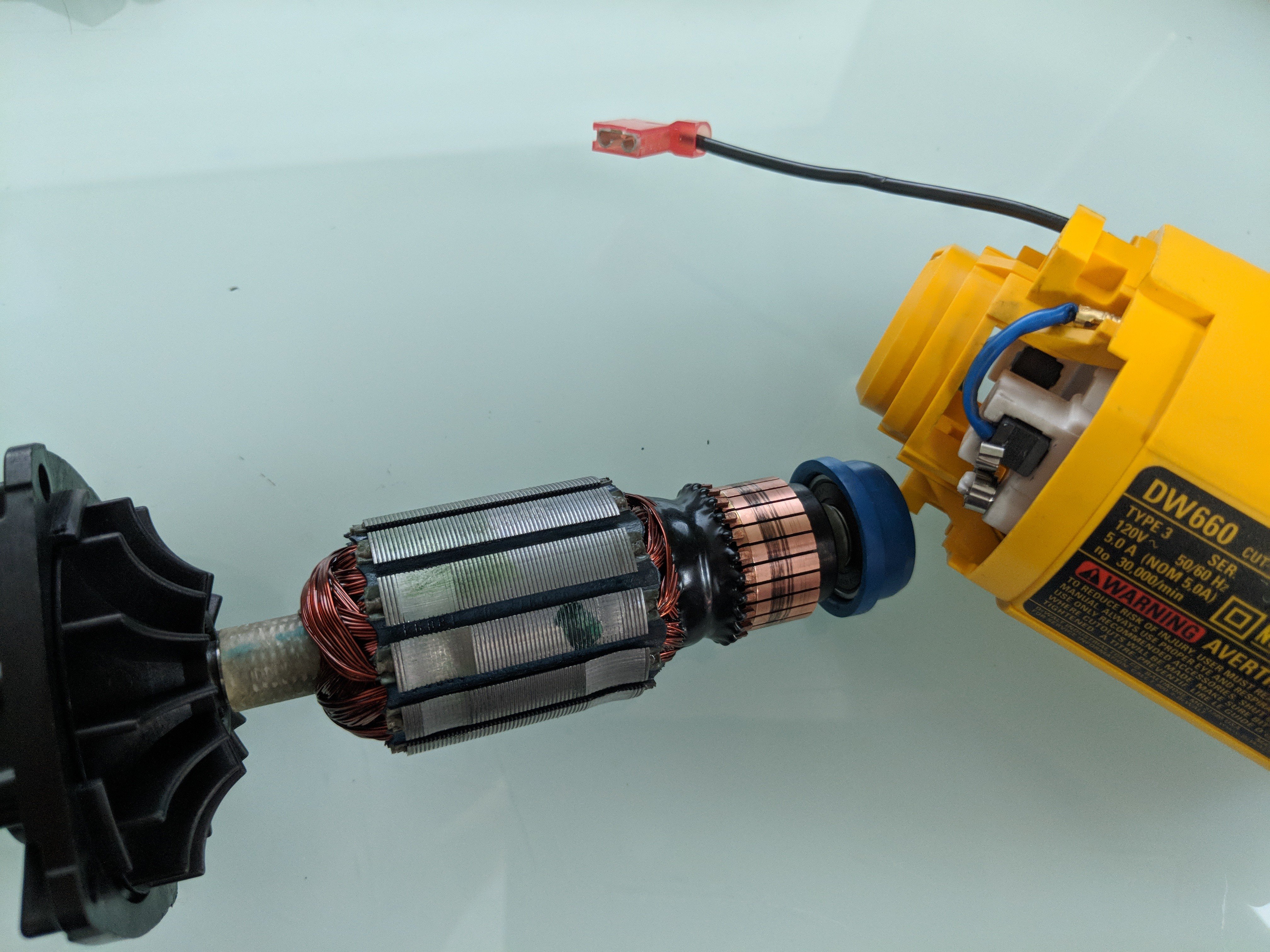

I’ll have to take mine apart and look. I didn’t think it was a DC motor. I would think it would have circuitry for the soft-start but I’m pretty sure the motor is AC.
Pretty sure it is just a switch and brushes unless they have something really hidden in there.

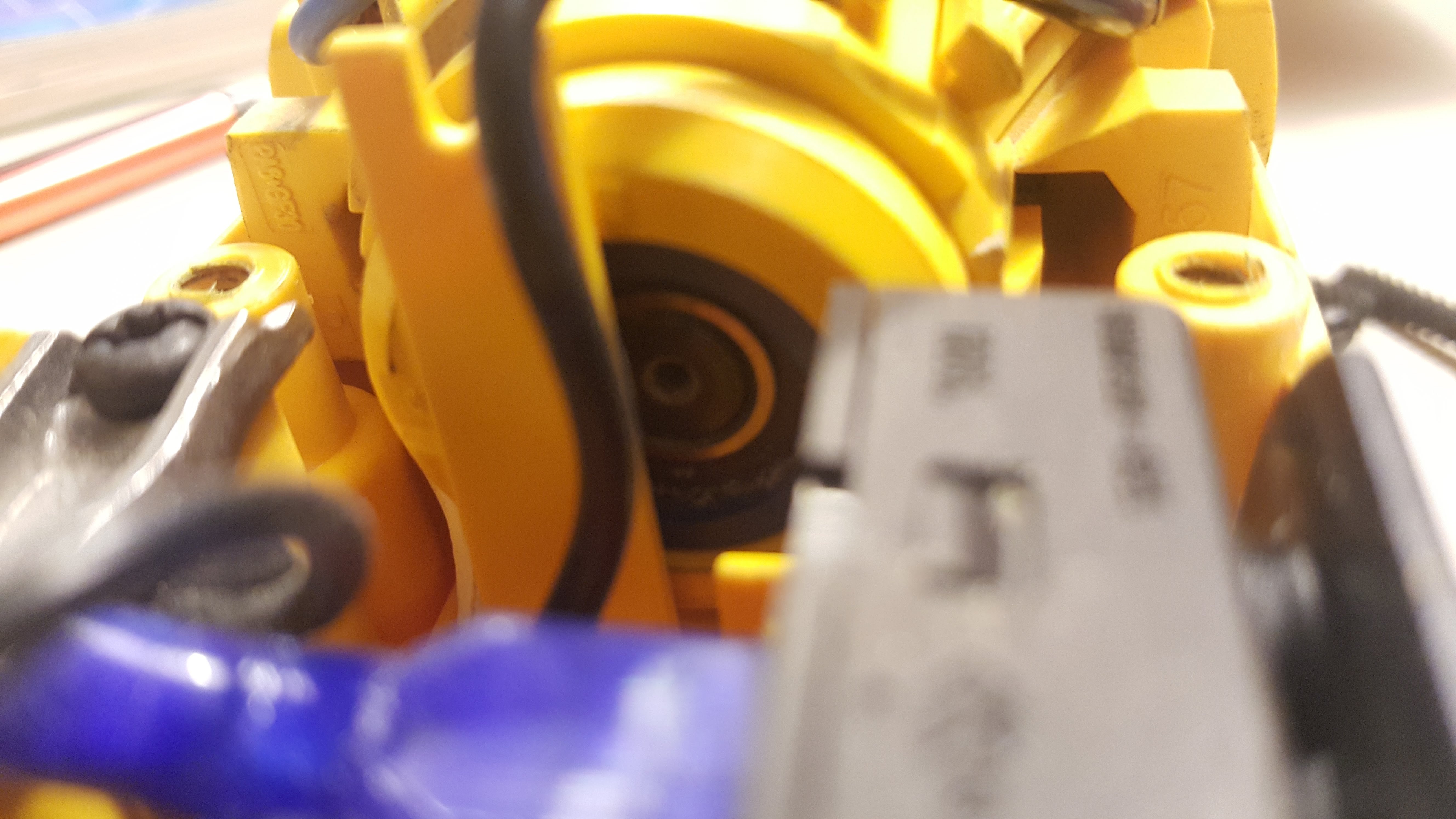

I’ve been viewing this thread a lot. It’s interesting stuff. Is it not possible to strap a today encoder to the side of the router? Or maybe mount the shaft directly to the top of the fan? They seem to be pretty well sealed units which would eliminate any dust getting in. I guess price could be an issue again though
I think the fan is possible, I am just concerned with regular dust build up on the “optics”. I am going to put a hand full of sensors and resistors in the shop so anyone who wants to check it out can without buying a bunch of them. Nano’s and AC dimmers are ordered but not available yet.
Placement does seem to be fairly distance sensitive to get a really strong signal but a week signal is really easy from any distance and angle. It comes down to how well the rising and falling part of the arduino sketch picks it up.

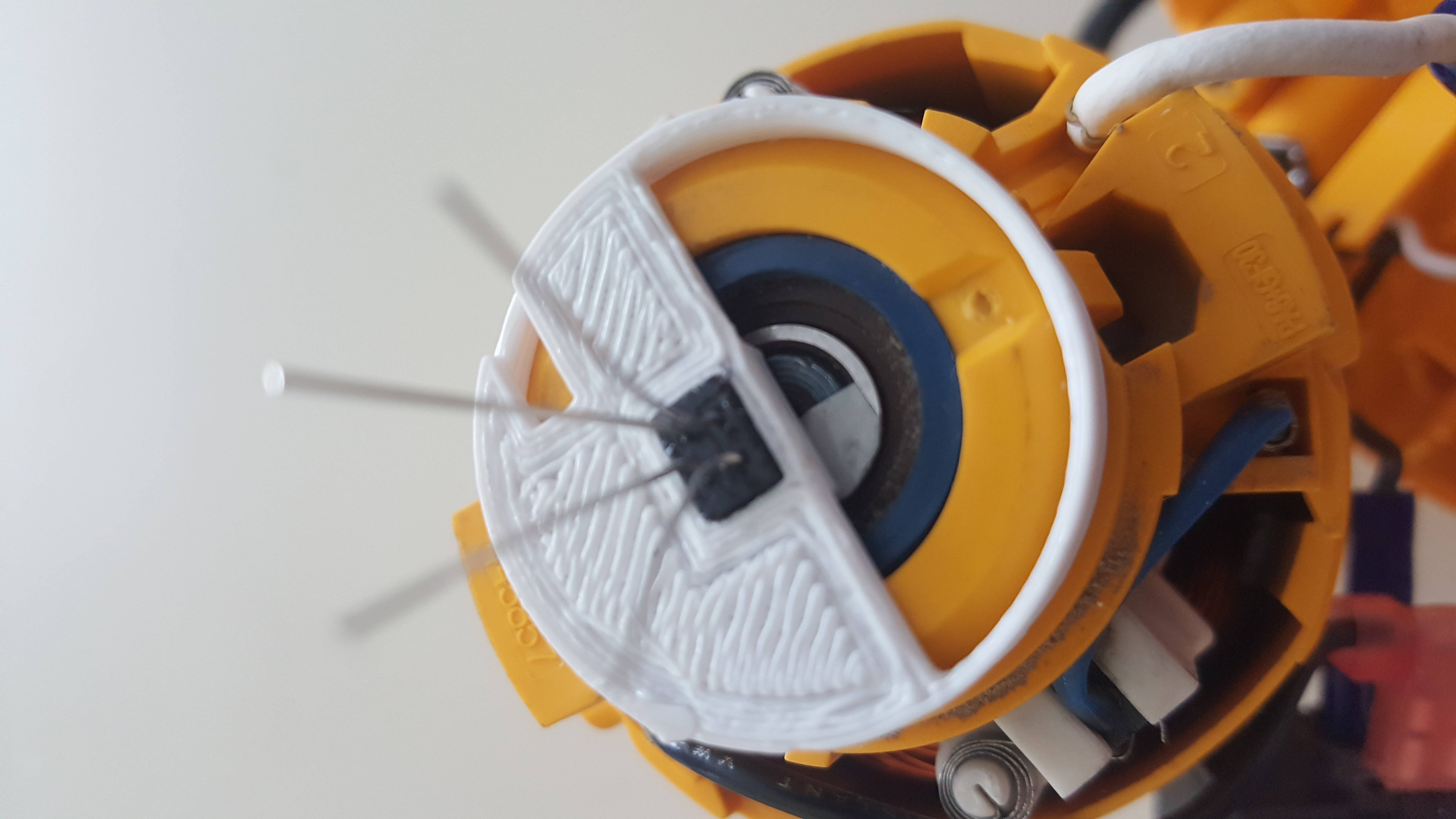

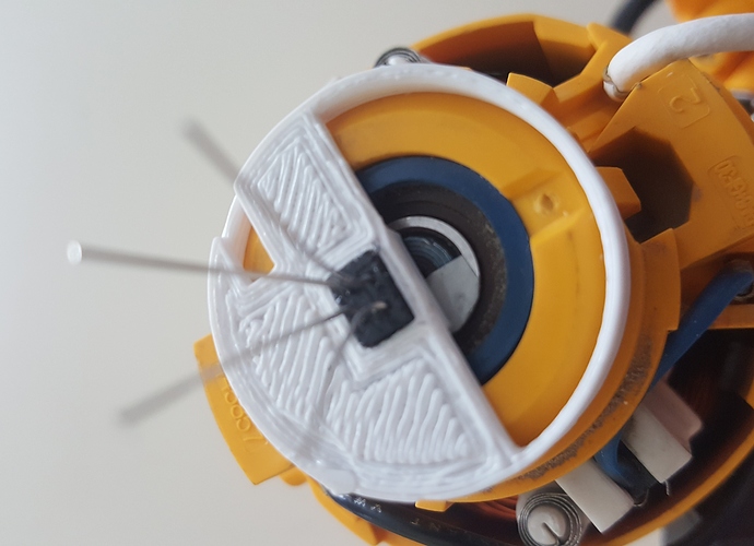

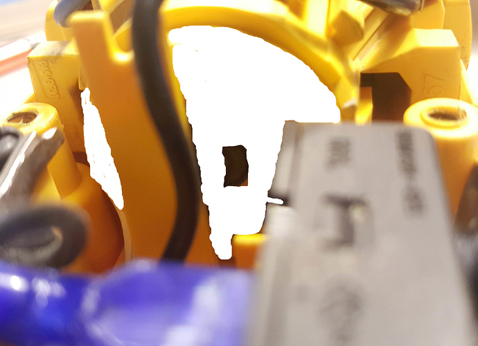

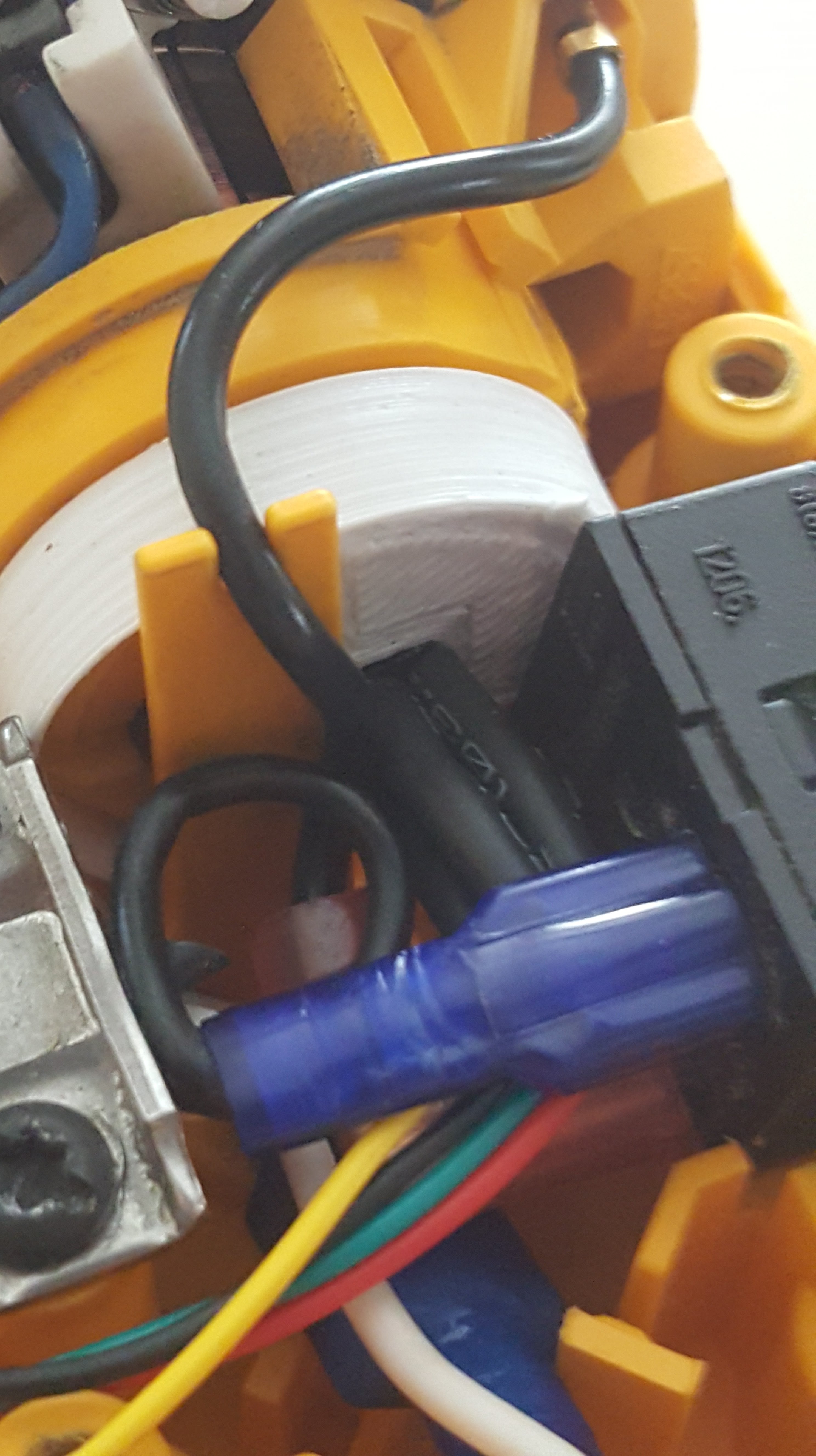

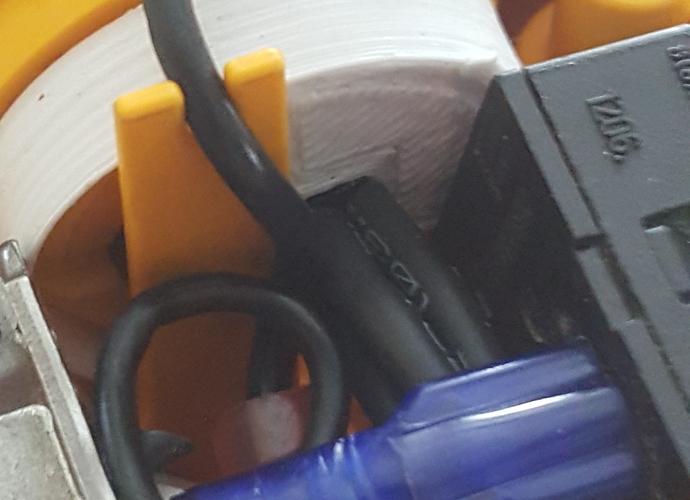

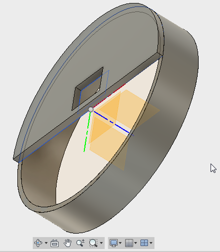

How about a cap like this over the end of the spindle
[attachment file=59388]
[attachment file=59387]
Tried printing this one but I think I need a better set of calipers to get the size correct.
Yeah that would work, but that is a bearing so liquid glue is a no go, and I am not sure how hot that shaft gets. Todd sent over some reflective material to try as well.
I believe that it would not need glue. Looks like I can get a nice snog fit around the molded case that hold the bearing.
Shaft heat should not be a problem, the only thing going on the shaft would be the reflective material.
I am trying not to make any changes to the case so I can use my tree year extended warranty if it burns up.
[attachment file=59413]
Oh, I understand, to hold the sensor. Actually that is better than what I was thinking about, Nice.
Need to wire it up and take it for spin.
[attachment file=59475]
[attachment file=59478]
Perfect. I was messing with orientation as well, you mount would make that so much easier. I use the larger resistor for the LED to dim it a bit, seems to give a better signal bit try them both.
