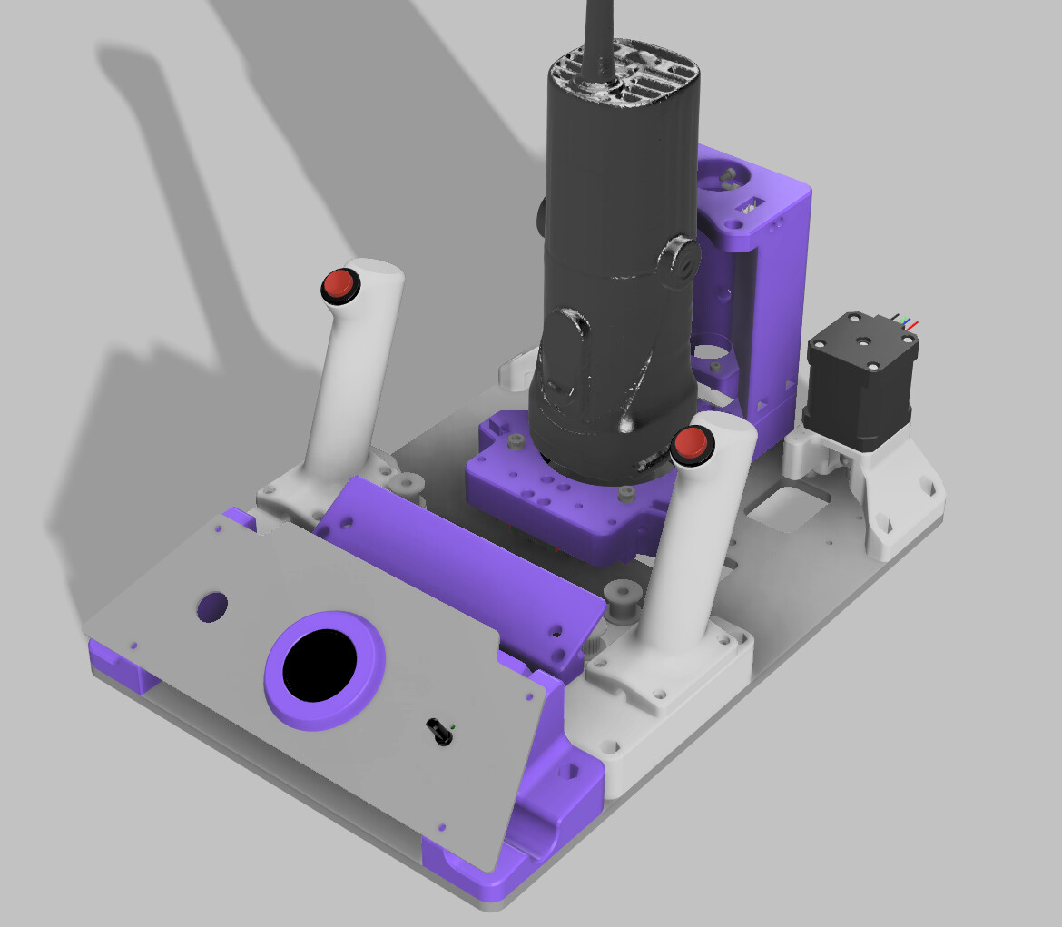

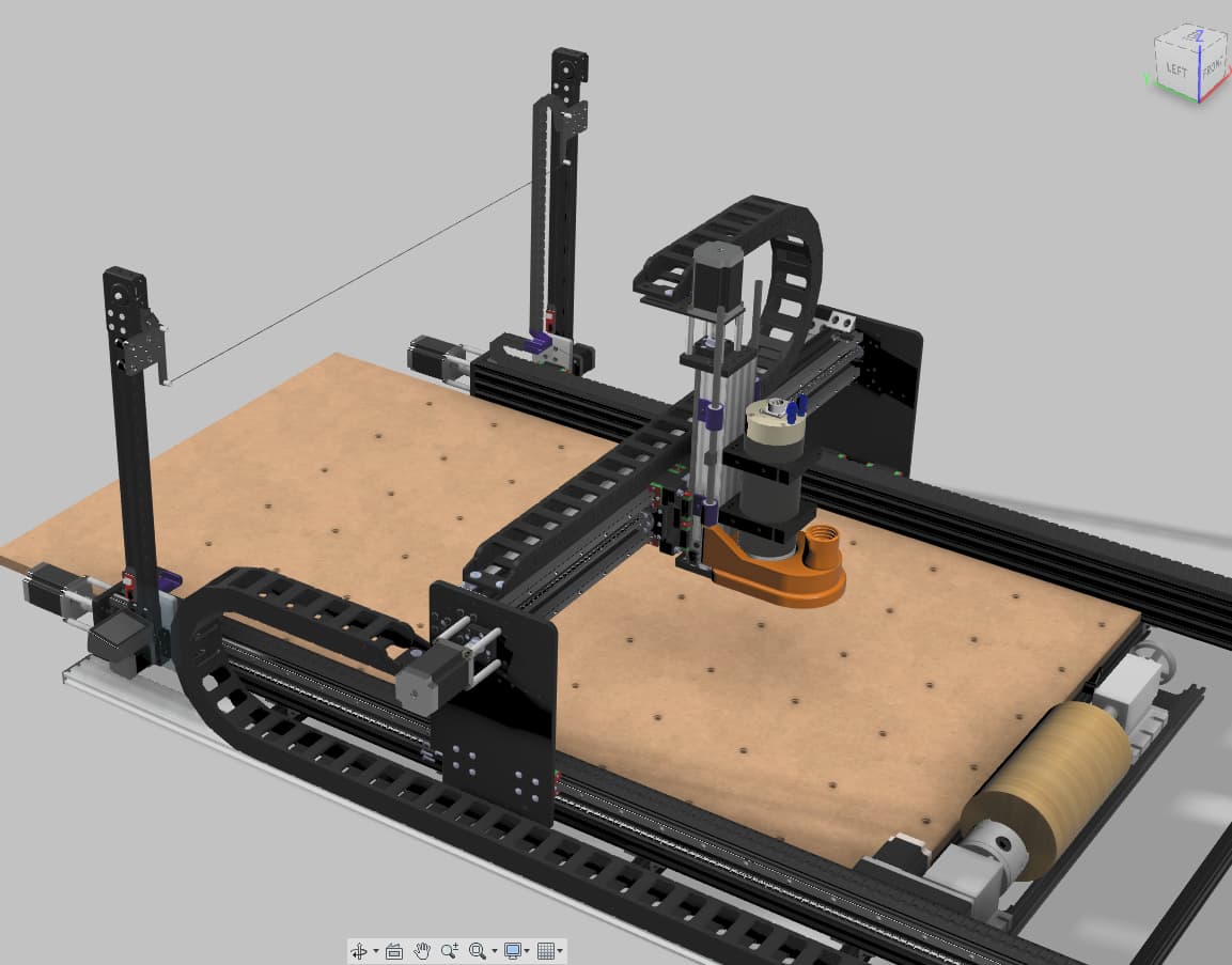

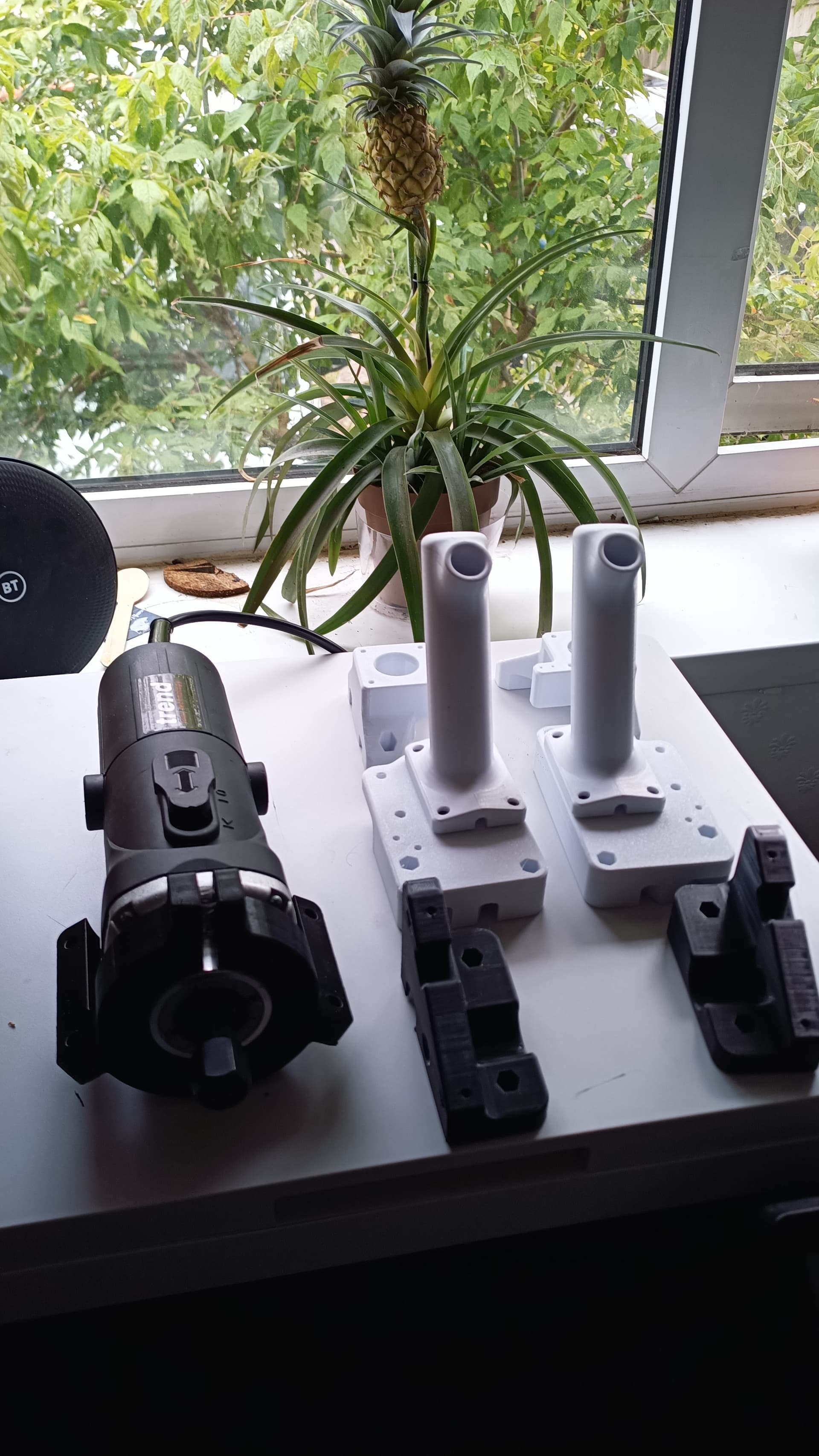

I like documenting my builds so thought I’d give that a go here, won’t be a blow by blow just the highlights :slight_smile: starting off with an excellent reason to use the 3D scanner to get a mount made for my 43mm collar router. I do have an idea to make this fully cordless with a ryobi router and making a power feed from the battery, haven’t figured that bit out yet. it’ll probably be a 3d printed insert for the tool and a battery mount on the unit somewhere as team green has daft battery designs.

I’m excited to watch as well, but I recall seeing TeachingTech’s youtube video where he started with a Ryobi cordless router on his lowrider and changed it out for a corded one pretty quickly as the battery life didn’t seem to last long enough for his projects. I don’t want to throw a wet blanket when you’re just getting started, but it might be worth reviewing this video to see if you want to continue down that road. It’s a few years old and based on the Lowrider 2, but I don’t know that the battery life for the router will have improved much in that time.
Hi! yes battery life is definitely a consideration, my idea was to have 2 of them (in parallel) behind the handles to centralise the weight. I have an UltimateBee 1015 with 2.2kw spindle for the big/heavy stuff (like base plates!) and there’s nothing to say I can’t have a tethered option that drives the router in lieu of the batteries. It’s all just musings at the moment, going to get the standard one built and mod from there.

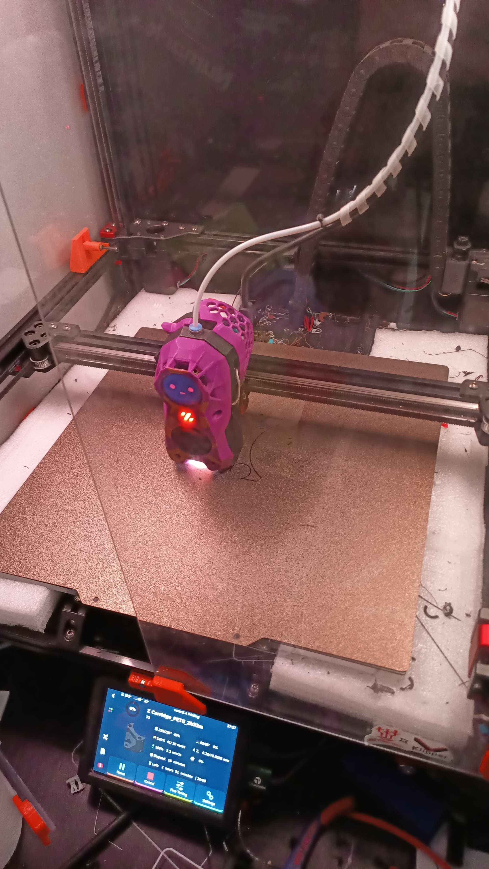

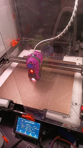

Update wise the mount for my trend router is all cadded up and printed and Mr Voron has been chugging away happily, even the ERCF is playing ball today!

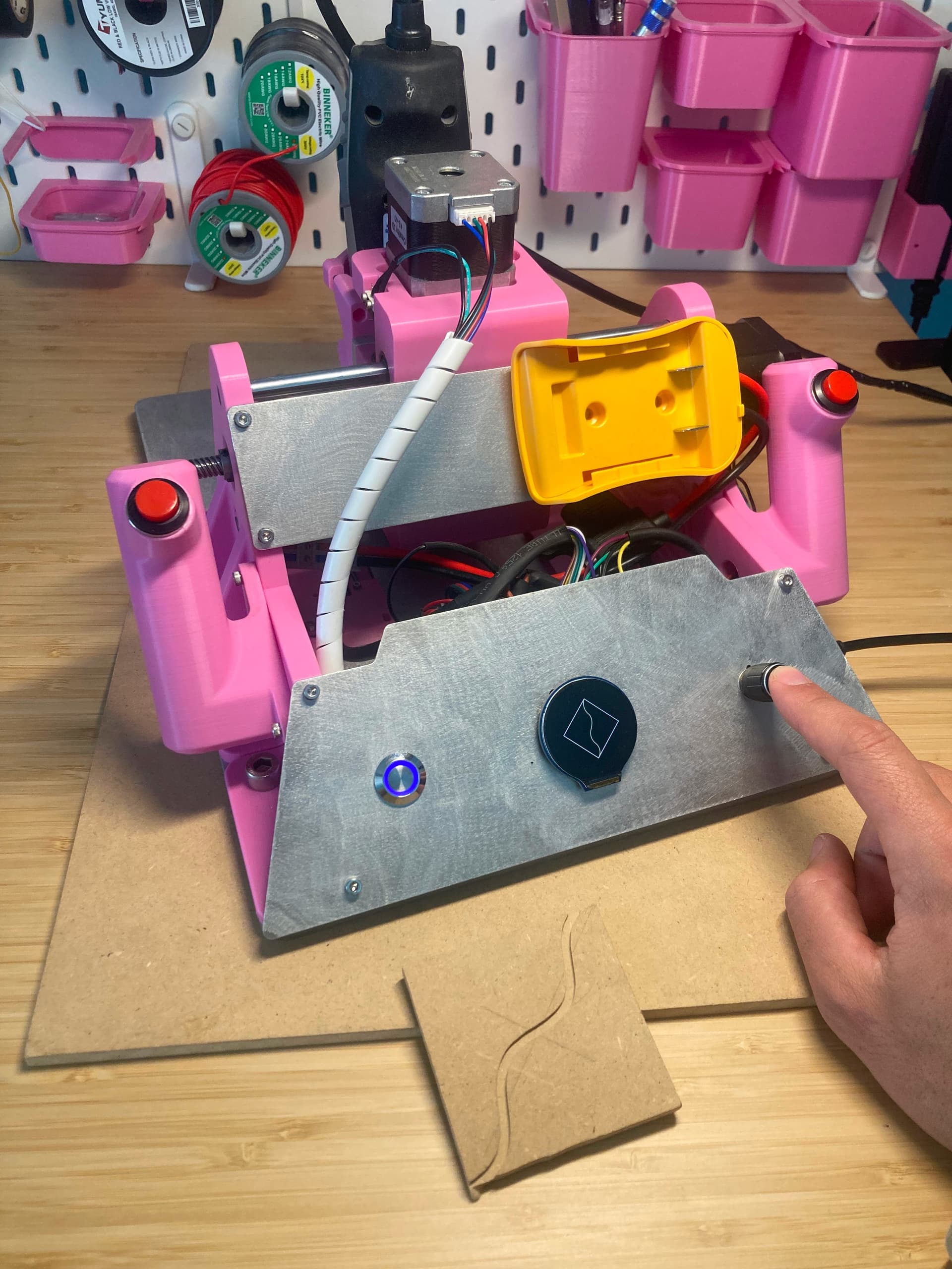

Sweeet!! I love to see it. The idea of having a fully cordless machine is indeed pretty sweet. I used a battery adapter on one my earlier prototypes (this is the link if you’re interested: Amazon.com: 2 Packs Power Wheel Adapter for Dewalt 20V Battery Adapter Power Wheel Battery Converter Kit with Fuses & Wire Terminals, 12AWG Wire, Power Connector for DIY Rc Car Toys, Robotics and Rc Truck : Tools & Home Improvement). I didn’t test it extensively because I generally just preferred the security of cabled power adapter and not having to worry about battery life. This is what that setup looked like:

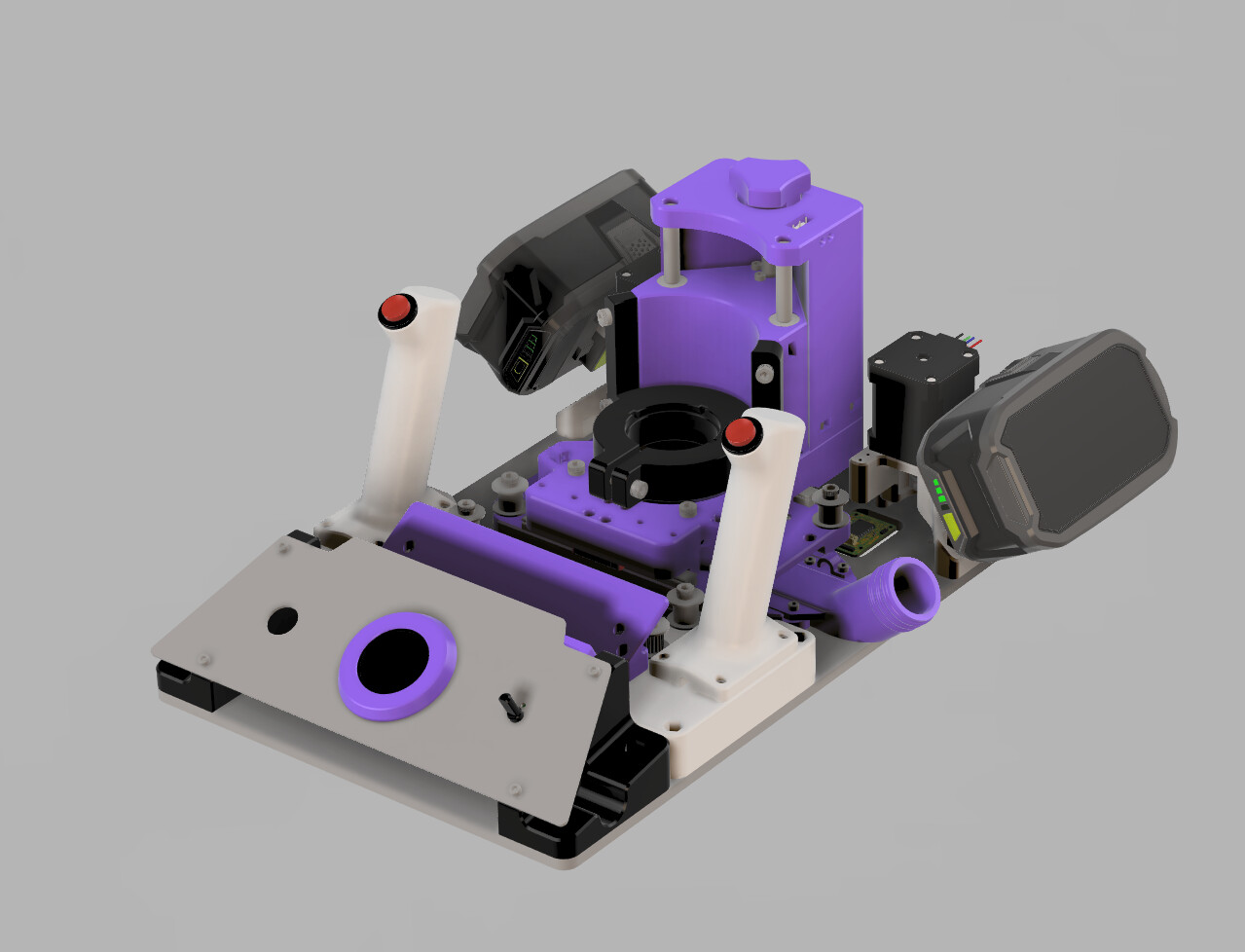

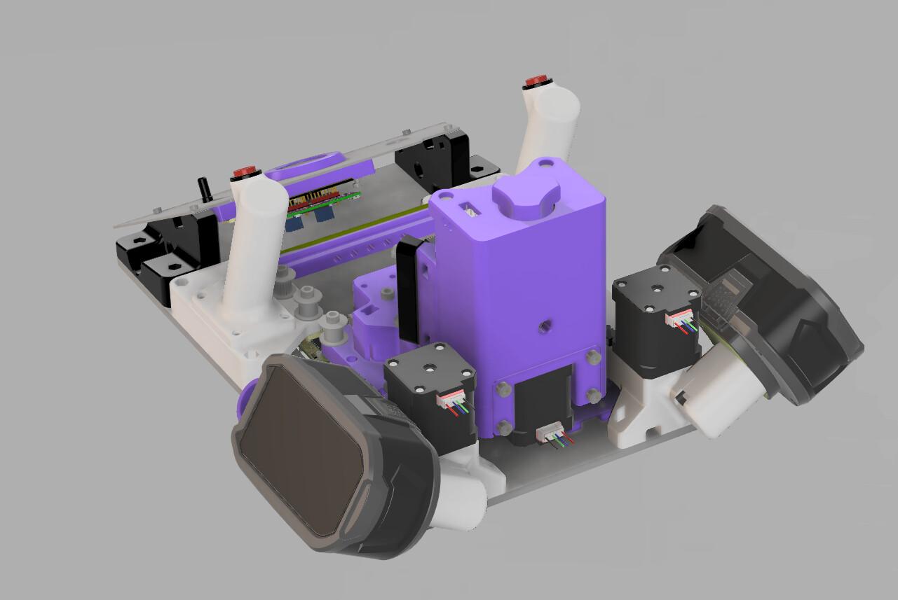

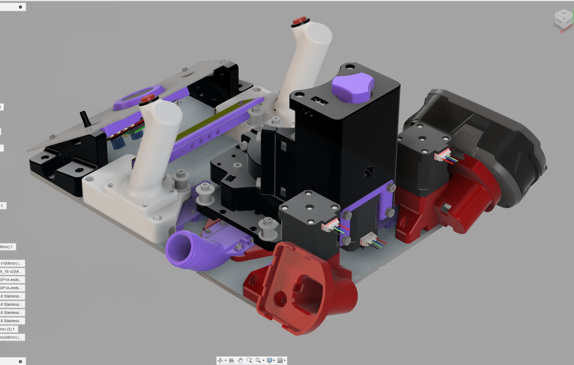

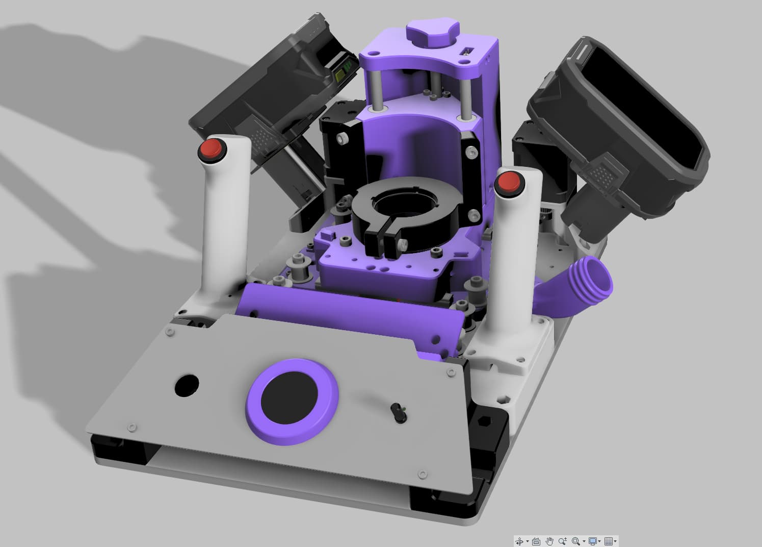

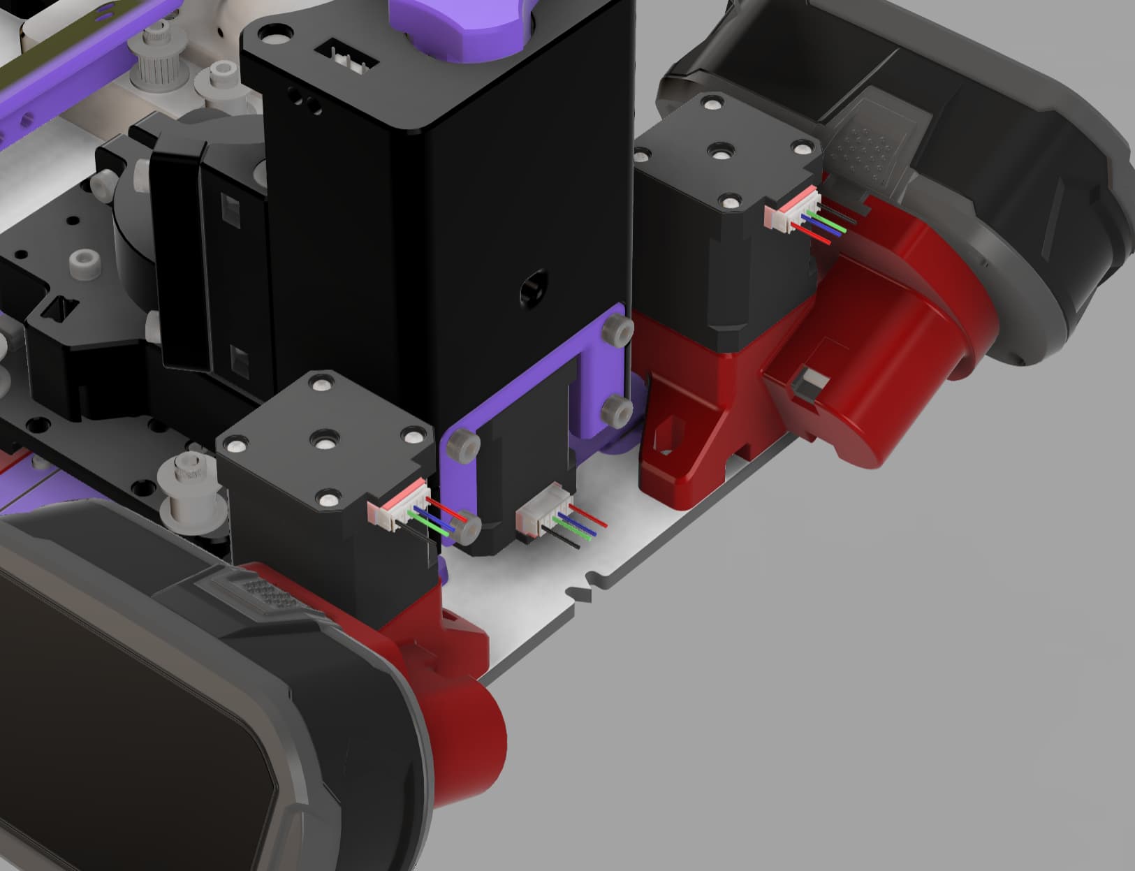

I’m not hating positioning 2 batteries here, keeps the weigh low and gives it a bit of a startrekky vibe. the battery clips are also unobtrusive if it’s running tethered with the mains router. test print incoming!

I’d probably plan to use a separate battery for the motion platform than the router, personally, so you can easily hot-swap the battery if needed, but beyond that I wouldn’t worry. I also would advise against having 2 batteries in parallel without some careful consideration, connecting a pair of lithium ion packs that are at different states of charge or even the same state of charge but different temperatures can result in some VERY gnarly currents. Even most of the power tools that use dual batteries do it by having them in series or by fully discharging one battery and then electrically swapping to the next.
In the RC world you can get high current mosfet balancers for running Lipos in parallel and I planned to squirrel one of those away somewhere to prevent slight differences causing damage and safely allowing hotswap.
Not this one exactly but gives you jist of what they do: Amazon.co.uk

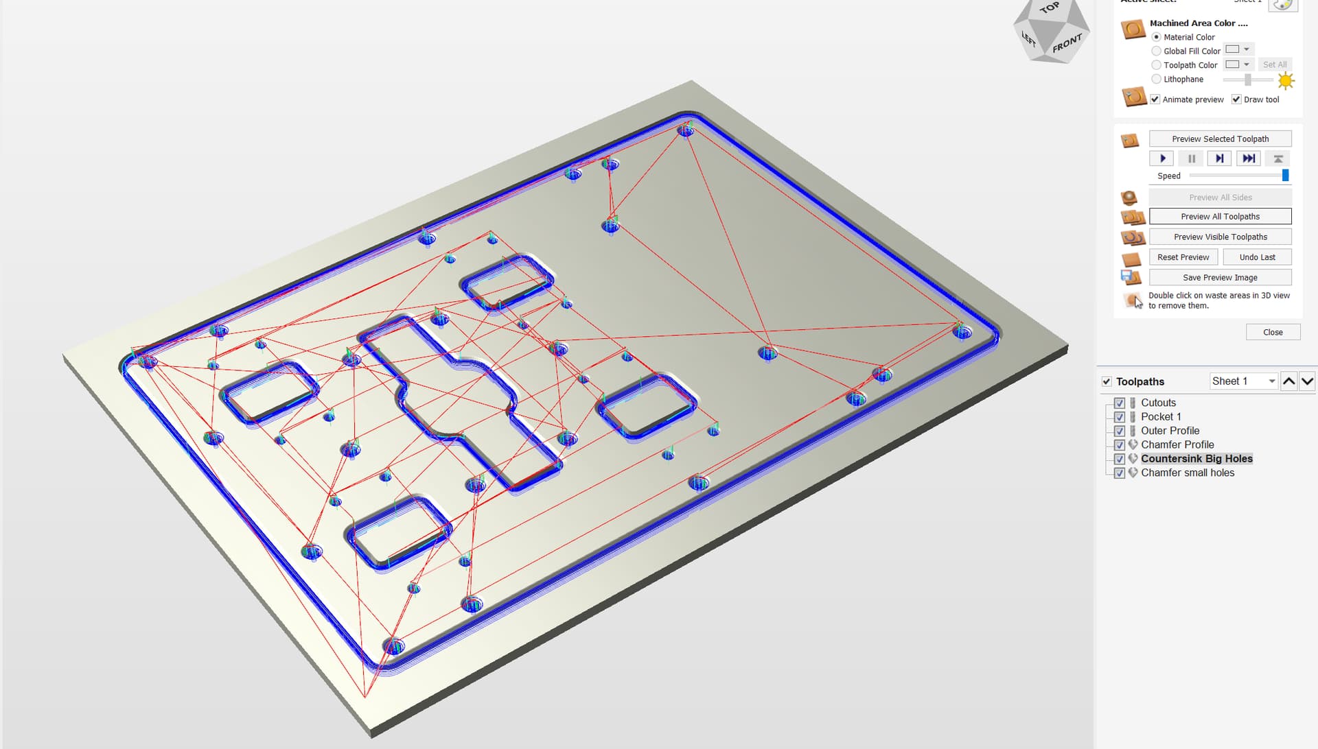

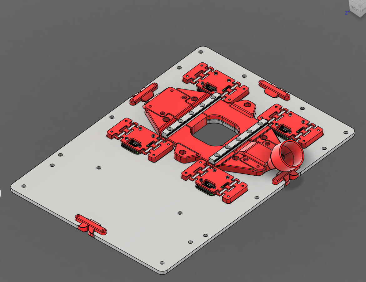

Getting the tool pathing done for the baseplate this evening, an excellent excuse to finally get that 90deg Vbit I’ve been forgetting to buy for months.

FYI I did also just push a new baseplate design. It’s pretty much the exact same, only with notches on all four sides to help line up the center. I had been meaning to add those for a while but got caught up with other stuff. Silly really—tiny little change. I didn’t realize people would be so fast to get building! I thought I’d have more time to procrastinate hahah.

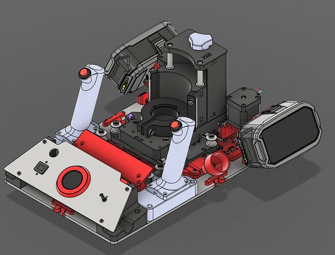

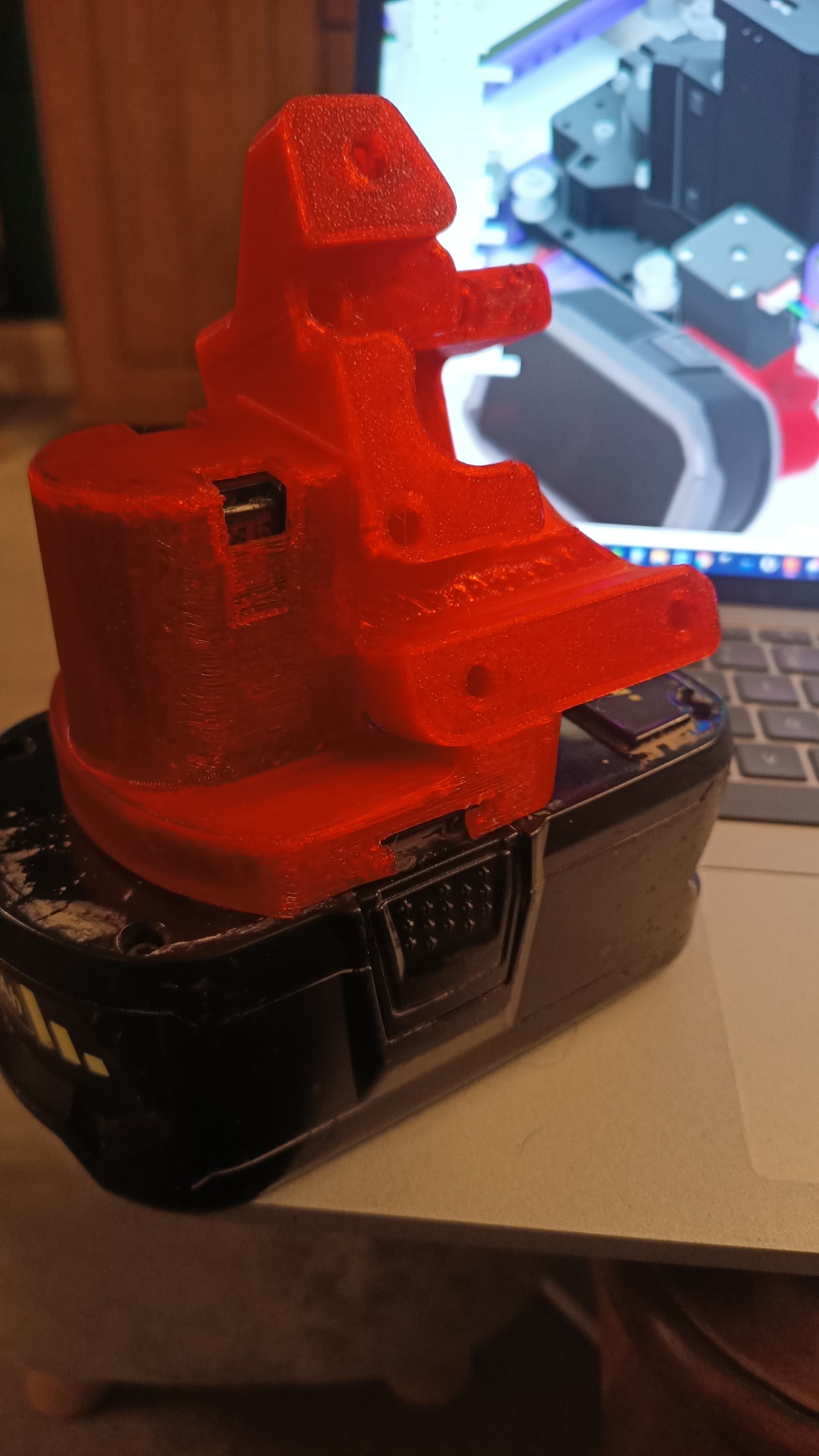

Bit of R&D today, I was hoping to get away without clipping the batteries in but it was too sketchy so I spent most of my spare time getting a nice snug set of clips dialled in.
For anyone wondering about the colour scheme I like to call it “end of spool chic”.
Battery clips done, pretty happy with how they’ve come out with draft settings, should be really clean with some variable layer height and a PLA support interface.
Also made the notches into arrows for a cleaner point when cnc milling the base plate.
Awesome! The battery mounts look great.
The one concern I have with this design is snagging on the material… It seems like that spike is asking to dig right into your workpiece. Idk maybe if you chamfered the bottom side a good bit…?
good call :slight_smile: I’m currently toying with a removable 3dp plate for the center indicators, might want to attach it to a guide rail or something in the future, need to re-kerjigger the dust extractor but I’m liking how the idea is coming together so far :slight_smile:

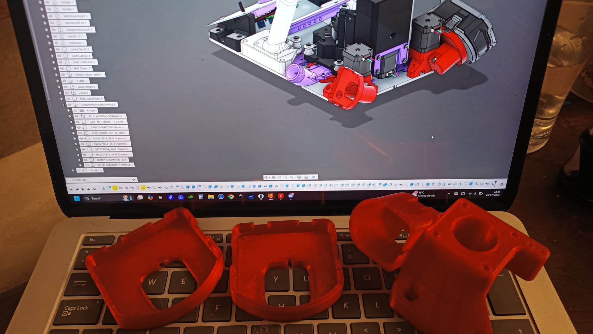

Been playing with a few bits in CAD, a longer travel spring and changable locator notches.
