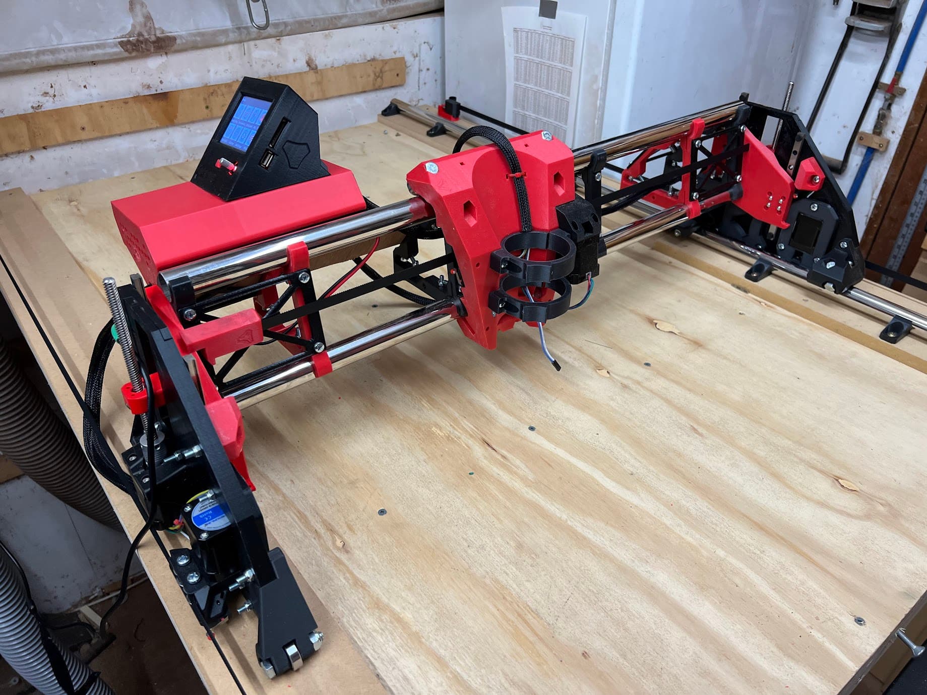

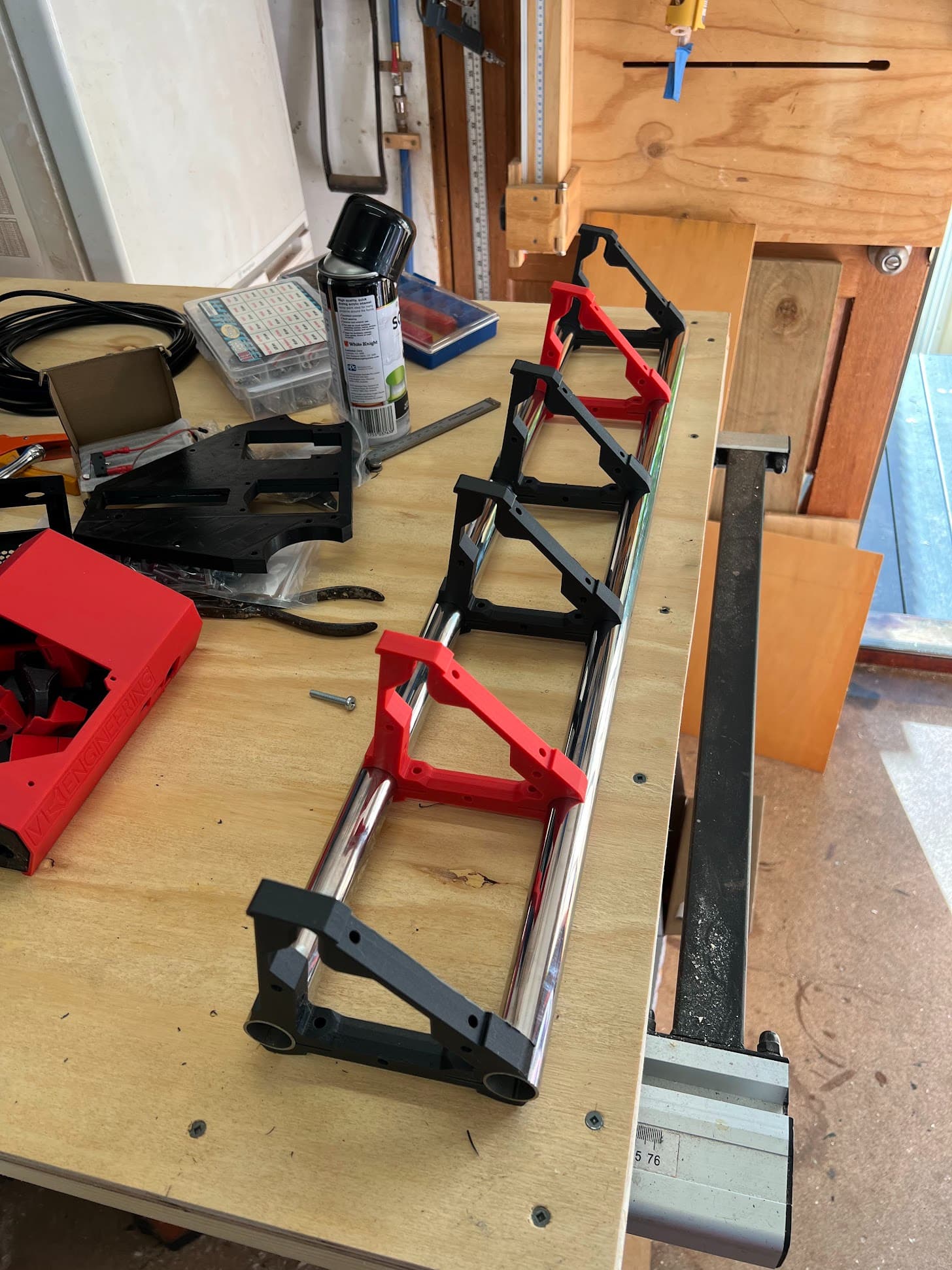

Making some good progress, the beam is done, using some bargain 304 Stainless steel tube I found locally. $15 for 6 meters. I think they must have made a mistake with the pricing on their website.
Got my side plates attached to the beam, found that a sharpie wedged in the gap held it at just the right height to get my screws tightened.

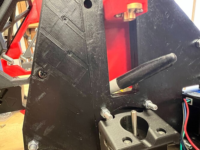

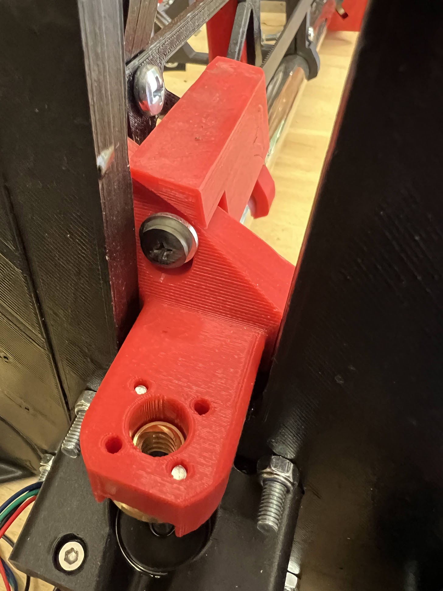

I did have a strange issue with my printed left side XZ plate. The hole for the belt tensioner was a complete through hole that the head of the bolt went straight through. This made me realise that my left XZ plate was a lot thinner that my right plate. Seems I must have not had the plate seated correctly on the build plate when I sliced it in cura. Stupid mistake. I will re-print this part when i get some more red pla, for now I managed to make it work with a washer and a ground down bolt head so it clears the side plate. I will be 5mm shorter on the X axis util I print the proper left side XZ plate.

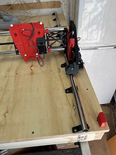

I got my y rail down, and was feeling like I was getting close. Then realised I meant to put the rail on top of strips of MDF the same thickness as the spoil board I am going to use. It will give me a chance to use my pulleys to lift the table out the way to reveal my table saw to cut the MDF strips.

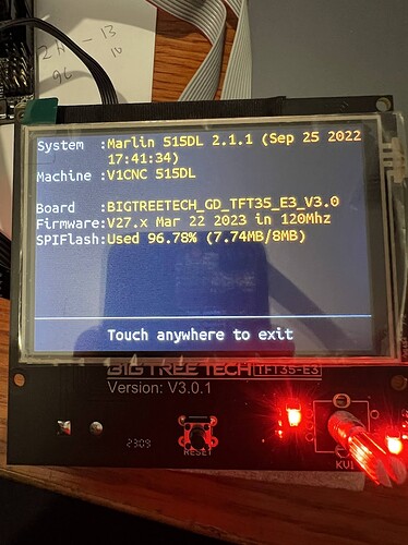

My electronics are all flashed and ready to go.
I also added a dirt cheap ESP01 with ESP3D on it. That is very nice simple solution to get WIFI access to the machine. Pretty slick.

Looking pretty close now. My Z axis did have some binding issues especially the higher up it was. I am 95% sure this is due to the wrong linear guides and my alignment of the leadscrews with the couple/stepper not being spot on. I have ordered some of the correct linear guides and made some reprinted inserts to use while I wait and got it working better if I stay in the bottom half of available Z travel. Probably enough to keep going while I wait on the proper ones.
Using ESP3D on my phone while moving it around is SO much easier than using the touch screen… I can have my face buried right down on the bed looking at stuff while moving it around.

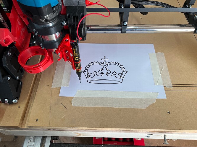

Lots more progress. Created the obligatory crown plot. Thanks to @DougJoseph for the simple quick change pen holder, made this work great. Will most likely end up printing/building his kinematic version, but was impatient and didn’t want to wait for magnets to get delivered.

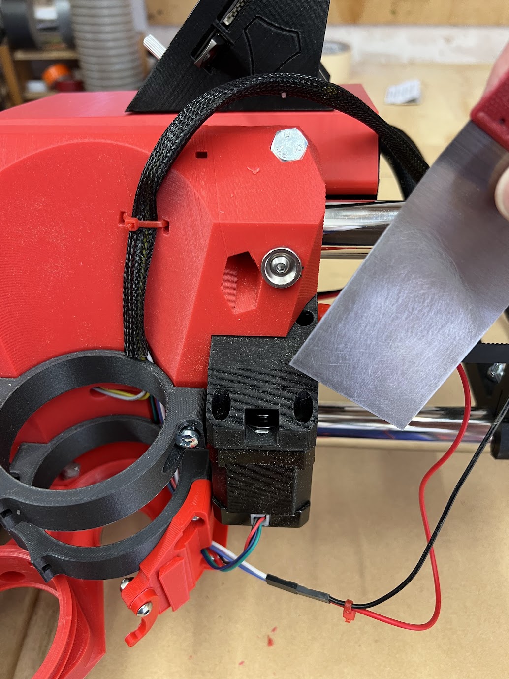

I built a very simple touch plate using a cheap paint scraper I had lying around. It didn’t accept solder very well, but a simple m3 bolt seems to be holding the wires OK. Added a magnet to the core to hold this and tuck the alligator clip out the way. Seems to work well.

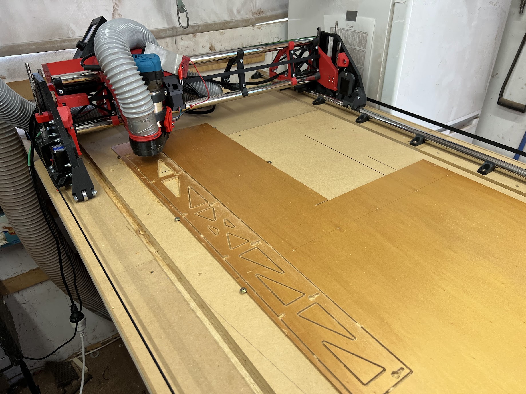

Managed to cut out a test strut on some crappy old plywood. Worked pretty well, the back of my sacrificial bed must be a bit higher than the front. This caused a few of the back pieces to break the holding tabs. I have a surfacing bit on order so hopefully that will fix that. I have purchased some 6mm MDF for the real struts, and will make sure to use thicker holding tabs.
