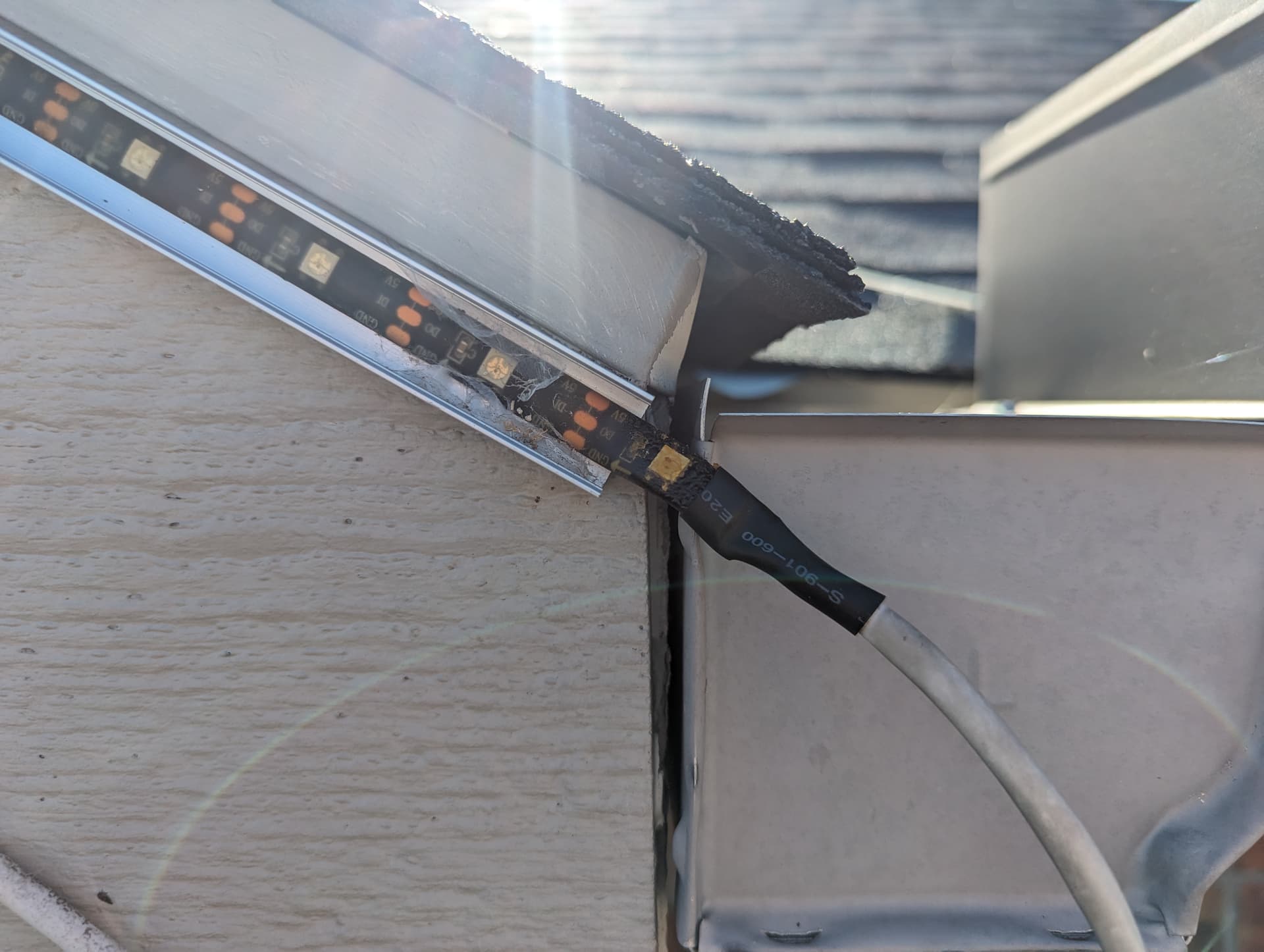

I have another dead pixel in the same spot that I’ve repaired twice. My repair doesn’t live through the seasons, I guess.
Is it just water damage or unknown cause? If you can muster the smell while curing liquid electrical tape is great in all the “water electrical” senecios I’ve been in.
Could it be a power issue? Is that where you are injecting power, possible overload?
It isn’t power. I can’t remember what I figured out last time but I remember thinking, “If that patch doesn’t hold, I’ll do something different next year”. But I can’t remember what I learned :smile:
I think the entire line is expanding and contracting, and the physical stretch is causing a break where I hand soldered in a new strip of one LED. I remember borrowing a ladder last year. I am probably going to buy one now so I can be sure it won’t be a problem again.
I’m going to prepare some new patches with a small amount of wire for some physical stretch protection.

Mine is breaking at a seam in the metal channel. I think it moves around in high wind and breaks the pixel that’s stuck right there.

I had to fix 3 bad pixels this year. One you could easily tell was water intrusion. Then there was this one again. And one more further down the line. The last one was close enough to the end that I just replaced the rest of them instead of patching one in.

Here’s a picture of one of the bad pixels.

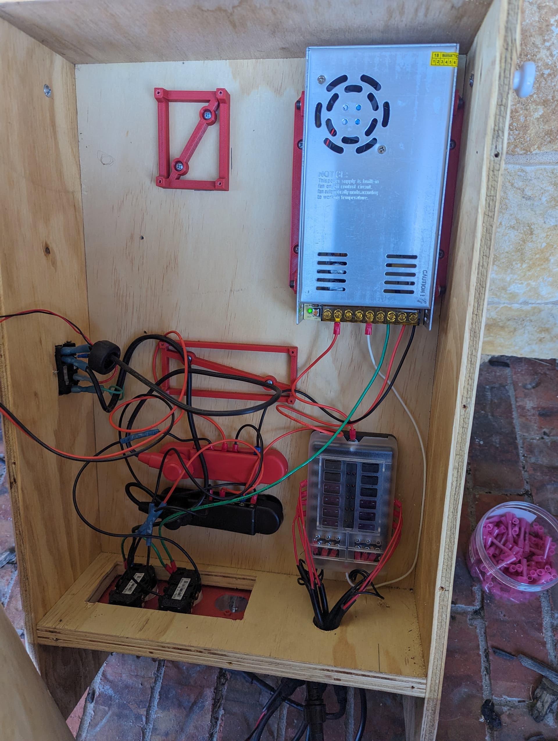

A fuse also went out in the power box I built for running all of the blow ups. I had to pull the cover off to replace the fuse. I really need to build a smaller power box for this. I originally intended on doing a lot more with the box and discovered it was better left as a single use box.

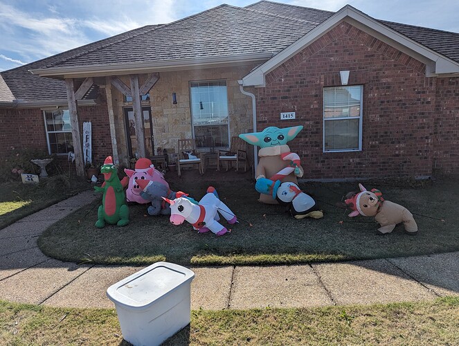

I’m only running 6 blow ups right now, but the PS has overhead to add more. Each blow runs around .5-.6 Amps. I want to put aircraft connectors on the side of the box for plugging in so I don’t have to reach under the box to try to do everything.
Speaking of blow ups… 3 of mine seem to be filling slower than they used to. I’m assuming the fans are slowly going out. Has anyone ever replaced one of these fans? I assume I need to get one that’s somewhat ‘waterproof’ and not just a cheapie like I’d use on a 3d printer.
That’s really helpful. I guess I should be thankful it is only this picel each year.
